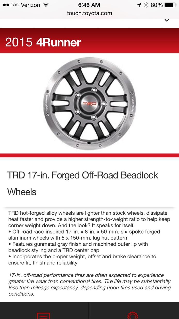

Here's a pic of the wheels I'm talking about:
The offset is about the same. Toyota OEM wheels pretty much always have a positive offset which is why spacers are so common. None of this is relevant though as those wheels will not fit because they are 16". Due to the size of the brakes the 5th gen T4R's require a minimum of a 17" wheel.
If you want TRD headlock style wheels, you'll have to switch over to these for the fit. I've seen these on a few newer 4Runners and they look great.

Pricey-yes, but worth the look and improvement.

Those are good and cheaper but made Cast Alloy where beadlock sim ones are Forged and thus nearly double in price.

I'm guessing forged = stronger??
Correct, stronger and have better heat dissipation. However for daily driving with normal habits and without large amount of lateral load (such as seen on trails traveling along side incline) any wheel would be sufficient. Just get what you like because you'll see them every day for as long as you'll own your rig, therefore price becomes almost irrelevant. G.L.
