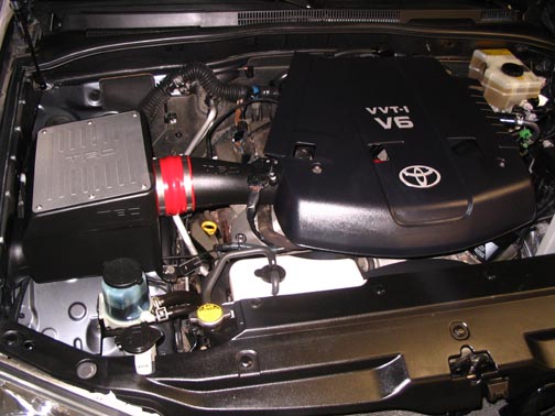

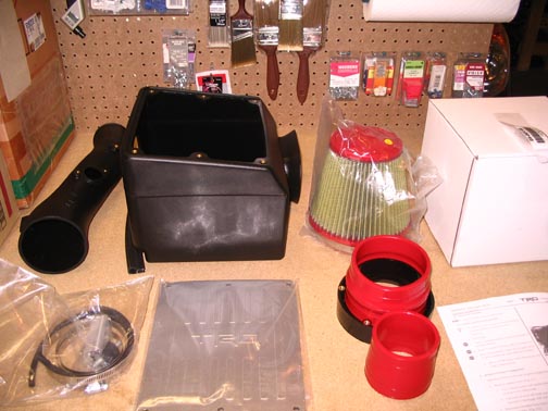

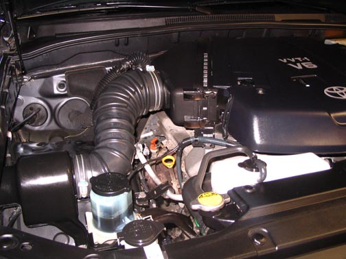

Overall pretty happy with the install...as you will see in the write up, I broke one thing and found that a few steps could be done differently for ease. The sound this thing produces at WOT is awesome!

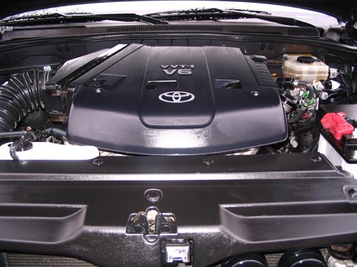

Before:

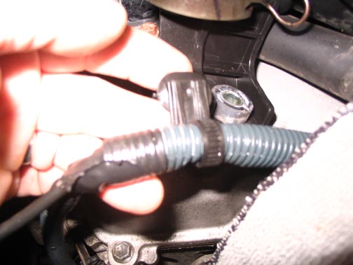

this clip was a bear to get out...you have to go under and squeeze the tabs to get it out...not easy

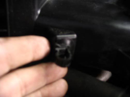

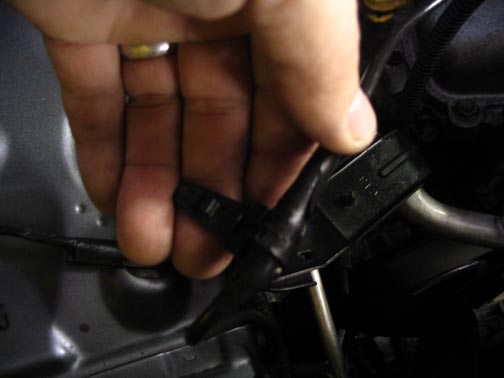

this clip was also a bear...its kinda like a zip tie...there is a clip that you can pry up with a tiny screwdriver then release the zip tie...

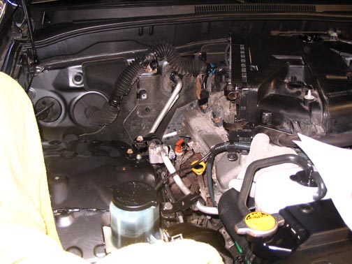

this clip just hangs after the OEM intake is removed...I just tucked it under the CAI.

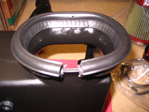

now, I dont know if this is by design or not, but I'm a bit disappointed in how this gasket went on and I'm not sure why it wouldnt go all the way around

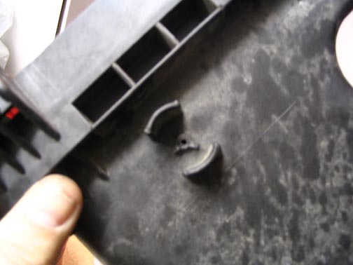

there is a tiny hose in the back that needs removed...well the plastic teet that its connected to broke right off...ugh

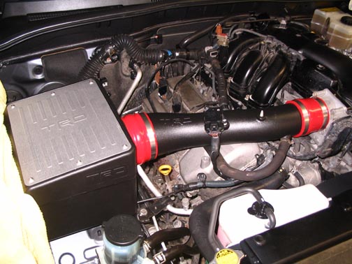

attaching the MAF to the new TRD tube also could have been done before installing the tube. it would have been a bit easier.
