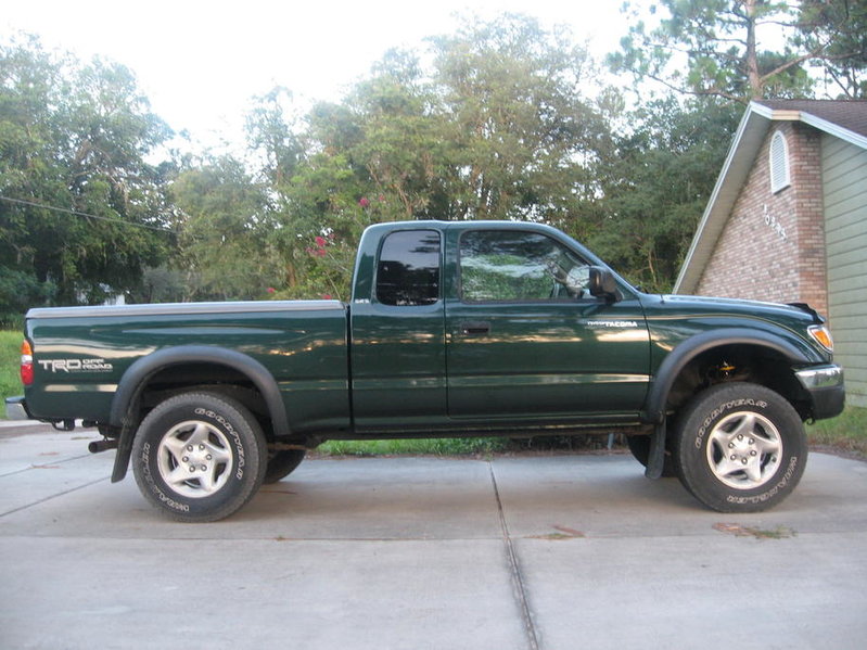

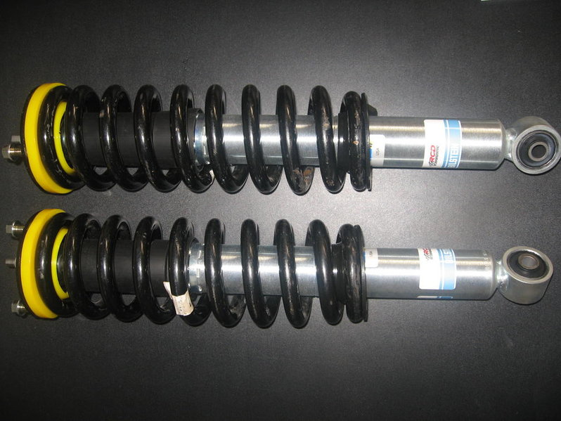

Awesome thread. Thanks for the details. Time for new shocks and springs on my '00 4Runner. Question for clarification. You have Tundra TRD Billstein 5100s in all corners, Tundra TRD Coils up front and Old Man Emu 906 from 4Runner in rear or are the 906 for the Tundra?
906 for a 4runner
If you go this route
get some 20mm levelers for the 906 OMEs in the rear. if your on the lowest 5100 perch using the TRD coils up front this will give you just enough rake.
Feels pretty solid with as much "wobble" you would expect from a lifted truck. Never feels unstable though.
What do you mean when you say this? I am getting the same wobble with my worn out 200k suspension in the front end that if I don't have a death grip on the steering wheel I'll get bucked into the ditch. I guess I just thought new suspension should make it at the least, way stiff but also planted and sure footed.
Yea you get lift if thats what your asking.
Is the ride quality/comfort/stiffness comparable between the Tundra coils, stock 4Runner coils, and the 99 tall coils? How about when you preload the stock coils/99 talls on the 2nd or 3rd perch of the 5100s - how does that affect comfort/stiffness?
99 coils and tundra coils are oem stock coils. They are give a good road ride experience. The higher the perch the more stiff the coil will get. You usually want to stay on lowest perch and maybe one up at most.
IIRC, the fronts of either setup is pretty similar, its the rear of the OME suspension that people like to complain about (jarring, stiff, etc).
So yea..
I've seen a lot of guys go Tundra TRD on the front, 906 in rear, 5100 all the way around. If the 906 is the biggest complain about the OME set-up, why is it so commonly used for guys who want less stiff, more comfort? And if the OME front is not so bad, why are guys using the Tundra TRD so often, and not OME coils up front?
It seems 906 are VERY popular, even though often complained about (maybe really the complaints are for the OME shocks, not coils). Does anyone complain about OME 880/881? Personally, I've been leaning towards 880/906 with 5100. Are the Tundra TRD coils going to be that far superior to the 880 front, assuming 906 rear?

I saw in your sig that you went up to 890s. Was it purely for more lift? Was there anything unsatisfactory with the 906 rear? I have all my parts here and installing this weekend. I've been nervous that the 906 would not provide enough rake with the TRD front, but you and Speedy both indicated 1/2" rake, with which I'd be happy! Any drawbacks looking back?
I had no issues with the 906's. Paired with the 5100's I though it rode pretty dang good. Firm but not too stiff. I made the switch purely for more height. In my opinion is they ride pretty much the same with no noticeable differences.
When I made the change I also moved the front up one perch. My rationing behind the change was wanting to go with a bigger tire in the future. I was replacing ball joints and TRE's so I decide to go ahead and move the front up and bump up to the 890.
I have no regrets going with the TRD and 906's. For a mild setup it's pretty much perfect for daily driving.
That's great to hear! I've heard mainly positive things about the ride from this set-up, particularly for a DD. I've been most nervous about the stance, and whether it'd be negative, level, or slightly positive rake. I'm going to install it without rear trim packers and hope for that 1/2" positive rake. Glad it worked well for you!
