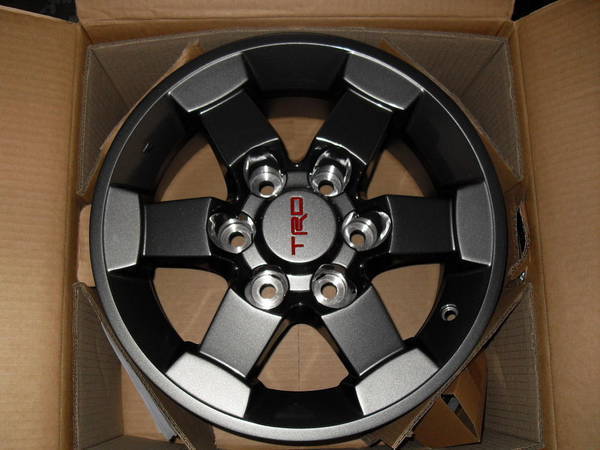

Anybody know if the TRD FJ wheels will work on a 03-08 4Runner? Kicking around the idea of a V8 4Runner with these wheels and 285's.
16 x 7.5
These:
Can't say for sure, BUT, I have the stock FJ wheels on my truck, so don't see why these wouldn't fit. However, I do believe that Sport 4runners require 17in wheels because of the bigger rotors and brakes.
16 x 7.5
These:
Depends what model you have. I tried to put my friends TRD rims on my limited and they didn't fit because of the larger brakes. If you have a sport or sr5 they will fit and they will look very good.
Yep, Simple is right. These rims, FJ TRD Trail Teams, are 16in and will fit fine on SR5's but willl not fit on the Sports bc of the rotors, etc. Good luck man, love the look of these rims!
Thanks everyone! I thought there might be some 4runners with bigger brakes. Guess I'll just wait and see what happens with my taco.
These rims are in high demand and nearly impossible to get, so if they don't fit I'm sure I can sell them...
Yep, still new in the box's. I was going to order new 285 bfg's for my Taco this week, but got into a little hail storm over the weekend...Don't know if insurance will fix or total.
