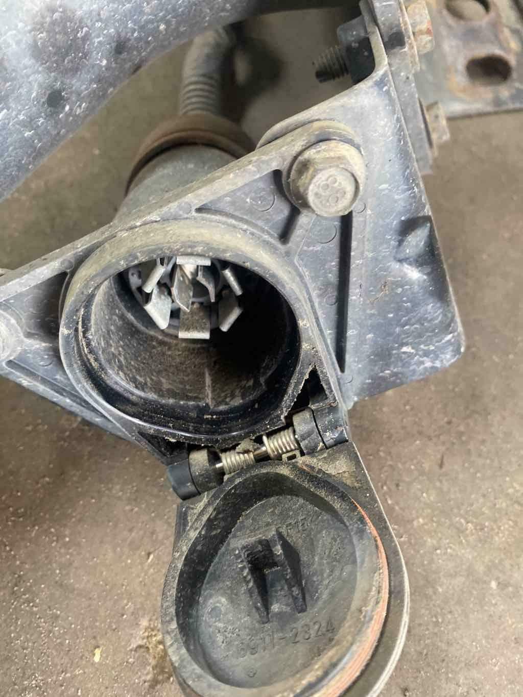

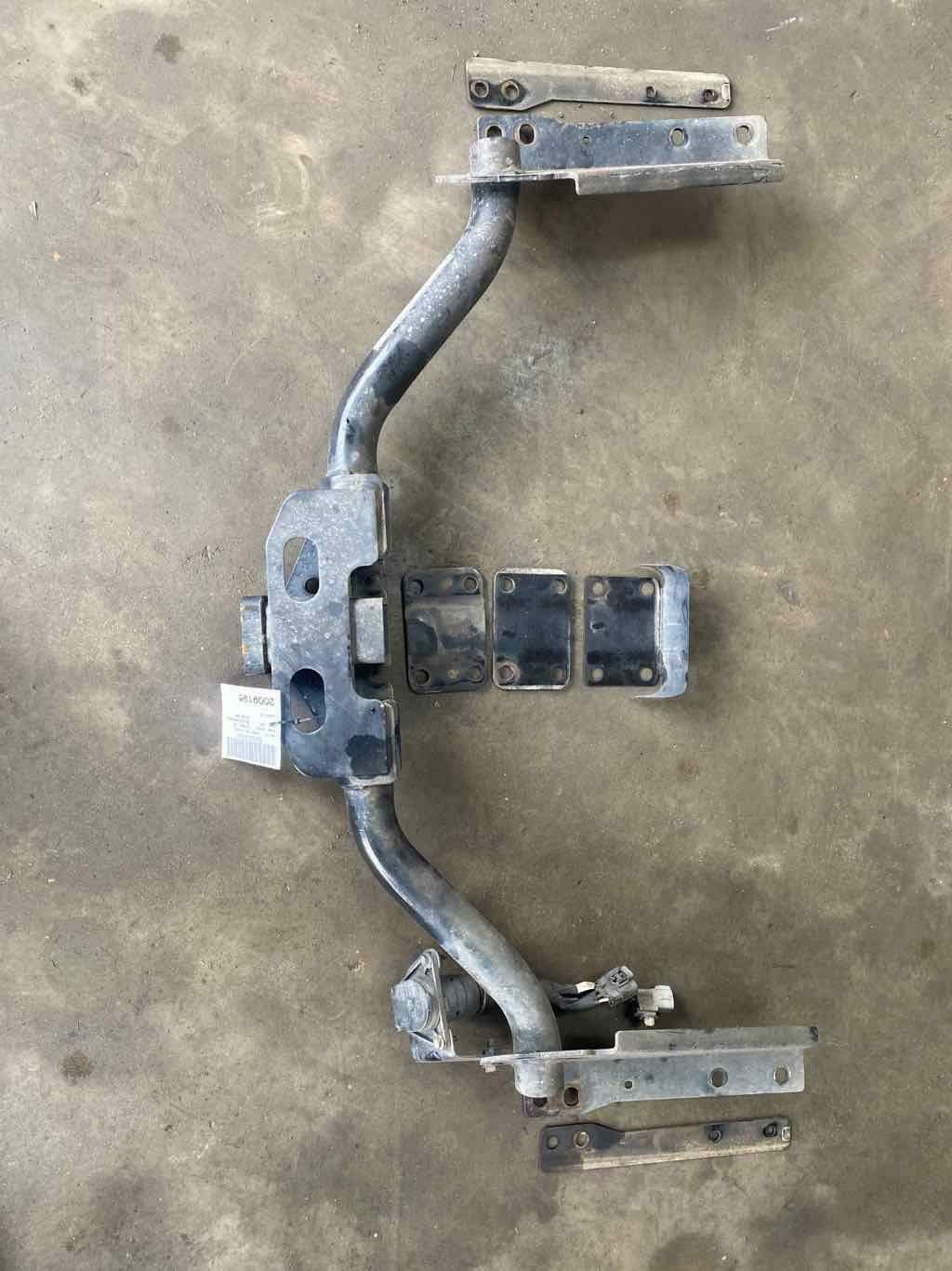

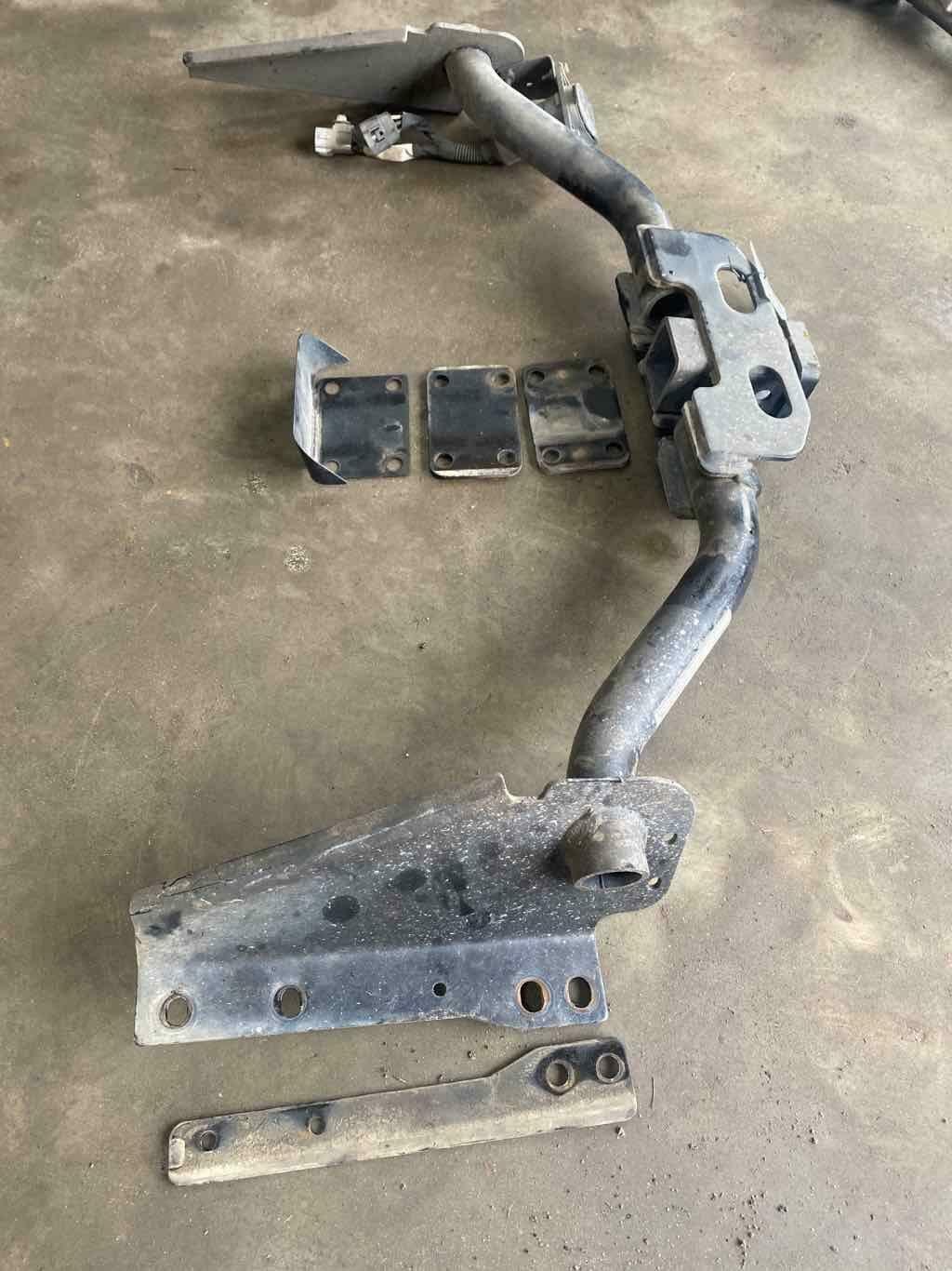

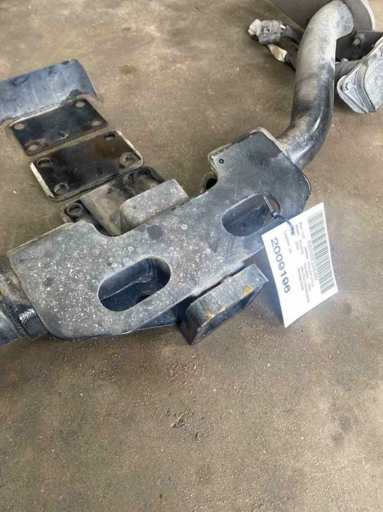

Hey 2nd Chance. I am working on replacing my limited rear bumper with OR/TRDP bumper and am curious about where these tow hitch brackets mount up. I don’t see them mentioned at all in the service manual for the rear bumper assembly. Appreciate the help!
Hitch brackets bolt directly to the frame and it doesn't effect the rear bumper cover at all.
Awesome, good to know! What is their utility, are they really needed at all? Do they already exist on a Limited that came with a tow hitch from the factory?

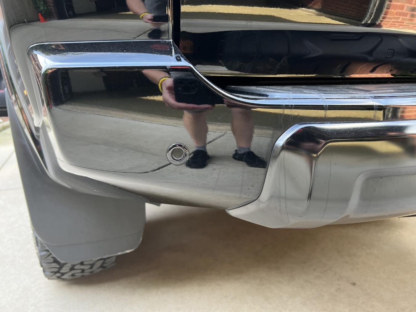

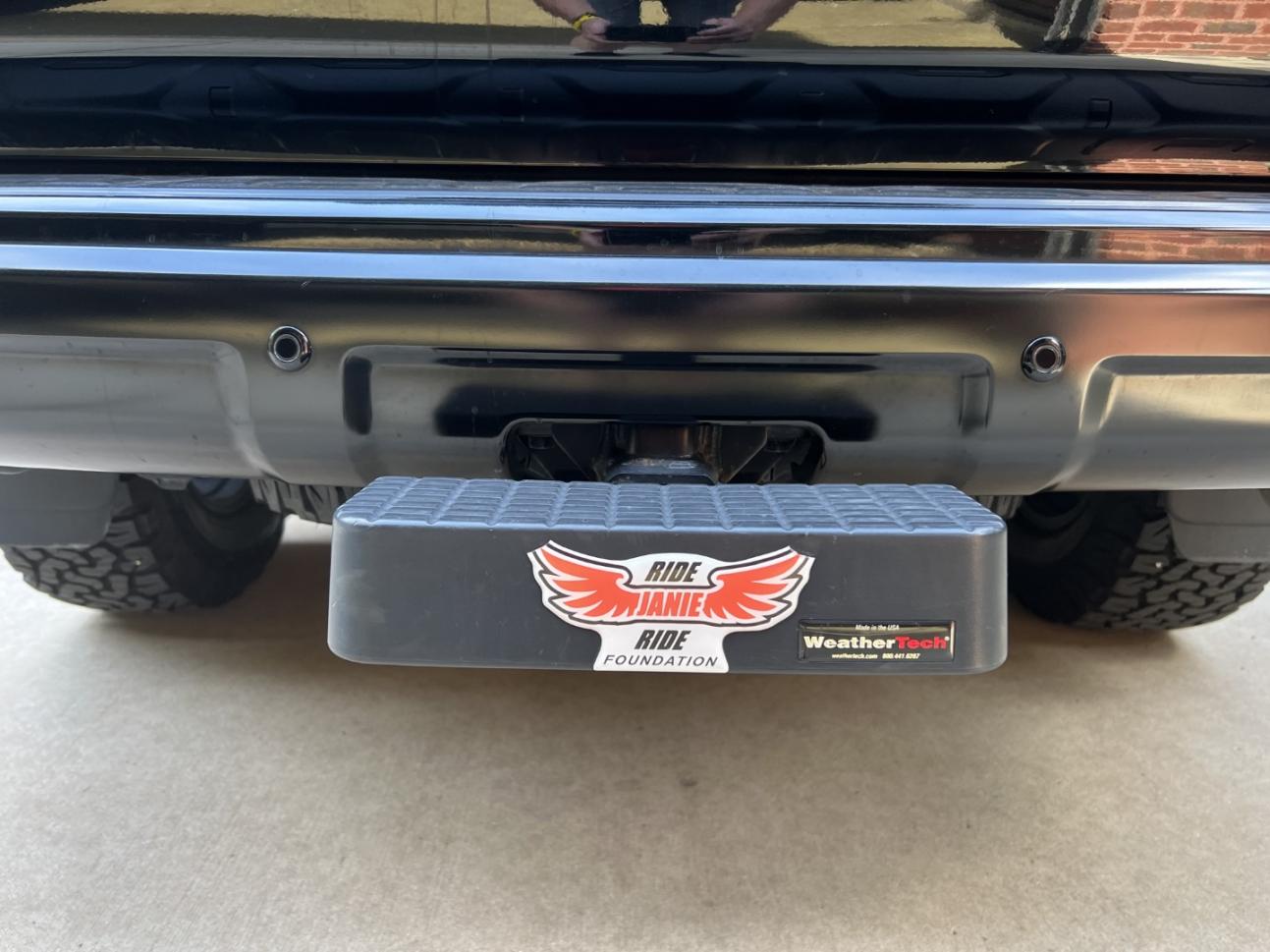

For the rear parking sensors, were the holes in the bumper for routing the cables/ sensors to the valence just cut with a Dremel?

We drilled a small pilot hole and then used a unibit / Step Bit to get the desired hole size.

When I get home tonight I will take picture of the rear bumper sensor location.
Here is a picture of the factory hitch. (sorry pictures are from an ebay listing)

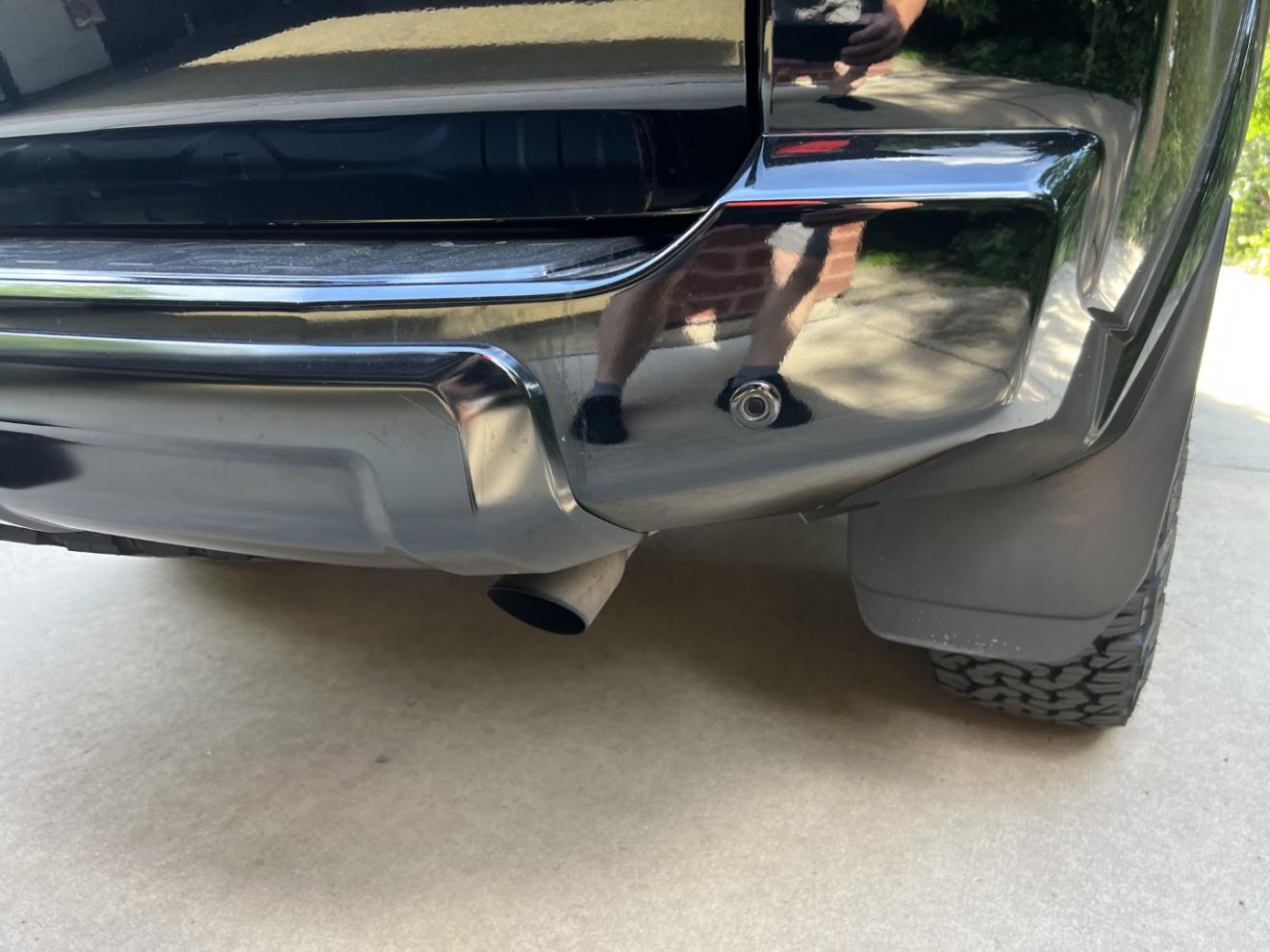

Pictures of the Back Up Sensors
