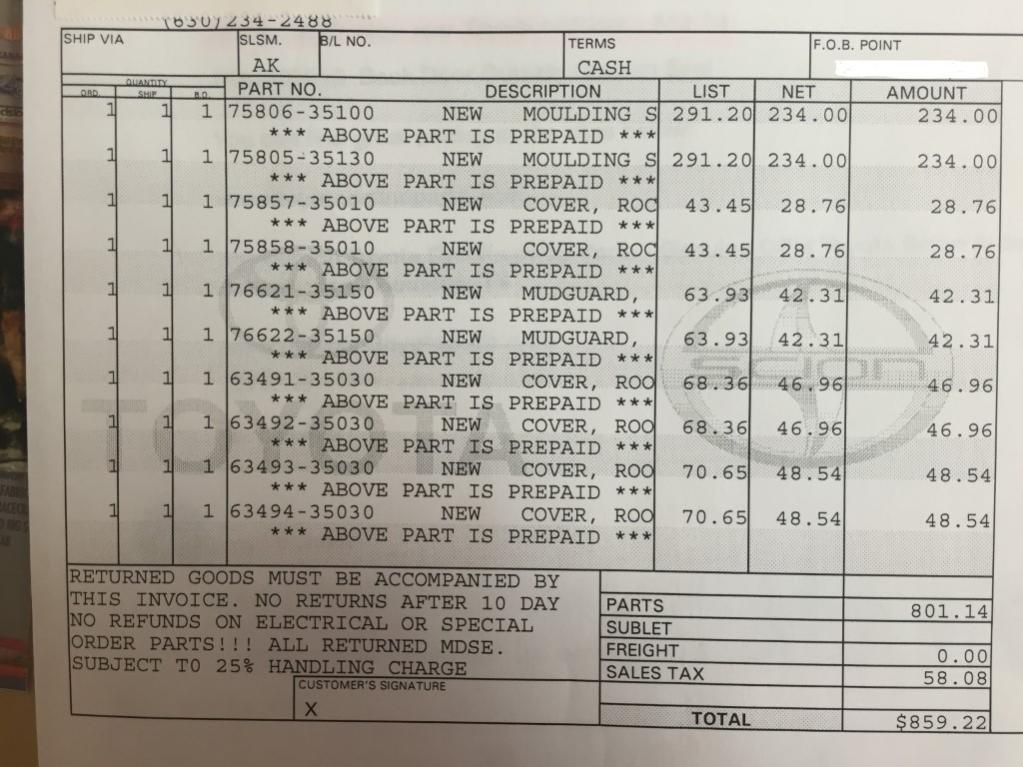

Next step was the trail rockers and the factory nerf bars.
I purchased the Nerf Bars from a new member on the board and he shipped these to me as promised. Daniel is a great guy and I can't thank him enough.
I originally cut up the limited rockers to see if I would like them.
But I didn't so back to the dealership to order more parts. I also ordered the pieces for the roof rack while I was there.
Cut rockers coming off
I also ordered the factory mud flaps
What are the part numbers for the stuff you picked up at the dealer to delete the limited rocker pannels?
