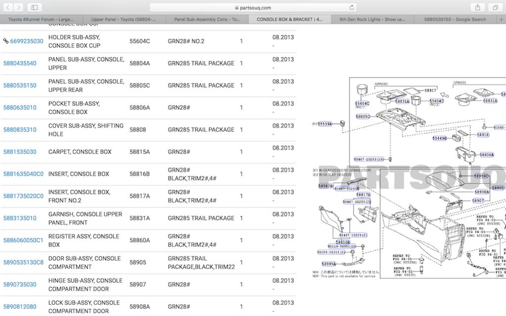

If you are looking for the COMPLETE ASSEMBLY (meaning forward cupholder, transfercase boot, rear cupholder, clips, etc.) then the correct P/N is: 5880435540. If all you want to do is change the rear of the console panel then this is the appropriate P/N: 5880535150.
I used my own VIN from my '15 TRP that utilizes the same trim you're after, but keep in mind that the aforementioned P/N is only for the trim (possibly the clips too, check with Toyota first). I think it would be safe to assume that the switch blanks, clips, cup holder, and tray do not come with as this is a "Sub-Assembly" rather than the entire panel. The P/N for the switch blanks (if you need them) are: 5553958060C0 and the P/N for the clips are: 9046710203; the trim piece requires 10 total.
Here is a schematic for reference and URL for said page. (https://partsouq.com/en/catalog/gen...d=219607&cid=3&uid=261186&q=JTEBU5JR8F5263870)

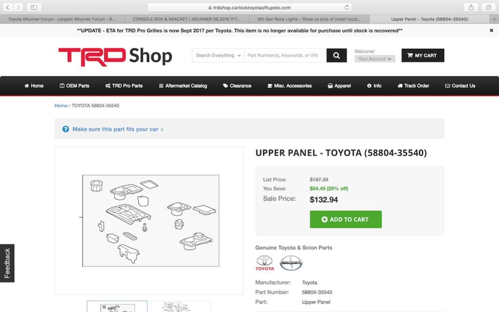

Here is the going rate for the entire assembly per the P/N I provided

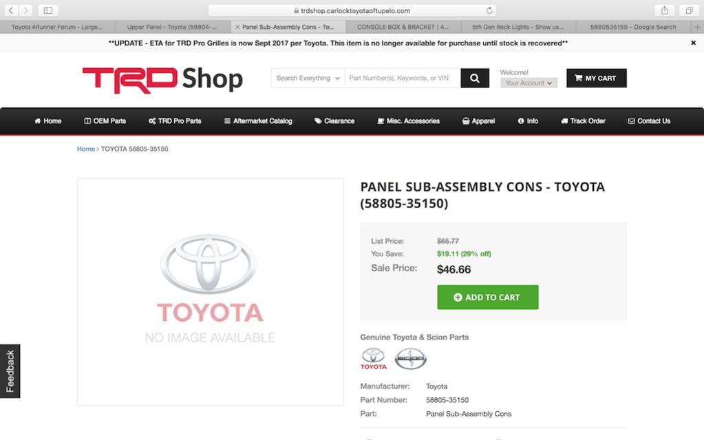

Here is the going rate for the trim piece only

Great info! Exploded view drawing with part numbers?! Incredible. Well done.
