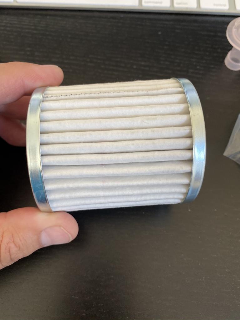

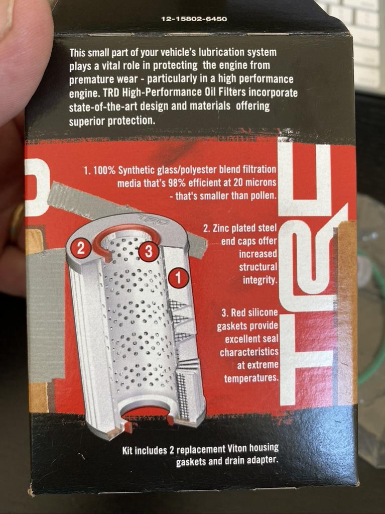

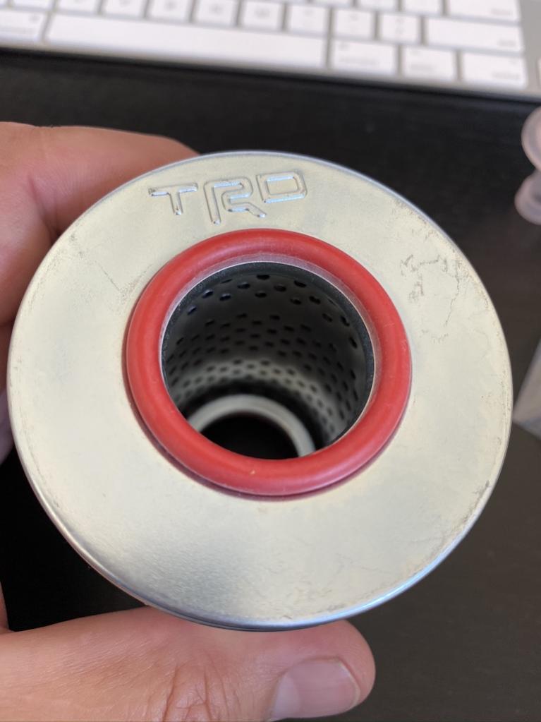

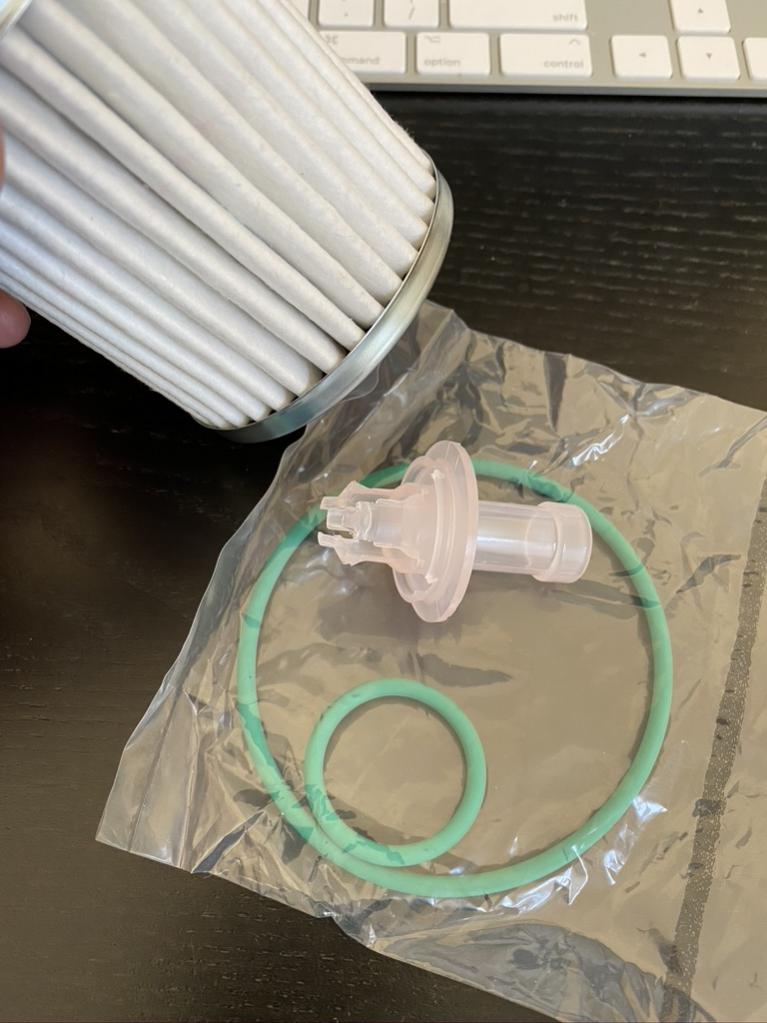

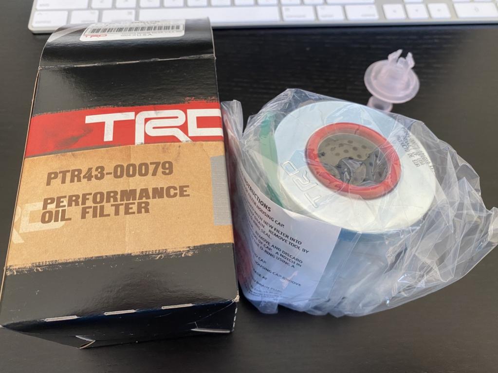

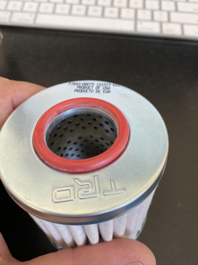

As far as the TRD Filter, it is made my Champion Labs, which also makes the extended interval filter for Amsoil and Mobil 1. I've had all three, and they all appear to be largely identical filters.
If you purchase on one of Toyota's sales 20% off with free shipping, you can snag these for about $12 a piece (or less). Much cheaper than what you pay for the Amsoil or Mobil filter. If you are doing longer drain intervals without swapping the filter midway, it may be worth it, as these filter better than the OEM filter...
Here is a closer look at the TRD filter for the 4R

So, like air filters, if it filters better then it restricts the flow correct?
If made wrong, then yes. If made right, then no.
Finer media can be used to filter better- but done right there is more of it so restriction isn't higher.
