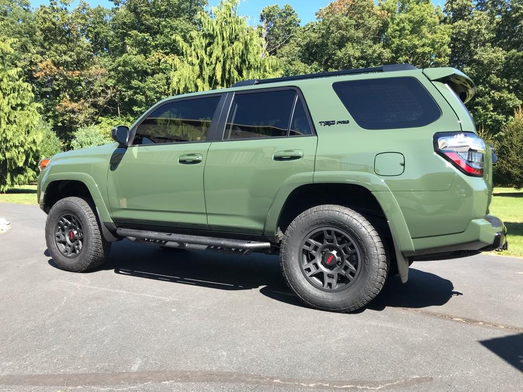

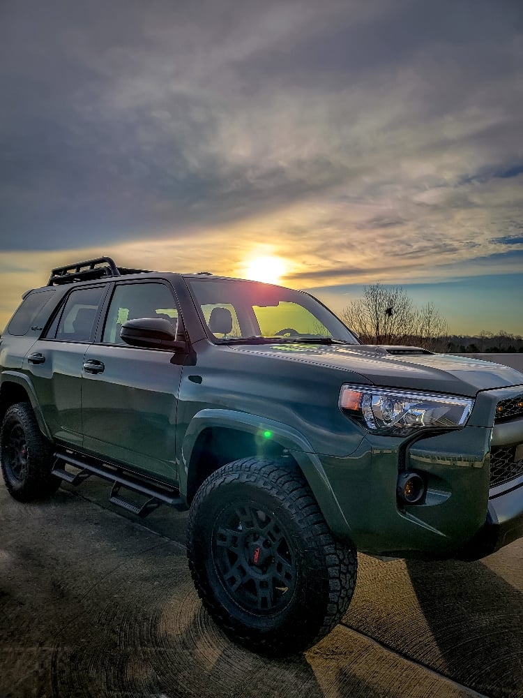

I did Eibach springs front and rear. It made it less softer ride. A little more firmer from stock. Even my wife thought it would ride bad after the new springs. But she thinks it’s rides great. I think it still looks good with the stock size tires. I have pics before I added the 285’s. I don’t off road it’s all for show and looks. But after my 285’s wear out I may be going back to stock size with my SCS wheels because of them being a 8.5 inch wheel it give them a more beefier look than your oem 7 inch wheels.
Lifter with Eibach springs and stock size tires.
can you please tell me your measurements from center wheel to bottom of fender front and rear thanks is it a 1' lift all the way around
I have the 1.6 in the front and rear inch. Eibach is pretty much on what they say you would get. So that puts your Pro higher than factory. Hope this helps.

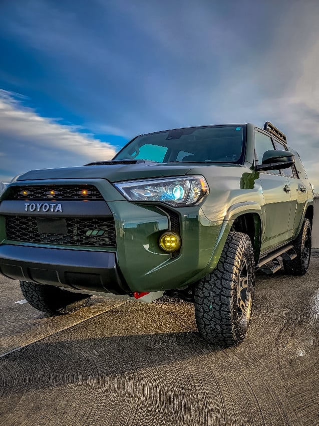

Just had eibachs put on this week with 285 falkens

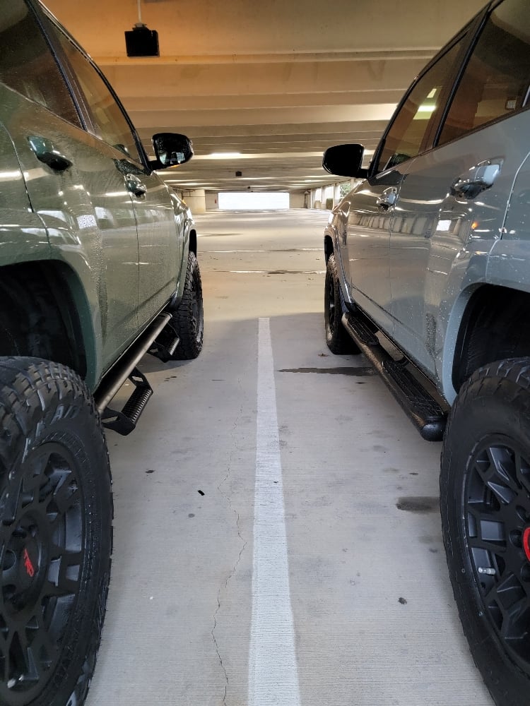

Also a pic of it next to a stock lunar rock for added height reference

Looks good. Did you go C or P load? How much trimming to fit?

[MENTION=11780]Aaron[/MENTION]_cit so you only added the Eibach spring for the Trd Pro right can you please measure how much clearance do you get at the front skid plate and the ground with the lift and 285 thanks man
Went P load, no trimming but I did get a BMC and SPC uppers. Moved liner in a tad as well. All that was overkill and gave me a boat load of room
