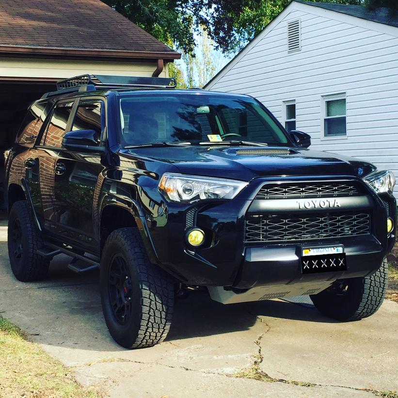

You can fit a 275/70 like [MENTION=112082]Warpath[/MENTION] did
warpath-albums-my+2014+trail+edition+4runner.-picture27191-goodyear-wrangler-mt-r-275-70-r17-17-x-7-trd-rims.jpg

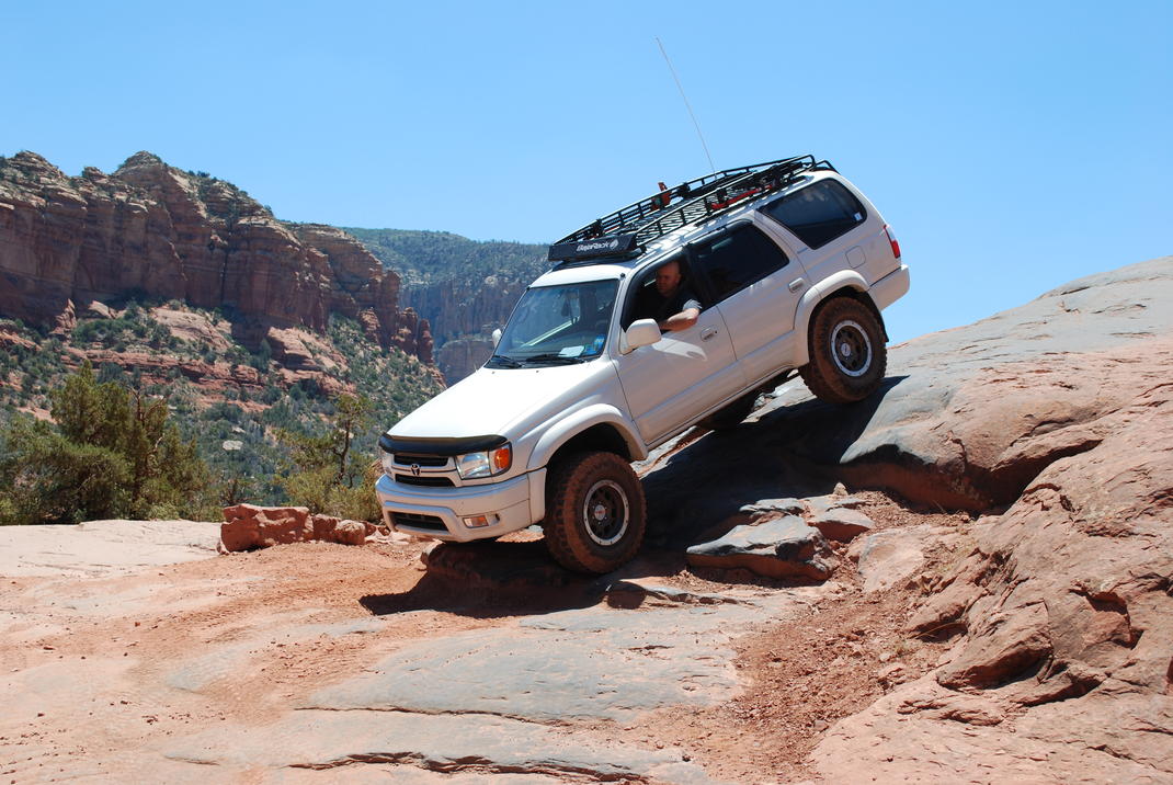

What about Broken Arrow in sedona? Will the stock setup be able to make it without shopping for a new bumper afterward? Had a blast last time I was up in that area. That was my old limited...loved that thing.

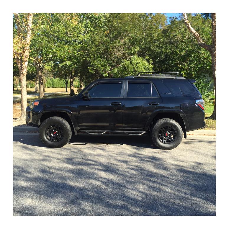

I had a customer that was in your exact situation. He wanted to fit 285/70r17 tires but did not want to just trash the TRD Pro suspension. He ended up going with a Icon front leveling spacer up front PT#IVD4100SD this part bolts on top of the factory upper strut mount, and a ToyTec 1.5" rear spring spacer. He now has plenty of room for 285/70r17
FYI. Icons are the only way to go. For trd pro suspension, for what they are, they are pretty good from what I read about despite the fact it doesn't lift it much. Do what I did, install a toytec spacer in the front which will raise it about an inch and buy some Spidertrax wheel spacers. 36 3/4' front and 37' rear. Only a 1/4 inch of rake in the front. I'm happy with no rubbing.
Same boat. Don't want to completely dump the pro suspension and don't know what kind of effect the spacers have or if they will cause problems down the road just would really like a little extra height and clearance
The TRD PRO should have sat like this from the factory. Without the Spidertrax 1.25 wheel spacers and 3/4 toytec front spacer.
