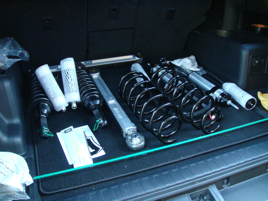

just get the icon stage 5 front totalautomotiveLV great people to deal with. got my icon stage 5 from them. awesome customer service just waiting for time to install them. DSC02016.jpg

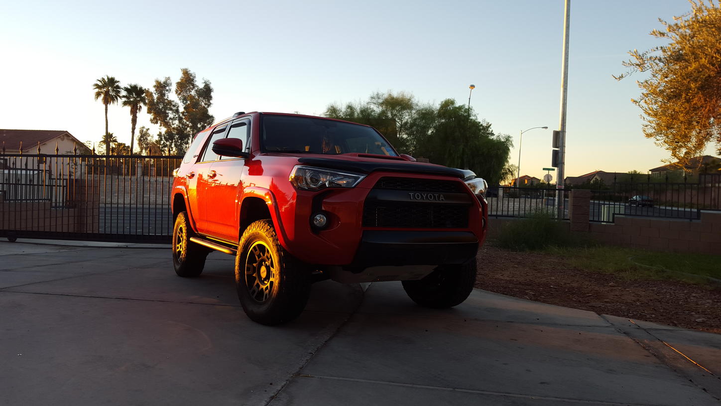

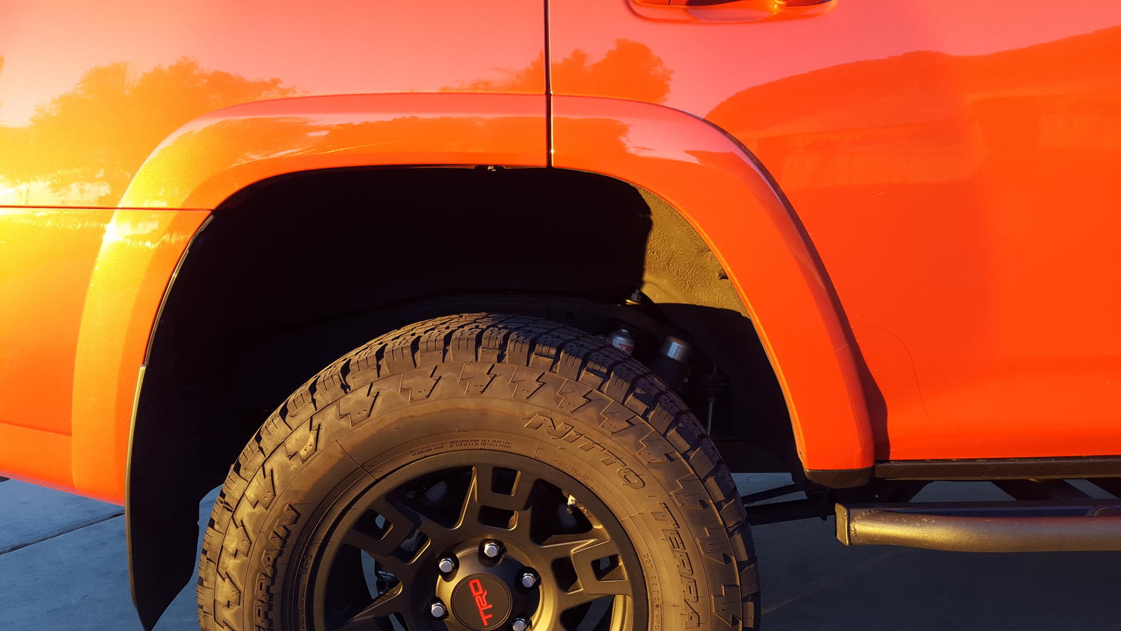

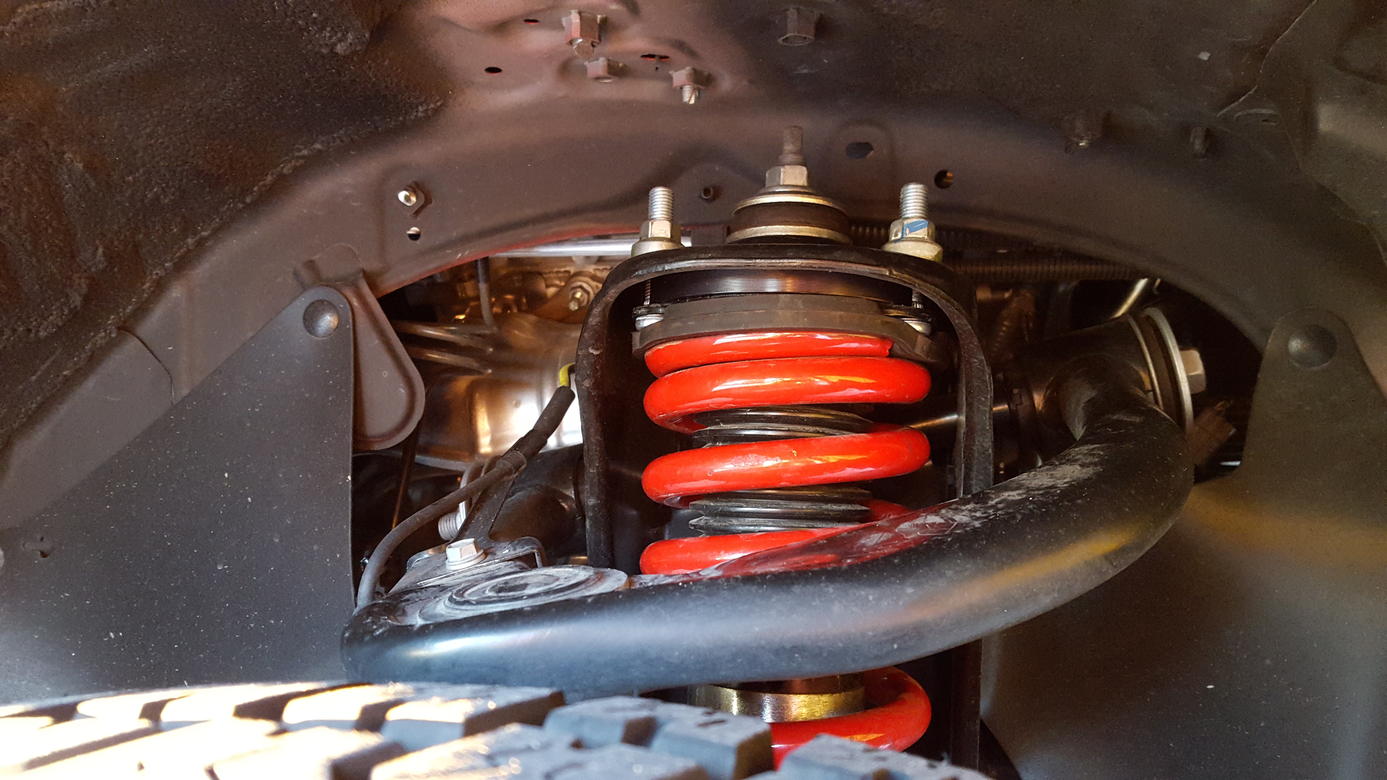

Just to update everyone. Received and installed the toytec kit today. Fits like a glove, rides great, and now I'm sitting 2 inches higher. For those that have the trdpro and want the lift without the sacrifice....this is the way to go. The front spacers are not like the others out there. It's divided into 2 (top and bottom) and reduces the compression you'd get from a traditional spacer. It's exactly what I wanted, and now 285s won't be a problem.
Thanks for following up. Would you be able to post a pic?
Here are a few photos.
