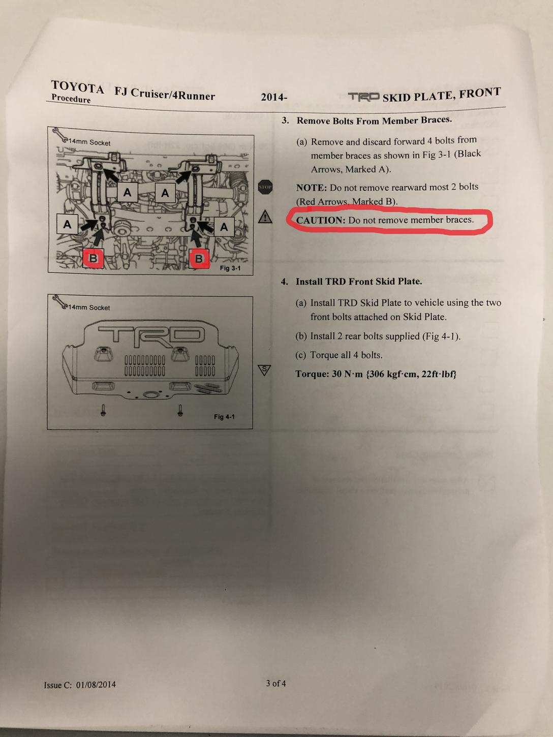

Removing support brackets?
I've read in other forms that people are remove the the support brackets to install their skid plate. The only pieces I removed were the original front engine cover/plate, the lower bumper cover, and the 4 bolts on the support bracket. See image three.

Do you have KDSS? I tried for an hour and couldn’t get my skid plate to fit over the brackets on mine. Once the brackets were off, it slipped right on.

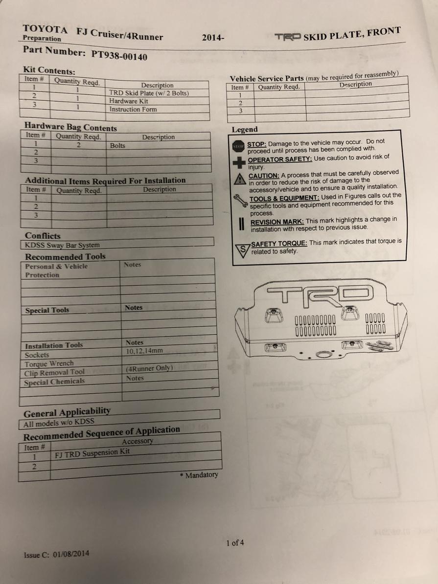

5th Gen 4Runner TRD Skid Plate Install - With KDSS (TRD Off Road/Trail)
I can confirm that 60 mm bolts will NOT remove the requirement of removing the radiator supports. Me and my 10 dollar amazon bag of bolts just tried it, and the skid plate won’t even move into the position with the supports in place. Regardless of the length of the front bolts.
The radiator supports on a KDSS model curve downwards. One would need longer spacers up front and some spacers for the rear to avoid removing the braces.

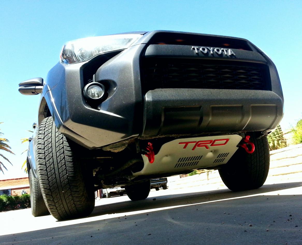

I spent more time drawing in my cut lines than I did cutting and installing the skid? Think I put one small scratch in the powdercoat when the jigsaw snagged but that was me getting impatient. Im happy with it. For $215 on the TRD sale I dont have any regrets.

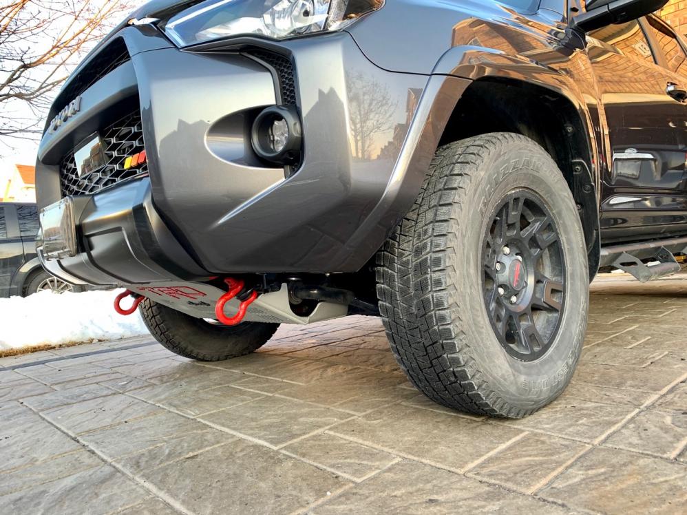

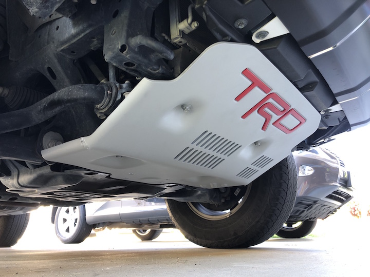

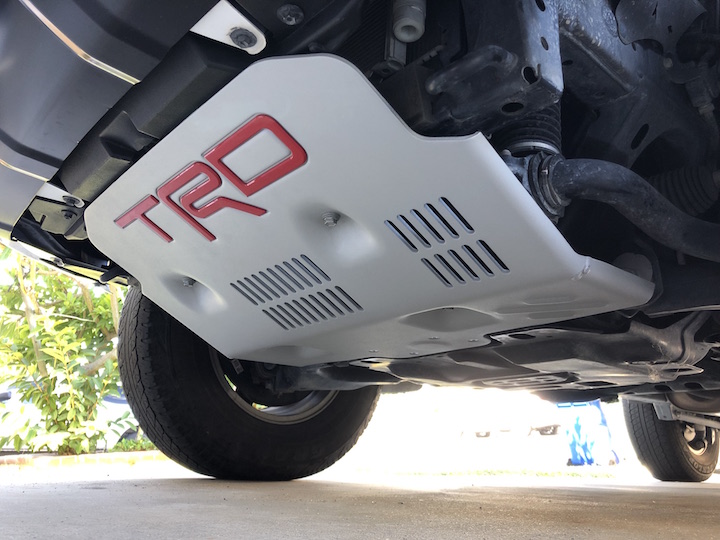

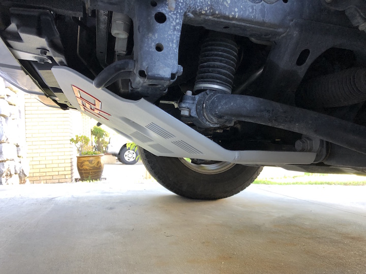

finally did this mod and it turned out pretty good. thanks for all the info here!

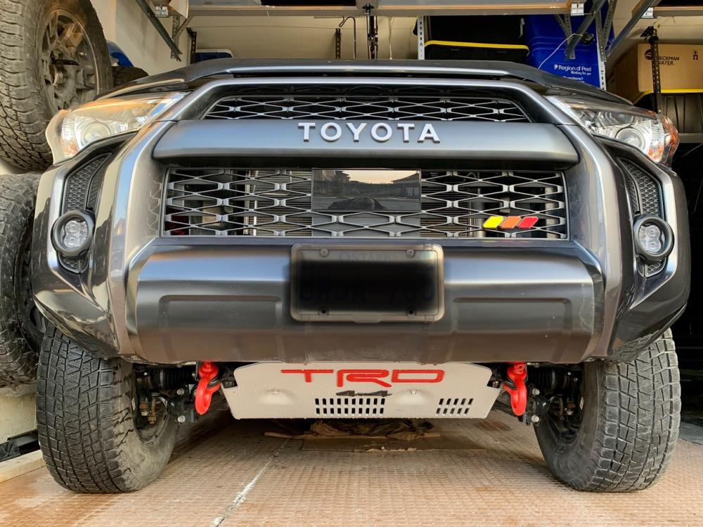

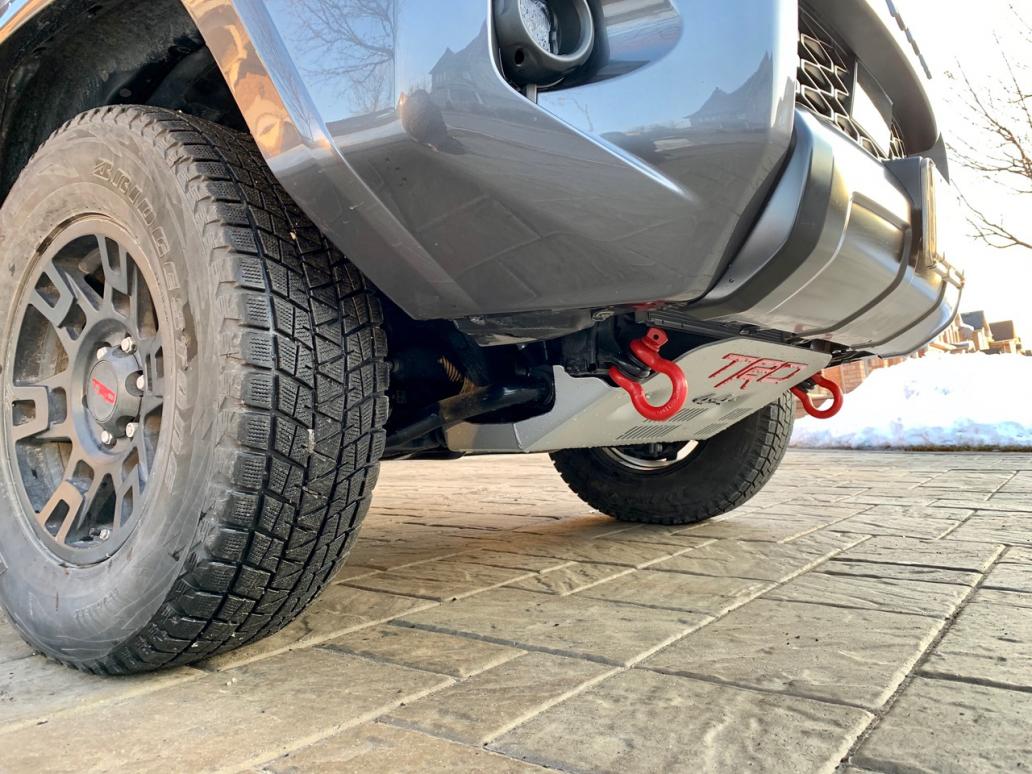

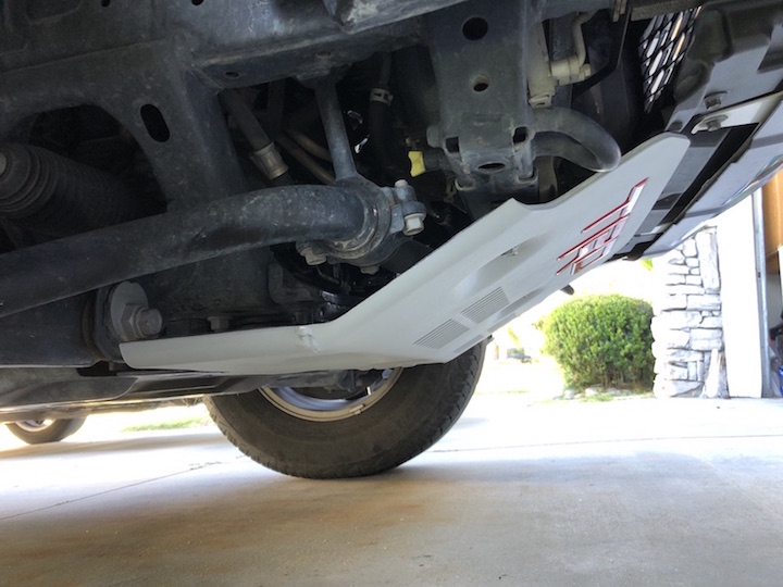

thanks for the template. made the cuts with a jigsaw. filed the edges. painted any damaged colours and installed.
(1) the radiator support brackets needed to be removed
(2) i used all four bolts that came with the TRD skid to install. they went in without any resistance and i torqued them to specified settings (22lbs/ft)
looks great. so far kdss cylinder has not hit the plate.

My KDSS sway bar hits when I articulate my front end past a certain point. What’s odd is that it hits in front of the sway bar, not below where you would think it would make contact.

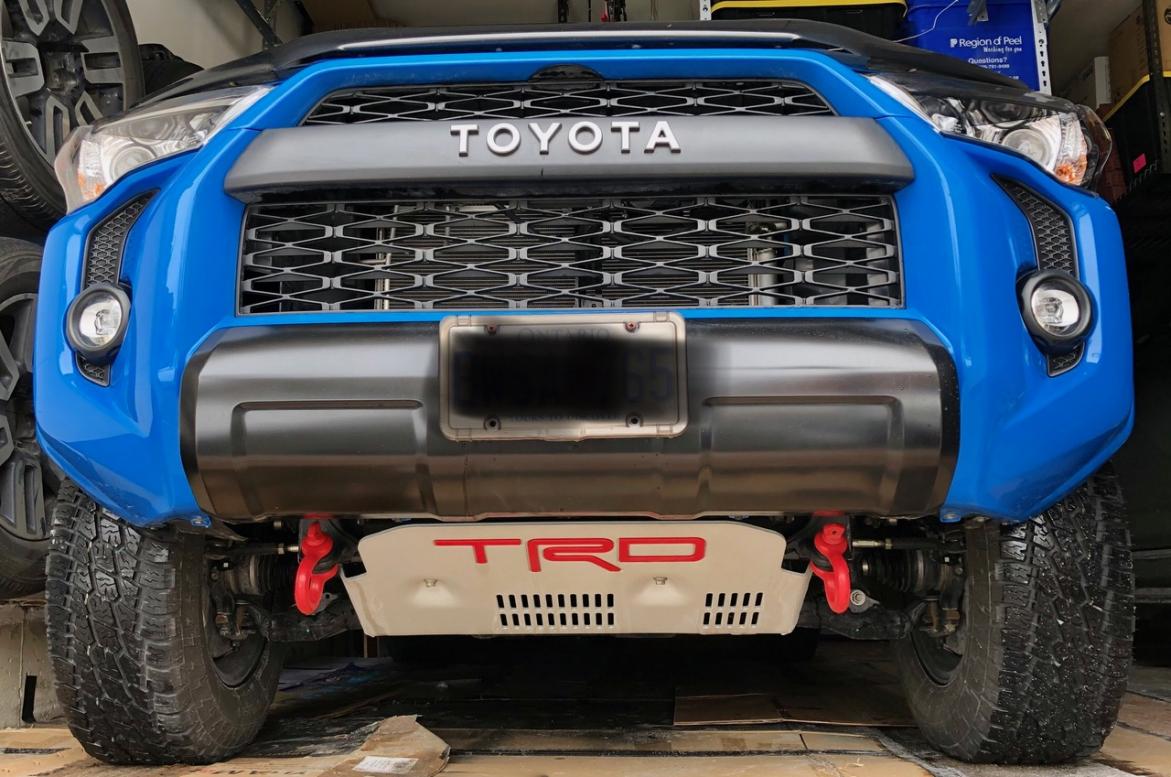

2020 TRD OffRoad in comparison with my 2019 Pro

Just curious. Your mods looks a little different and way better than others I've seen. Did you take out the two support brackets? It also looks like you added spacers at the front other than what is already provided in the kit as well as spacers at the back mount. I also see you mounted the bumper liner which I was not able to do in my mod. How did you do that? Thanks.
