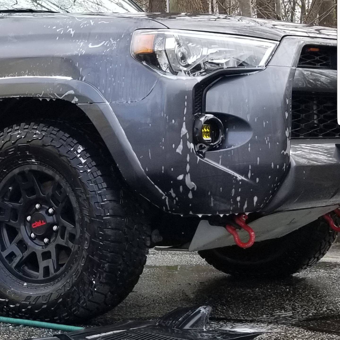

My TRD skid is modified for KDSS but i no have KDSS. Trade? Lol (bought from a previous user)
The skid sides have to be cut off inorder to work with KDSS.
I also reused the plastic piece upfront. The radiator is all open there so i just cut to fit the hole and reattached.
