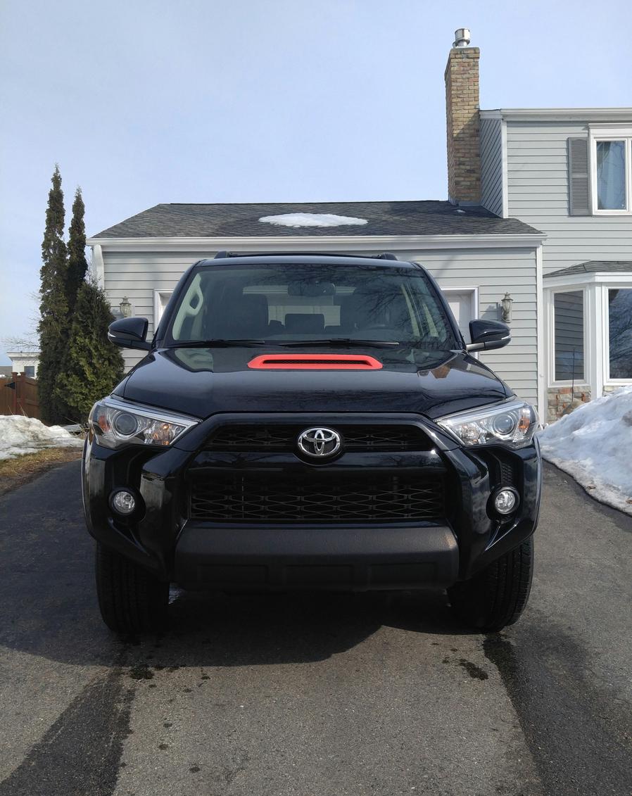

Finished product - candy apple red. Blacked out my front bumper too.

I went with the red (matches the TRD logo on the black wheels) painted interior mesh look.

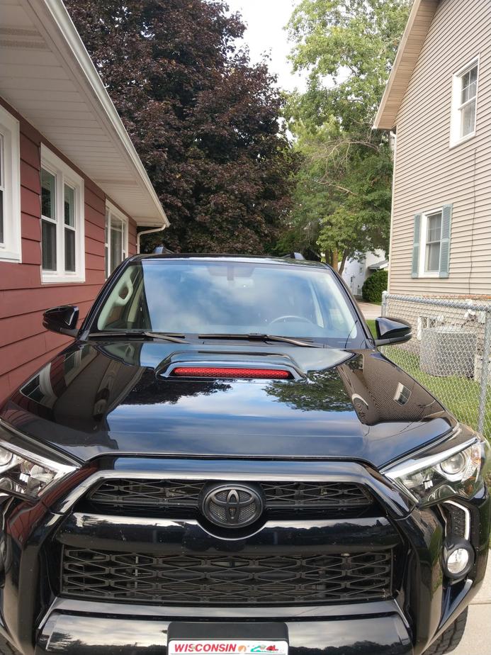

wrap and dip combo
Has anyone wrapped their hood scoop? I'm planning on wrapping mine in black carbon fibre vinyl once the WI weather warms up.
The "intake" is dipped, the bulge of the scoop is vinyl wrapped in matte black.

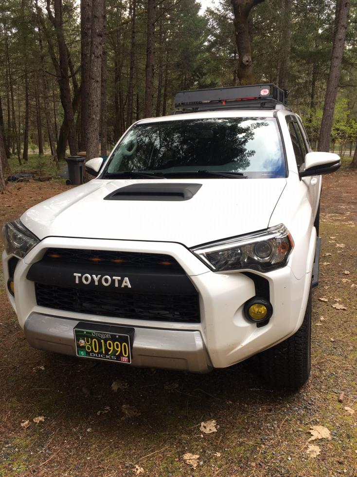

Anybody turn the scoop into a functional scoop?
I want to do this. Here in So Cal we need all the cool air rushing through the engine bay we can get. It would allow the engine bay to cool off faster after turning the engine off too. It looks like there's room in the hood underneath to pass air. The only drawback is dust might get in when off roading and you have to deal with rainwater blowing in.
Has anyone tried this?
To further cool the engine you need more air through the radiator. Opening the faux hood scoop could potentially upset the air flow through the radiator.
A better mod would be to add a small radiator to the trans oil line that goes to the main radiator
I live in SoCal too and never needed more than the trans cooler since I pull an off-road trailer.
