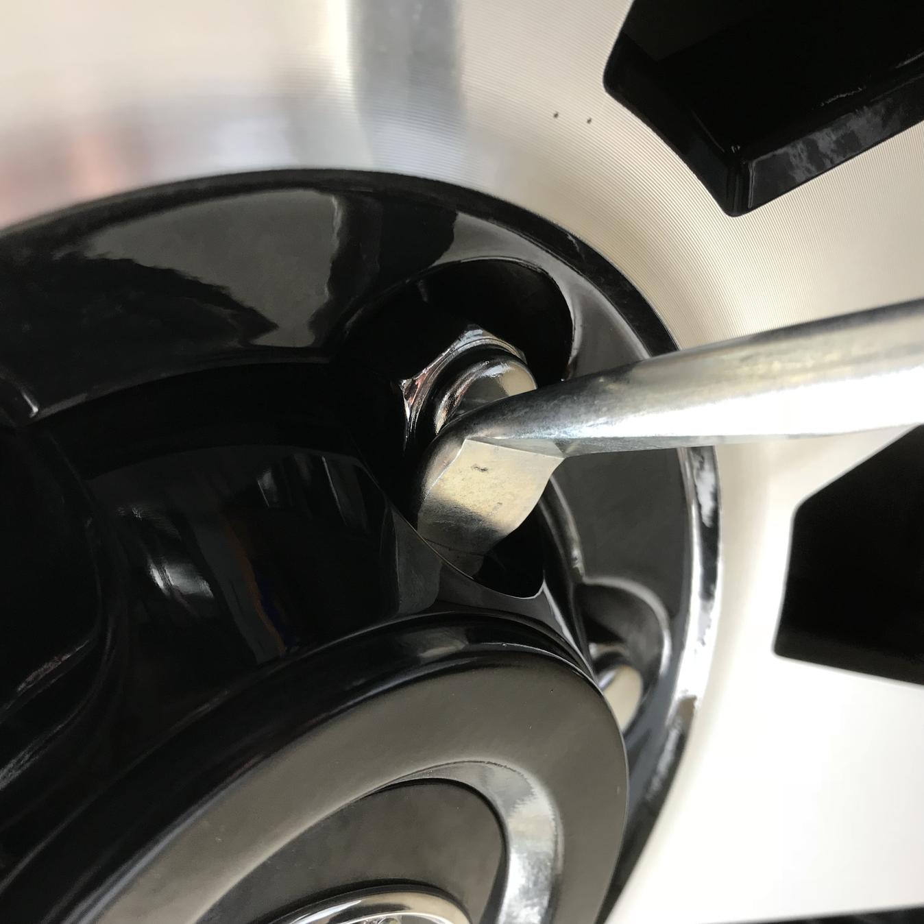

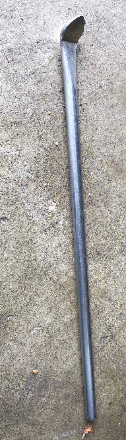

It’s a good idea to take off the center caps yourself. They are so delicate that tire shops and dealers can easily damage them especially when pounding them back on.
In your 4R tire kit bag is a foot log pry bar with an angled spoon end. Use that to easily pry off the cap in one of the 2 slots. To install the cap, line it up and slap it on with your palm.

Again thanks for the replies but I think we're talking about two different caps . These are the spring loaded center caps that come on the black TRD Pro rims .
