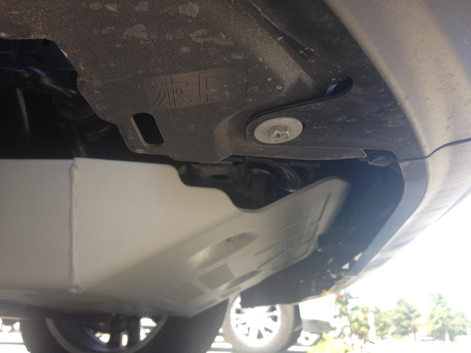

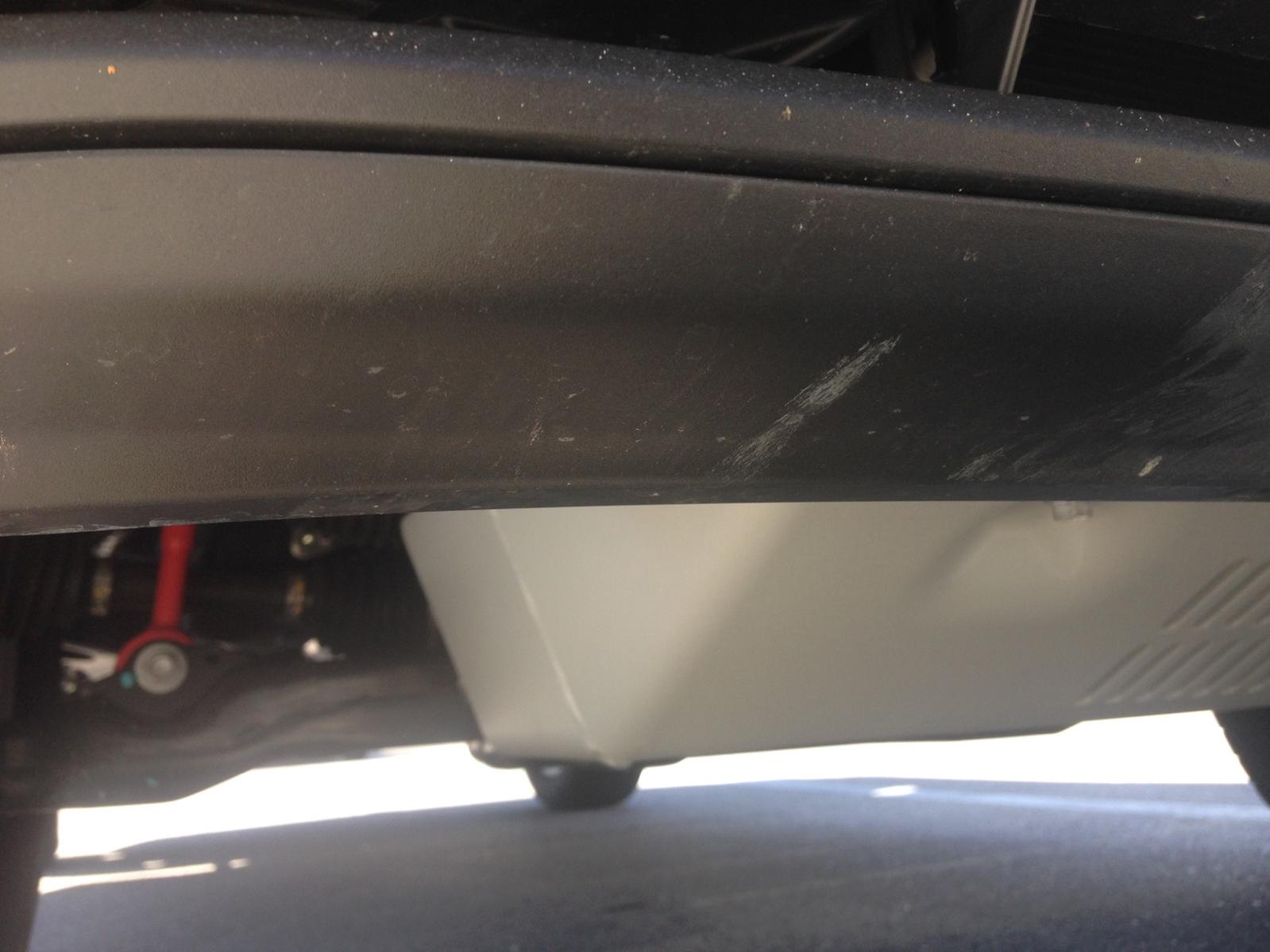

Here are two pics I snapped out in the parking lot. I'm still debating if I want to blackout a few pieces to take the chrome level down a notch!
