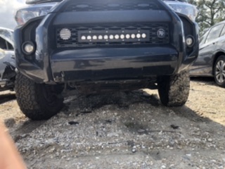

What do you think the stamped skid would have looked like after hitting a 18” dia pole across the roadway.
This skid more than likely saved my life by lifting my front end up rather than crumpling upon impact!
So that’s my answer, you may disagree.
