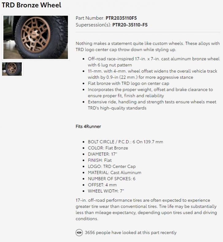

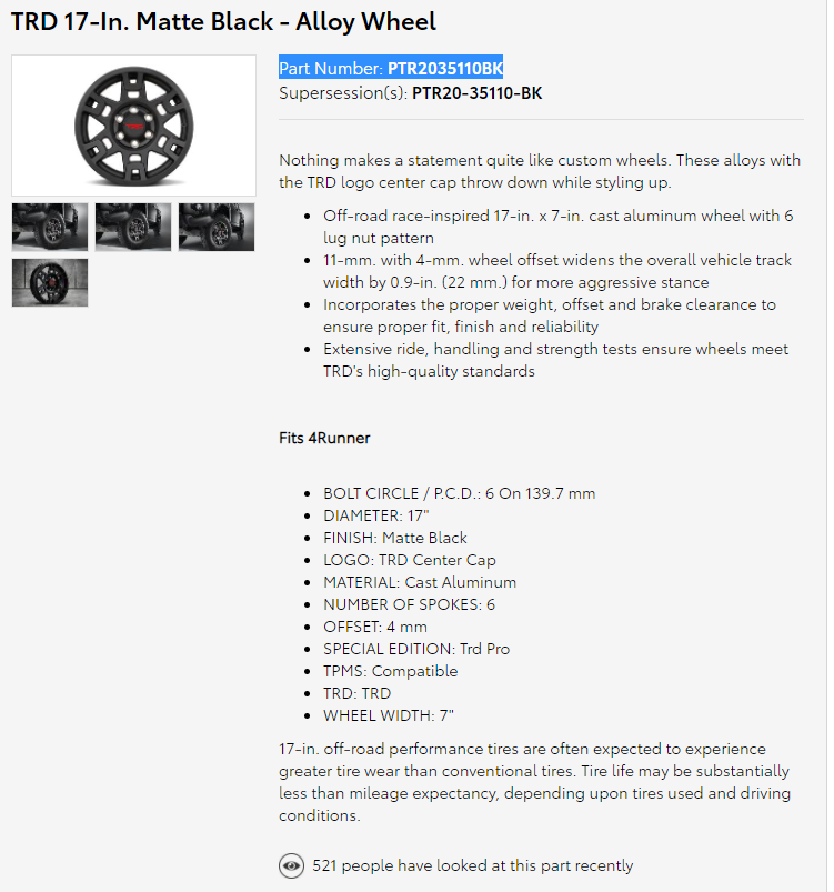

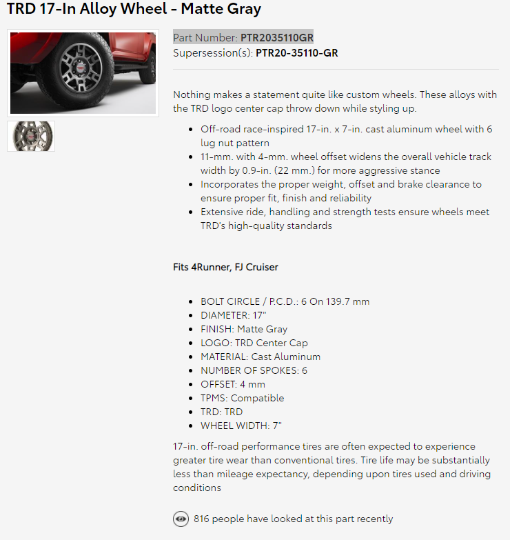

So I just bought a Red 2015 T4R SR5 and want to change from the stock wheels. I really like the look of your Red T4R with the bronze TRD wheels but I was doing some research and looking to order them directly from Toyota but when I put in the specs of my T4R it says they wont fit, but the Matte Grey (Part Number: PTR2035110GR) and the Matte black (Part Number: PTR2035110BK) both will fit. Looking at the spec sheets of both of them they are identical in size and diameter. Is there a specific reason that or will they fit?
I've tried looking in through the forum to answer my question but I have not found an answer. Thanks for any help in advance!

They will fit. Same specs on all 3 colors.

Itll fit. The wheel is a little narrower than the stock 7.5 wheel on an SR5 and the TRD wheels will stick out a little farther. Shouldnt be an issue for most tires and uses
