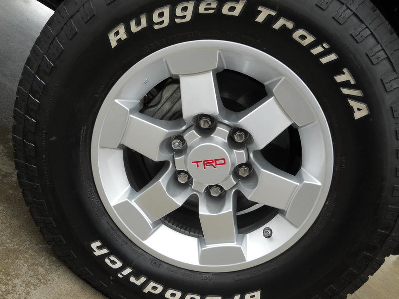

Hey everyone,
I'm wondering if anyone knows if the 6 spoke TRD FJ wheels will fit over the 231mm Tundra Calipers. I've got everything sitting here to do the brakes and I really like the looks of these wheels but I don't want to buy anything without knowing if they will fit over my brakes. These are the wheels I am talking about.
dscn0273-jpg.101111
I searched and couldn't find any conclusive evidence. The closest thing I found was [MENTION=58830]JWaldz[/MENTION] said he believes that they will fit in a thread that I read but no one could confirm. I believe that [MENTION=106327]GVL[/MENTION] is running these wheels, but it sounds like he has the 199mm calipers and not the 231mm.
Thanks for any help!

I was in the same dilemma but thought I read that some trimming may be required with the 231 and clearance was real tight in another spot. I don't tow anything or carry heavy loads but I definitely wanted more stopping power on the trail so I just went with the 199 to be safe and everything fit perfect and the improvement was tremendous. However if I did tow frequently I would have held out for the 231's.

Yeah they fit fine. I have the 231s and wheels in question.
they are 16's
Thanks esoteric. That's great to hear. You are running just the wheels right? No spacers or anything special?

i currently have those wheels with no spacers and did the tundra brake mod (231mm) they are perfect fit, you won't have any problem
Awesome! Just ordered these from eBay for $600 for a set of 4 and trusting those here that they will clear the 231mm tundra brakes.
