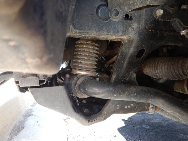

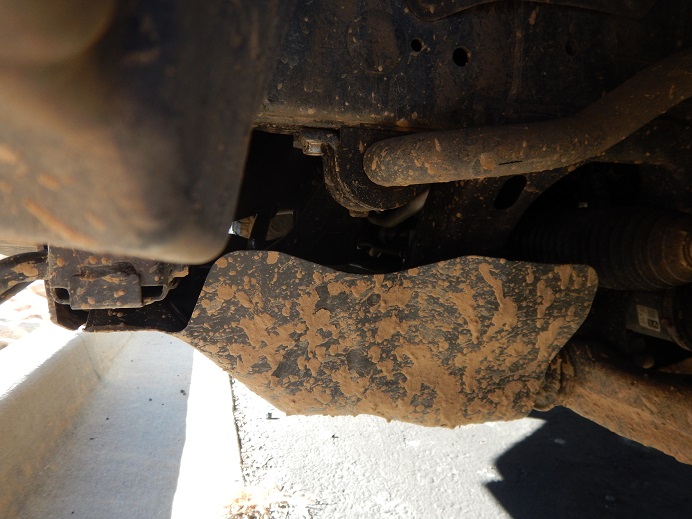

I rented a SR5 and compared the skid plate on it with my stock trail version with KDSS. I measured 8 1/4" to the lowest part of the drivers side of my trail version. The lowest point on the SR5 was toward the back. I measured 9-1/4"
The main problem I have with the KDSS stock skid plate is the approach angle. When I bottom out the front suspension, The skid plate is more exposed and sometimes scrapes the ground. I do prefer the KDSS version over non KDSS as the on road performance is better.
The photos below were taken from the same vantage point to show the difference between the two different skids:
