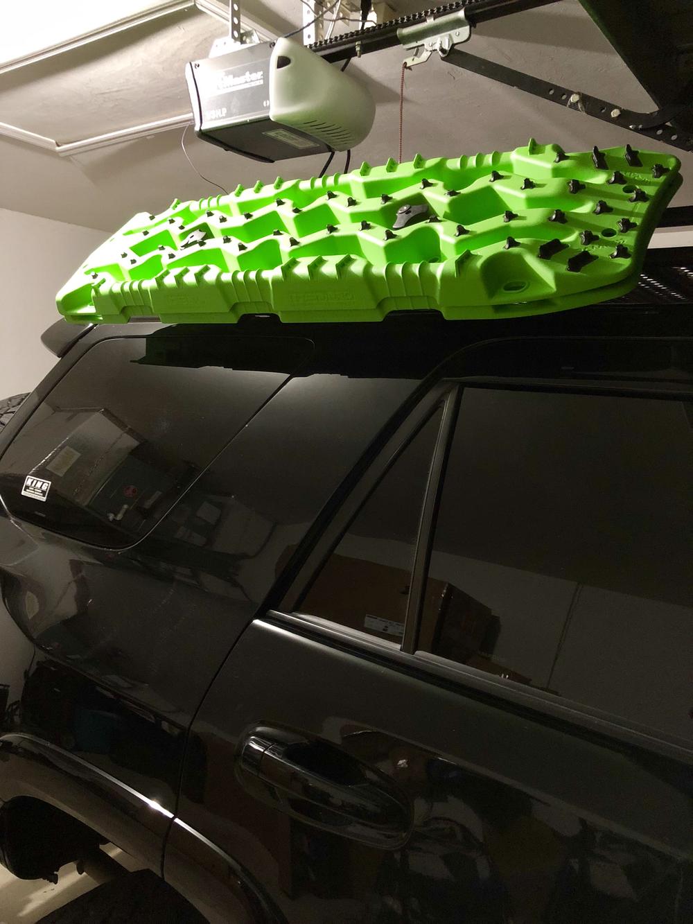

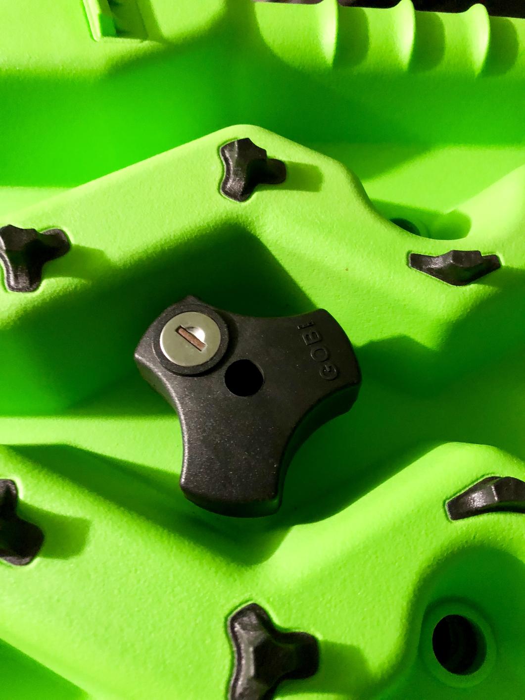

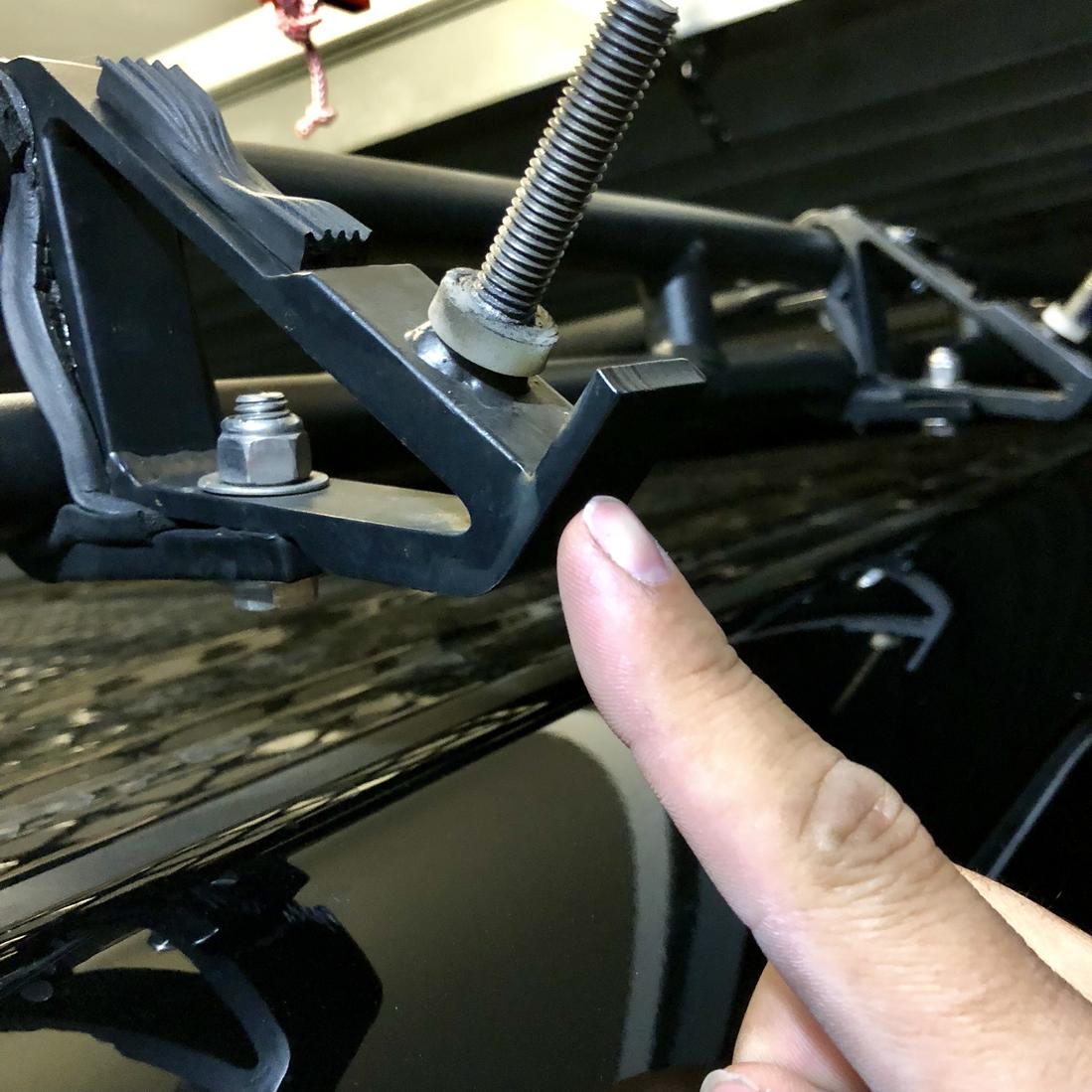

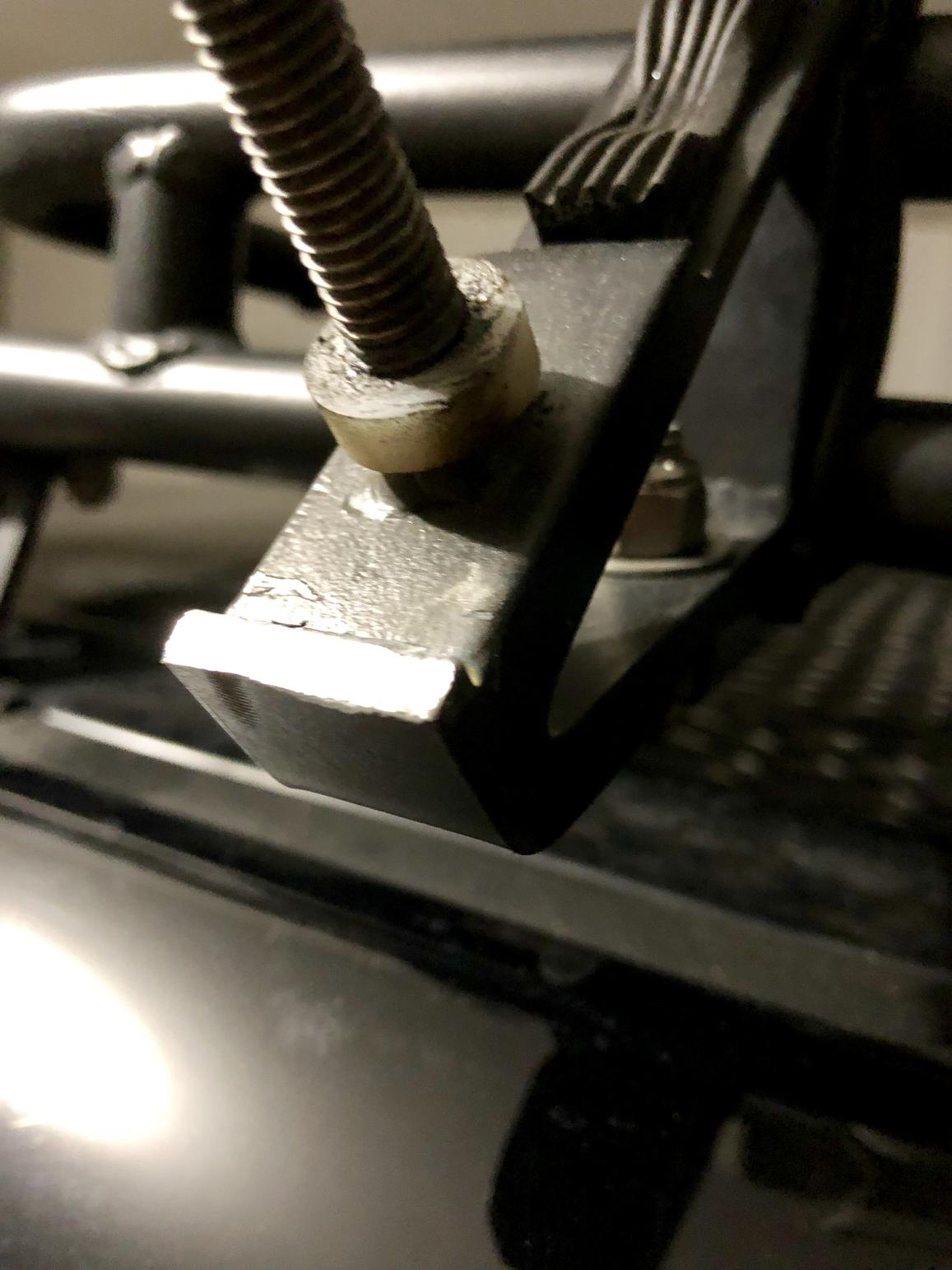

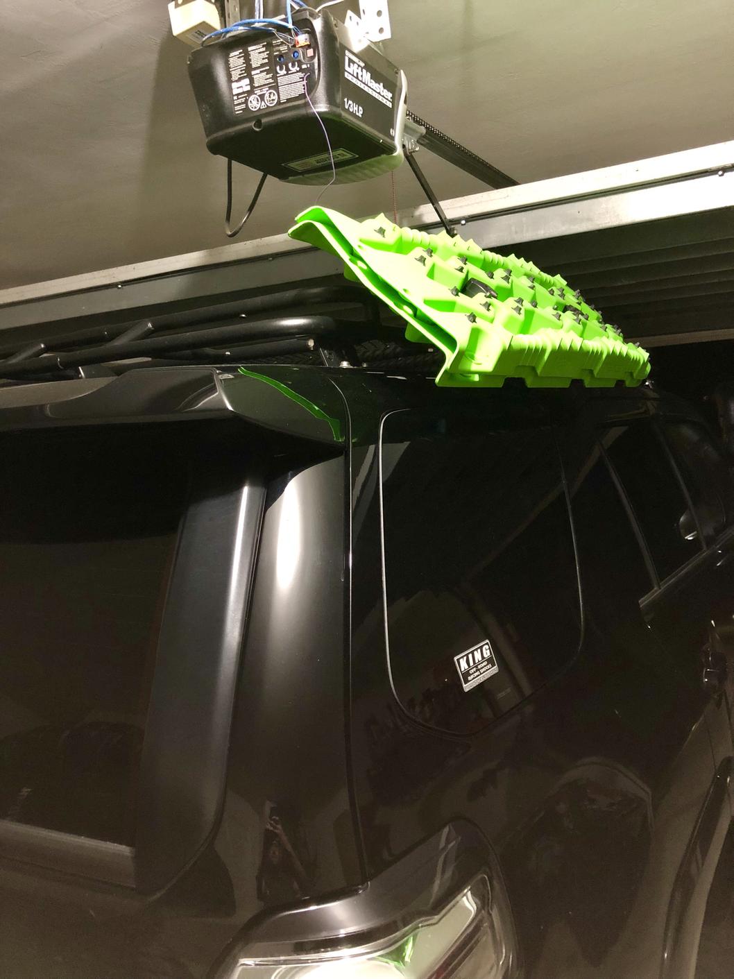

I’m terrible at how to threads but wanted to give Gobi stealth guys an option of mounting Tred Pros with Locks. I recently installed a CBI rear bumper so I relocated my hiLift jack to the bumper. It left me with the Gobi hi lift jack mounts empty. All I did was cut and grind the extended tabs which hold the hilift in place off and wala, you have a flat, slanted base to mount Treds. Best of all the locking knobs fit perfectly within the traction board. I know this isn’t a cheap alternative but solves my problem of an easy mount with locks.
