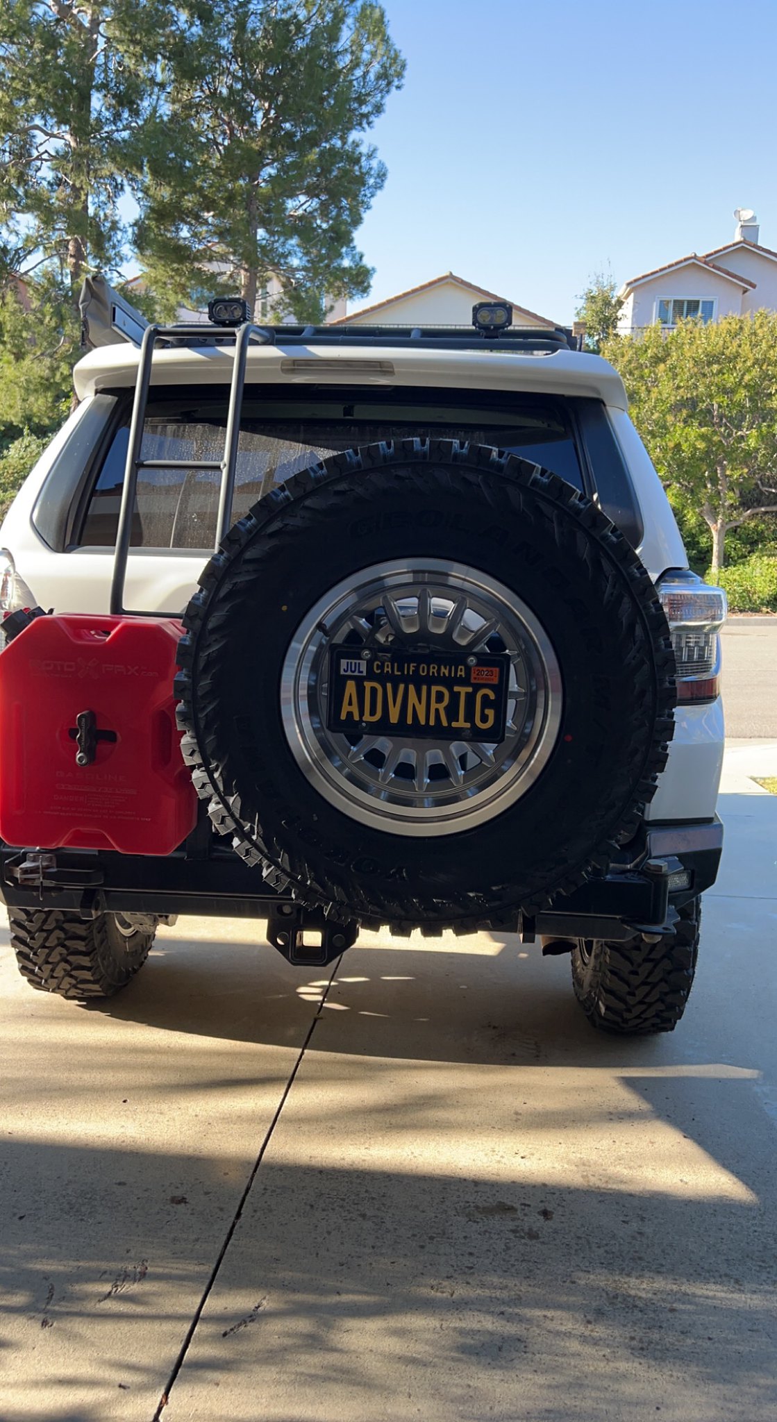

Finally got the spare wheel today, went and got it mounted and tossed it on the swingout. With the license plate lights and relocated rear camera it is an absolute pain lol The wheel design doesn't allow my rear camera and the light module to fit through the holes. Ended up having to disconnect it from under the drawers and run the wires through the outside of the wheels in. Thankfully when I first installed it, I left quick disconnects and in a fairly accessible place. Was toying with the idea of relocating both. Ideally the plate on the bottom of the swing out, but then I will lose clearance and it will rip out on any hit. Then the camera is too low to be useful. That is for another day though. I still can't get enough of the new wheels and tires, made me fall in love with the rig again.

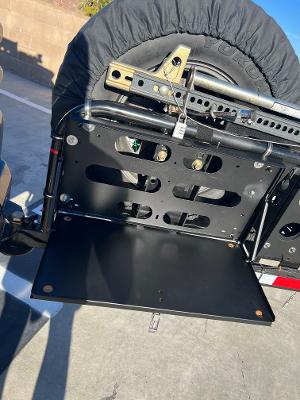

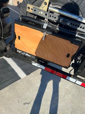

Remember i asked you a while back about your table mounting...well i figured out those padded stainless hose clamps (1.75 inch) will allow you to mount it on the tube, but you have to redrill some holes on the table, and then i put a bolt through the swing arm bump stop and bam....solid as a rock.... It clears the hatch by half a inch.

Nice work, I actually may have to add those if possible for a little extra support. The corners always seem to flex a bit and that may be the trick!
works well. the table kinda gets sandwiched and rests on the rubber part of the clamps, so it also acts like a shock absorber, no rattling, and it doesnt mar the powdercoat, and it doesnt move at all even at the corners.

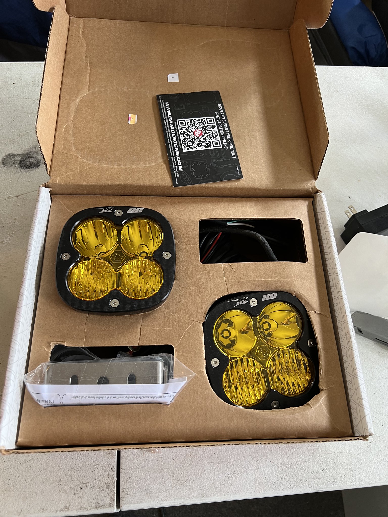

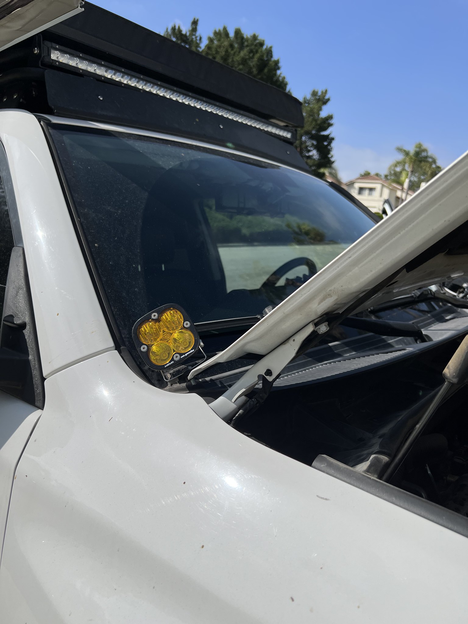

After that trip, I really wasn't liking my lighting setup so I decided to switch things around. Scored a deal on XL80's and couldn't pass up. After going back and fourth with options of where to put them and how to shuffle everything around I finally made my mind up.
2023-06-02 13.34.07 by rjtakesphotos, on Flickr
The XL80's would take their place on the front bumper and I would remove the S2's and a pair of squadrons. The Squadrons would move up to the a pillar and the S2's would move to the rear. On the next trip, this setup would be a night and day difference. So much better output and usability. A better spread all around made a huge impact on nighttime visibility.

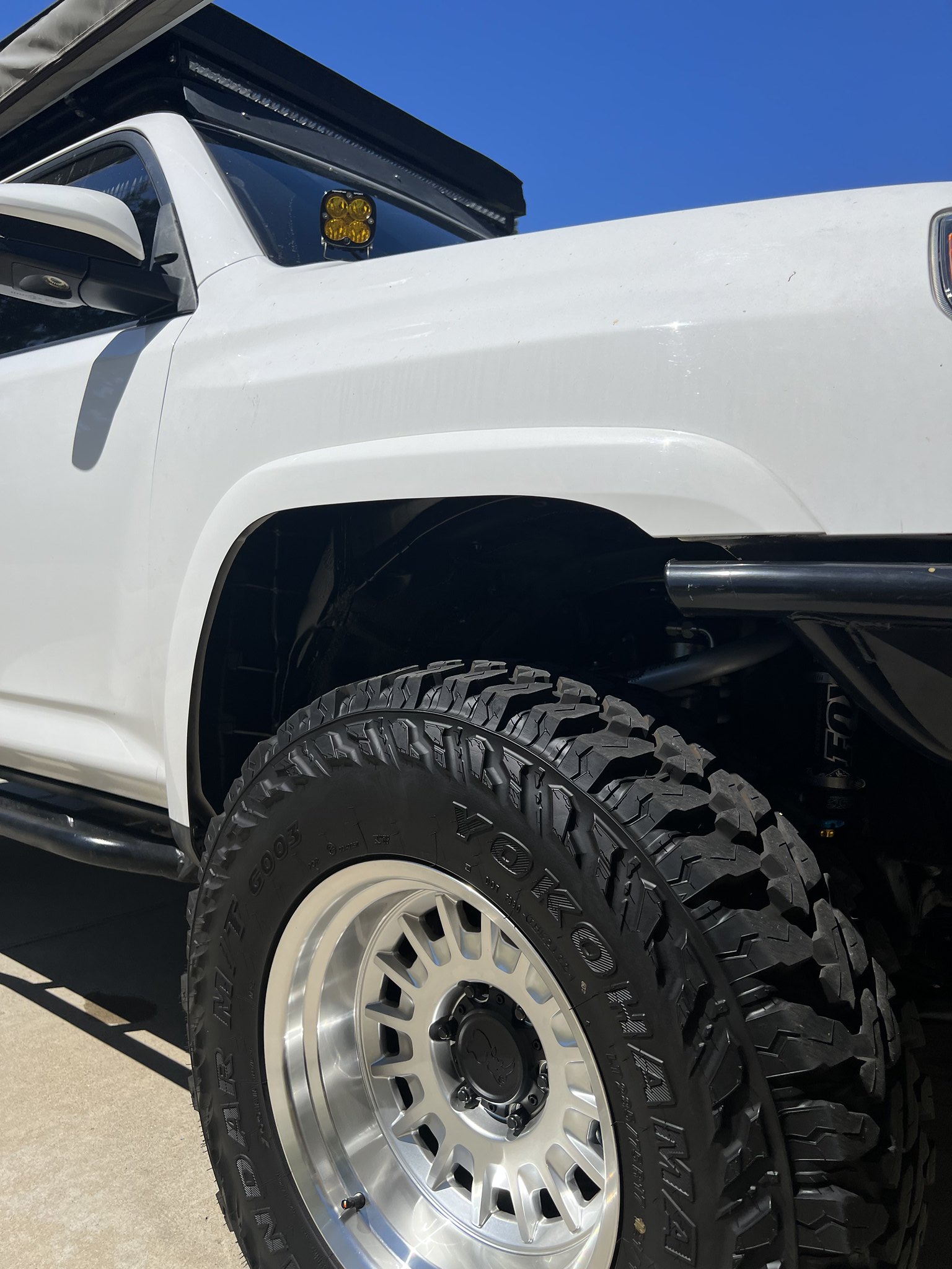

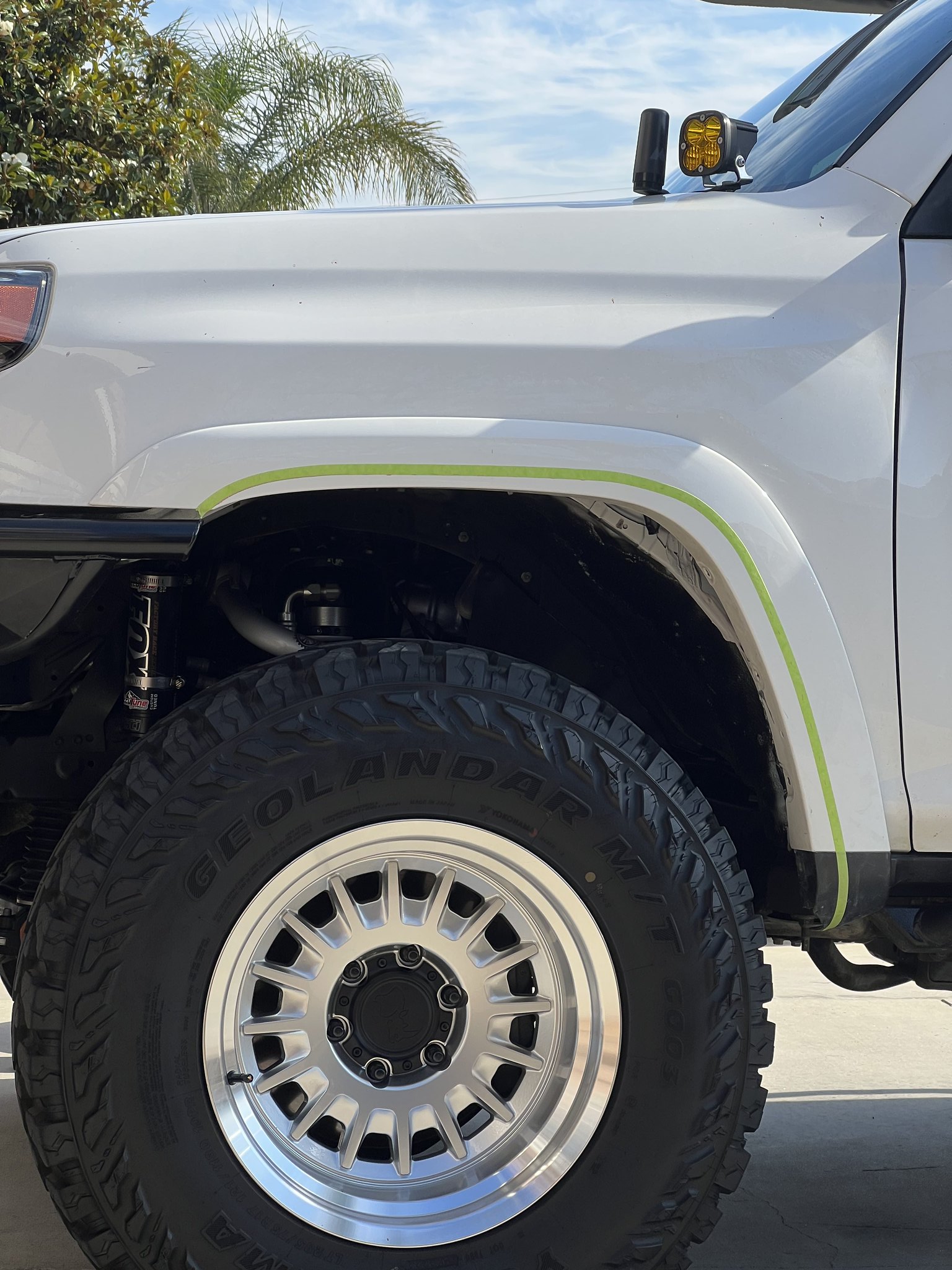

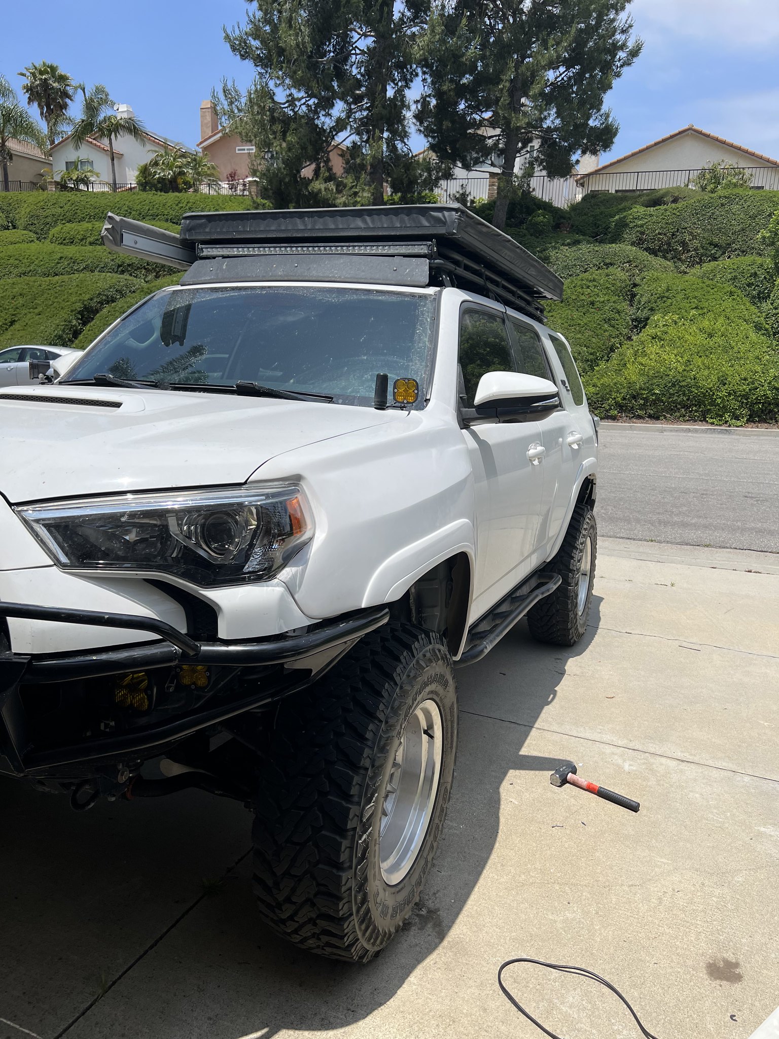

After that trip I really needed to tackle the rubbing up front. What better way to do that than with some wider fenders. 2" Fenders from MPD. Fitment was an absolute pain and quite time consuming, and they still need a decent amount of work to fit perfect. I had enough for the time being and will revisit another day. Eventually they will need paint, but they will stay as is for now. Super subtle look, can't even tell they're on there if it wasn't for the improper fitment lol. Perfect for me on 34's, as the 4" felt would be too much and the adv fenders were a bit too over the top for my setup.

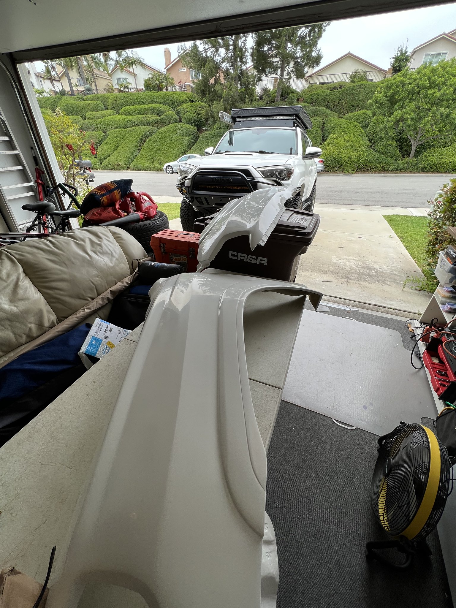

They still weren't sitting right, and I wasn't sold. The fitment is not great, and they are so tightly fitted that I worry any rub will immediately crack them. Since they don't have any rise, it really didn't give as much clearance as I had hoped.
So I reached out to Jacob aka MagRNR for a fender cut on the oem fenders. Here is his super clean rig:
IMG_4735 by rjtakesphotos, on Flickr
Marking up the cut
IMG_4734 by rjtakesphotos, on Flickr
And after:
IMG_4744 by rjtakesphotos, on Flickr
He also did me a solid and hammered my pinch welds down. The cuts were super clean and came out way better than I expected. Don't think I am going back to the wider fenders.

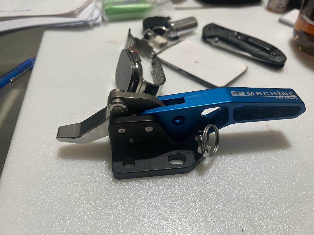

Next up was to replace the latch on the rear bumper. Outgear Solutions announced this a few weeks back and I jumped on it. Expensive but so much cleaner than the original latch...

Haha whoops. It is really nicely made, but man I hate how expensive it was lol. I already had to replace the original latch last year and this one was getting so rusty and worn. The replacement latch alone is like $50-100 itself, so I decided to just bite the bullet. You will like it though, its well done.
