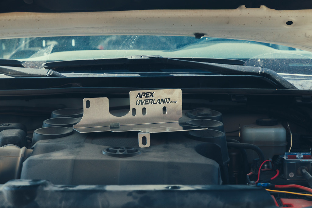

Tackled some small changes today. This accessory tray from Apex Overland showed up today. Wanted to clean up some of the wiring and a secure mounting spot for future additions. Shortened some of the excess wiring, and tucked it nicely under the panel. Now I want to get a battery terminal upgrade to clean up the wiring on the battery side.

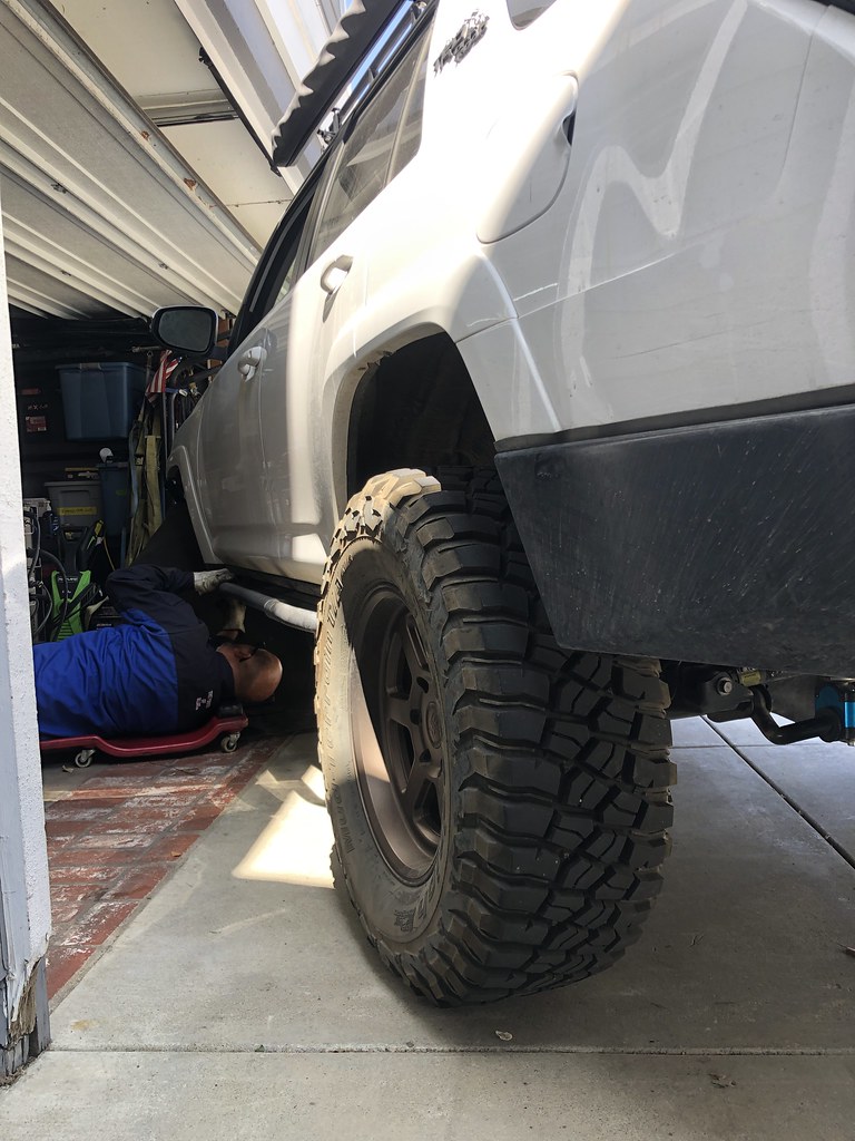

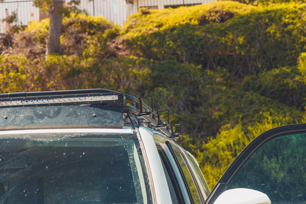

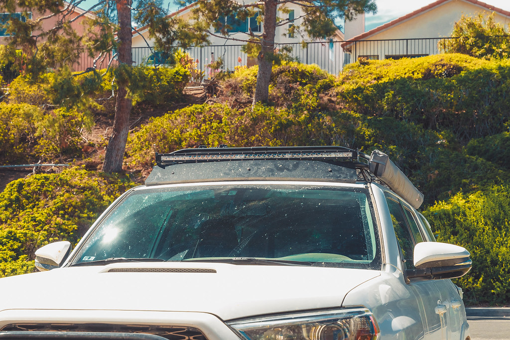

Yes I need a car wash, but mounted the new roof lightbar yesterday. With it being a slimmer bar, it mounted a little high and left a gap between the wind deflector and the light bar. Looked funny to me, so I dropped the bar down a bit so it sit more flush, although the brackets on the edge do kind of sit higher than the bar unfortunately. Still looks better imo than the big gap.

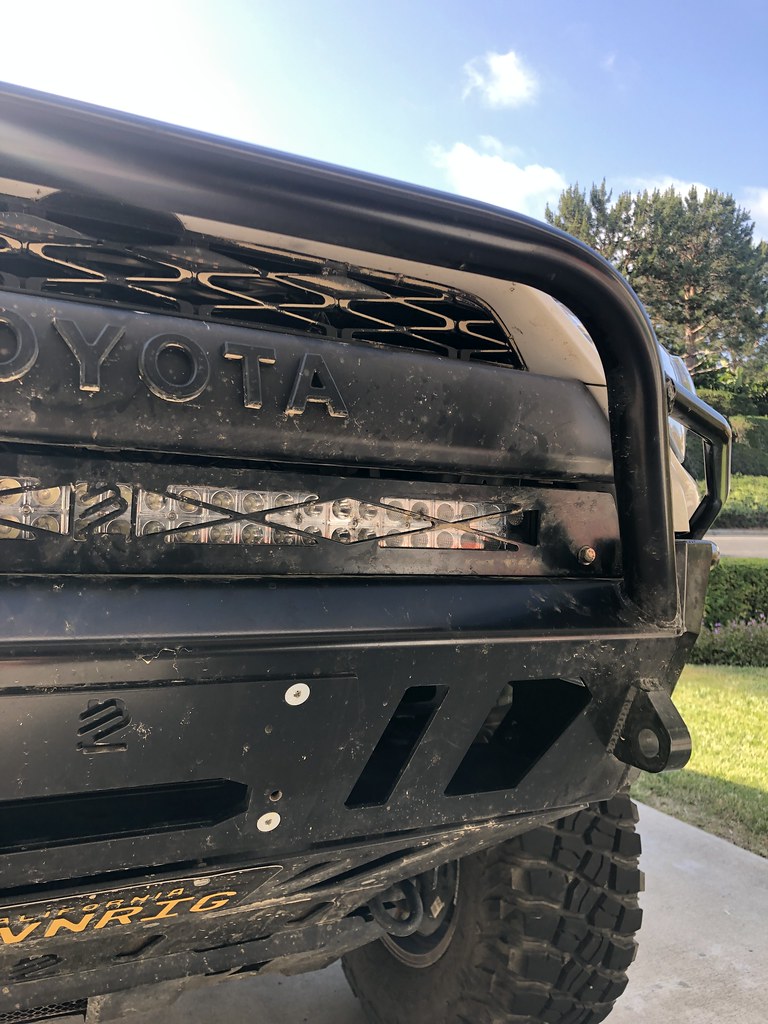

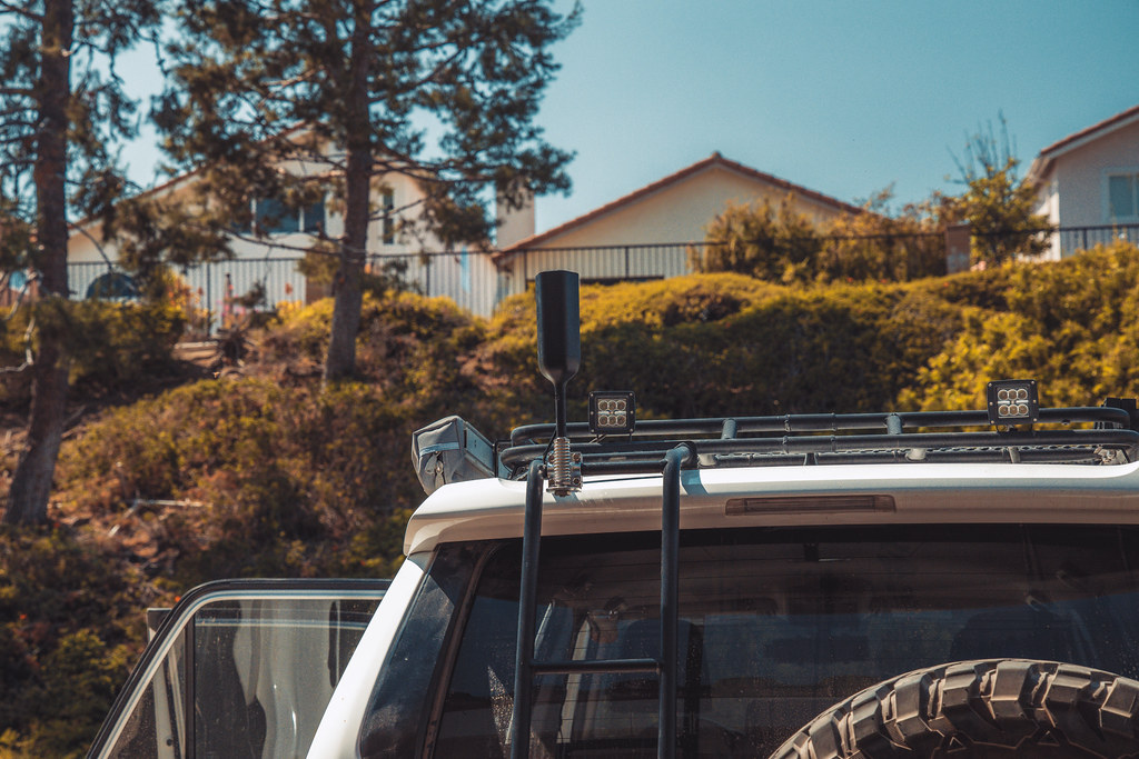

Had my old bumper light bar laying around and figured I might as well add it back in. No more lights lol.

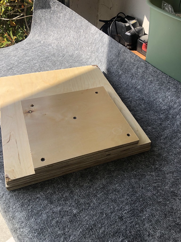

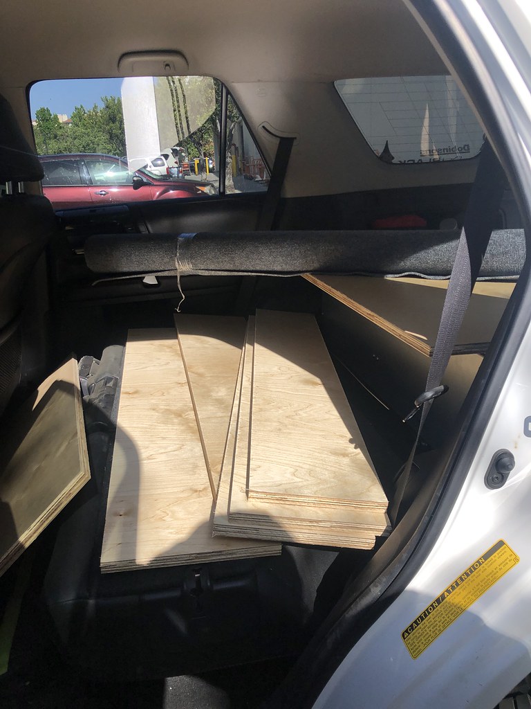

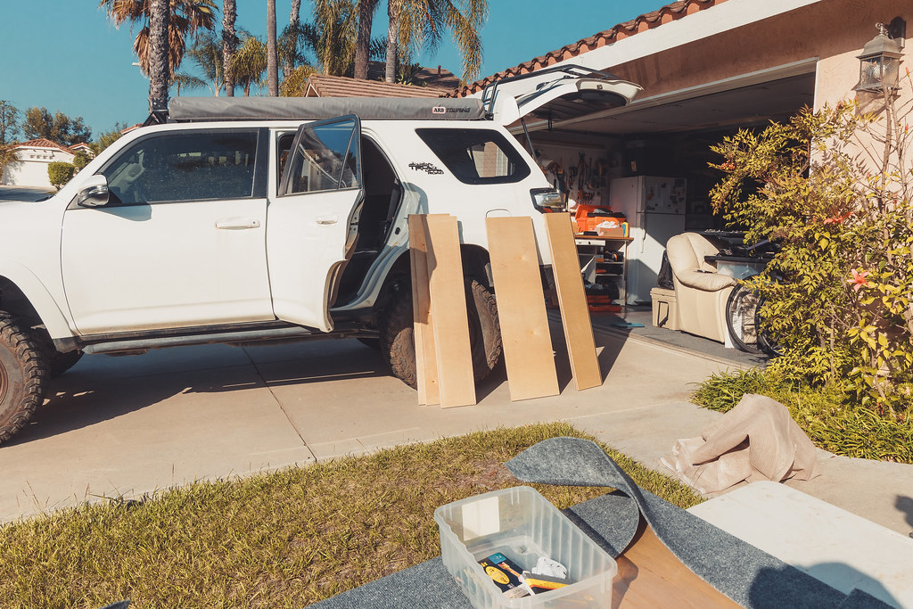

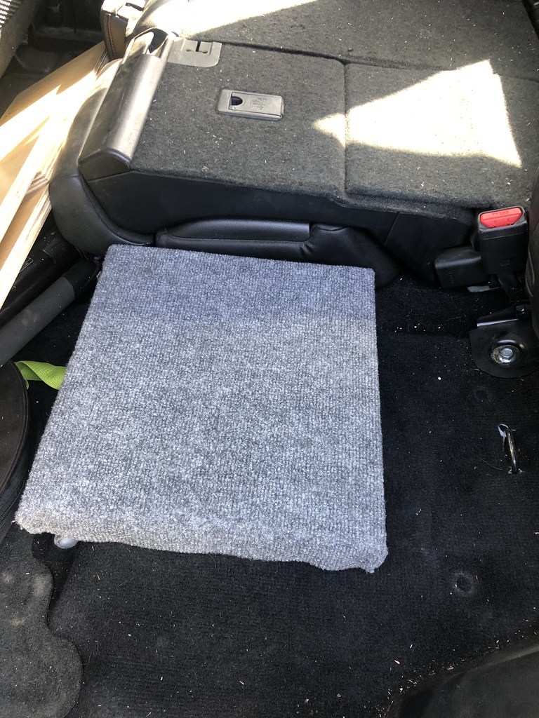

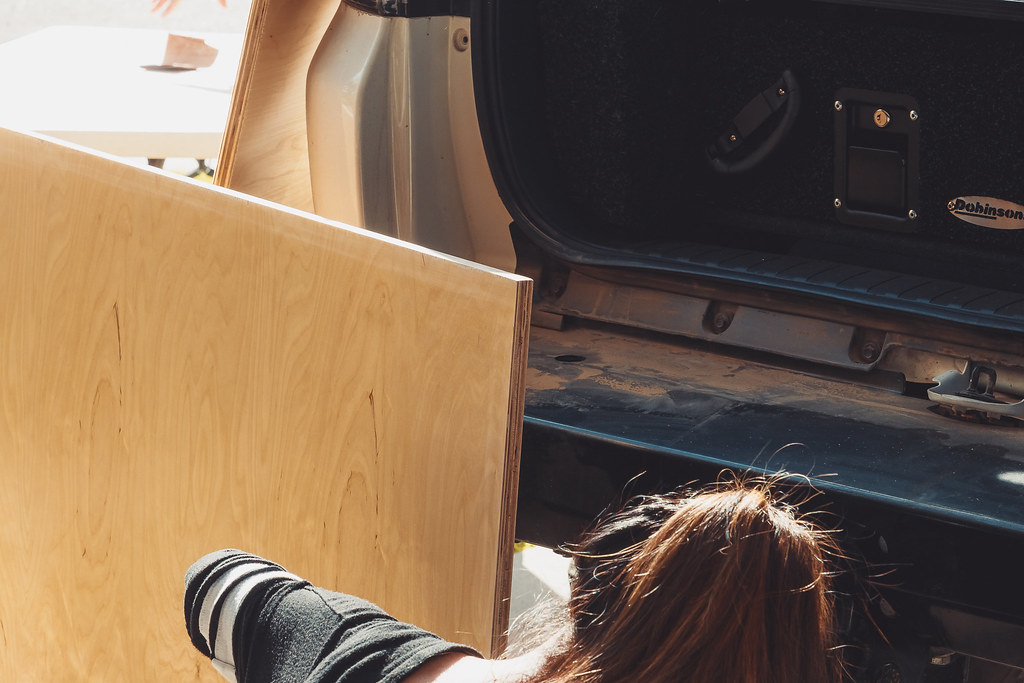

Today has been super busy. Got a late start but ran to get the materials needed to finish the extension to turn my drawer system into a sleeping platform. After a few designs and going back and fourth we settled on a rough plan and wanted to get the materials to at least be able to visualize it better. Well that turned into deciding just to build it and we knocked it out in a few hours and total cost was under $100.

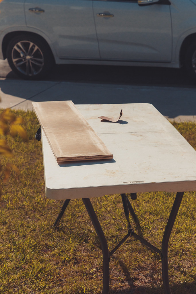

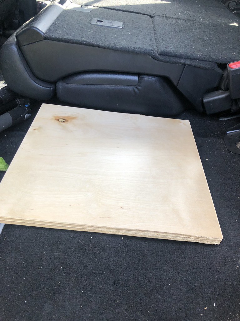

Had Home Depot make the cuts for us, which saved a ton of time and work. Picked up some carpet to wrap it in, although we wish we had gotten black, but they did not have any. We didn't think it was too far off, but you will see later that it doesn't match. We are likely to end up dying it darker, but it really doesn't matter.
We got 3/4" ply, and the surface was already smooth, we just went around and sanded the edges from the cuts and the sharper corners.

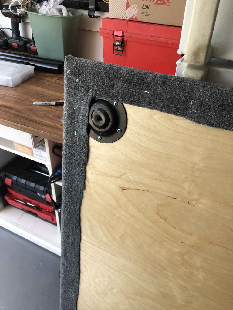

The girls began putting the carpet onto the platform. We sprayed down some adhesive and then stapled it to the underside as best we could.

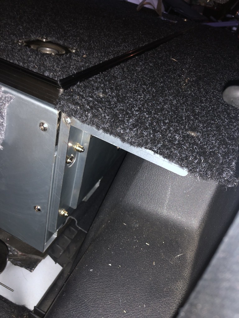

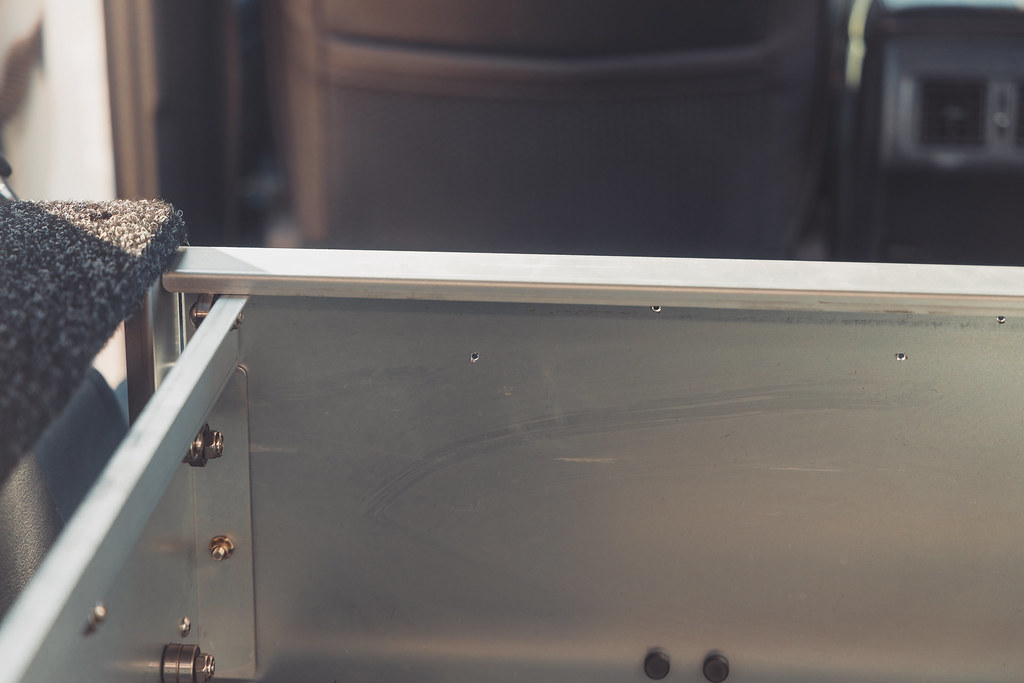

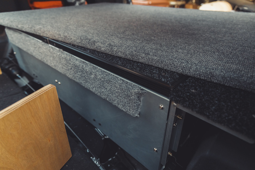

I began drilling some holes through the back of the drawer which would allow us to mount a lip for the platform to rest on. Didn't worry if they were even, putting enough to make sure it was solid was all that mattered.
I had them add some carpet to a small strip of wood which would become the lip for the platform to rest on. Not perfect, but it is completely hidden when the seats are up and covered with the platform.

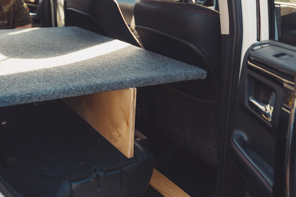

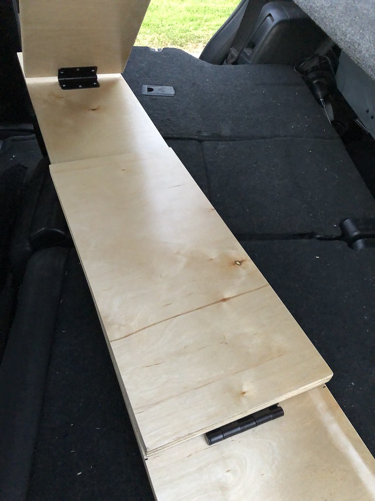

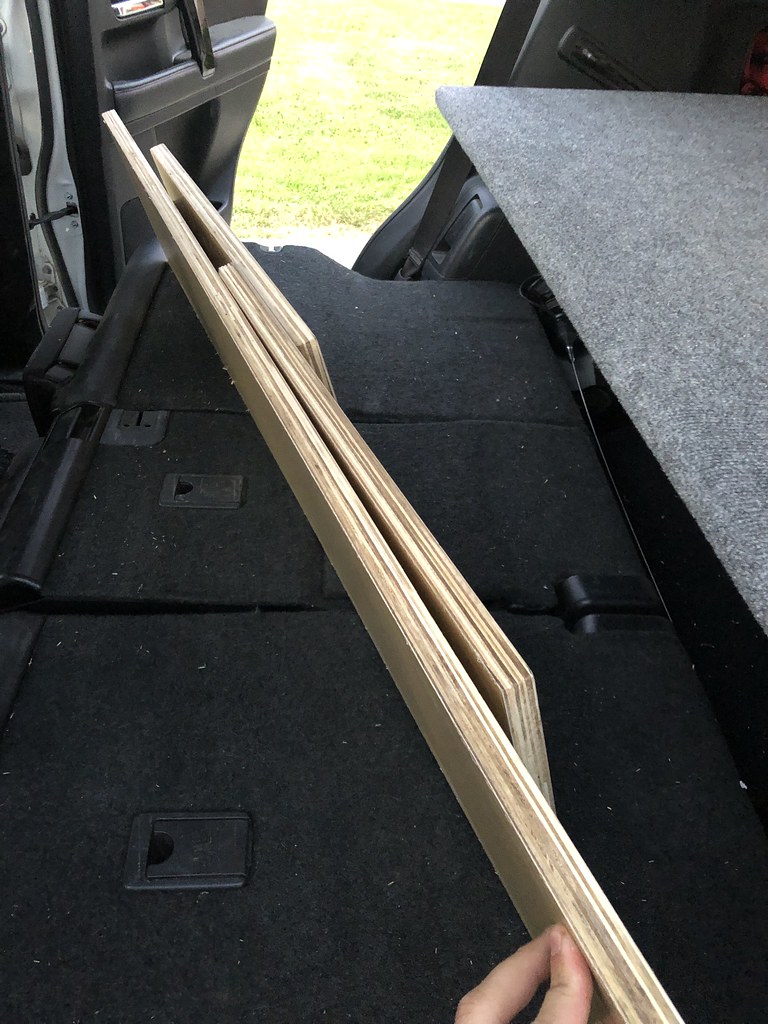

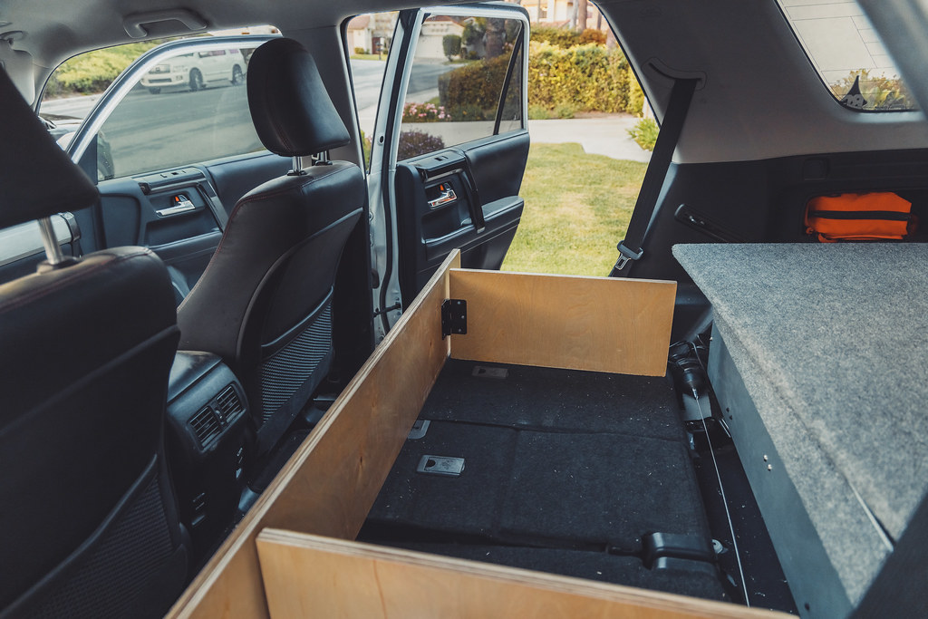

With the lip on it gave us a starting point to measure and fit the support. With the seats squishing down with weight it made it difficult to calculate it perfectly without having it in there and experimenting.

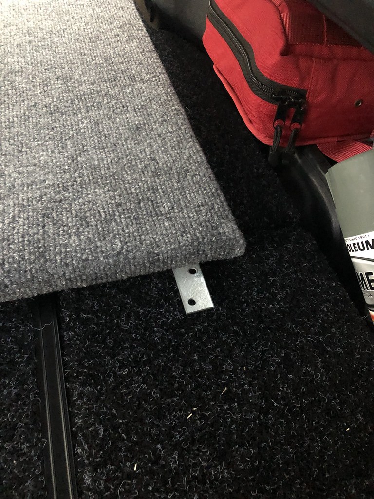

Originally we were going to go a "T" shape support like many of the other DIY systems. But with our Dobinsons drawers being taller than other drawers, we felt it would be better off adding a little extra support. Our support "beams" are 9" tall, and with two people in and out moving around we didn't want to shortcut this part or have a wobbly bed. We were also concerned about getting in and out of the car through the side doors, and it tilting or breaking off on the corners. The lip is there so it doesn't move and was not originally planned to actually support the weight.
One drawback to having two hinged supports would be that it wouldn't fold flush or it would be too bulky. After putting the first support on, we mocked it up and realized it hardly took up more space and still folded down nicely.
I don't know if these were the best hinges for this application, but now that it is put together they are fine.
So with a gap with no support on the front most part of the platform it had a tendency to want to tip when weight was put on it. For a quick solution, we mounted a small straight bracket on the bottom side of the platform. This would slide under the corner of my dobinson drawer and prevent it from tipping forward. This is only temporary as we have decided to probably add two legs from the bottom of the platform to the floor of the rear seats. Having built the platform we can now get a better measurement of the leg height we need. We found a set of table legs that should get us close, and will be ordering those to hopefully finish this off. Ideally we are also going to figure out an anchor system to lock it down so it doesnt move too much when offroading. Although it is fold-able and removable we don't have to have it setup until we get to camp which is what we wanted.
Here is what it looks like from the back. As you can tell the colors don't match but hey function over form.
Side view
When not in use or when you want to remove it, it actually sits so perfect on top of the dobinson drawer. Folding up the rear seats prevents it from sliding around and everything can be loaded on top of it. No issues while offroading or it shifting! Then the support boards either can go on top and be held down or on the floor.

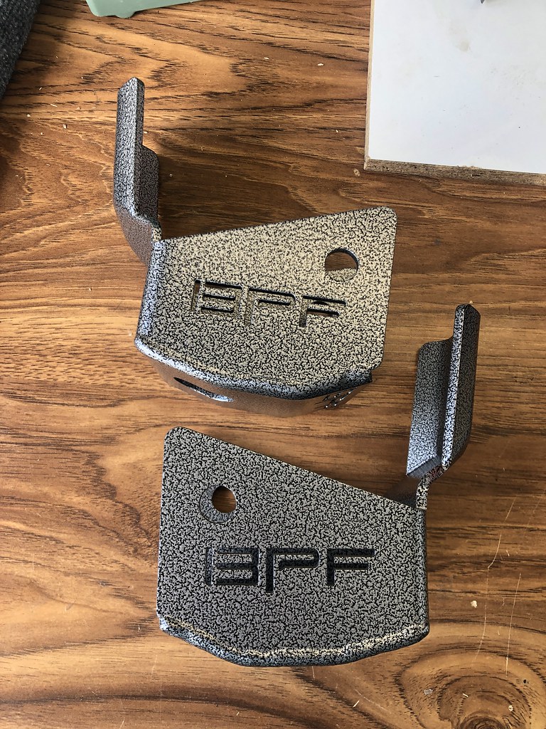

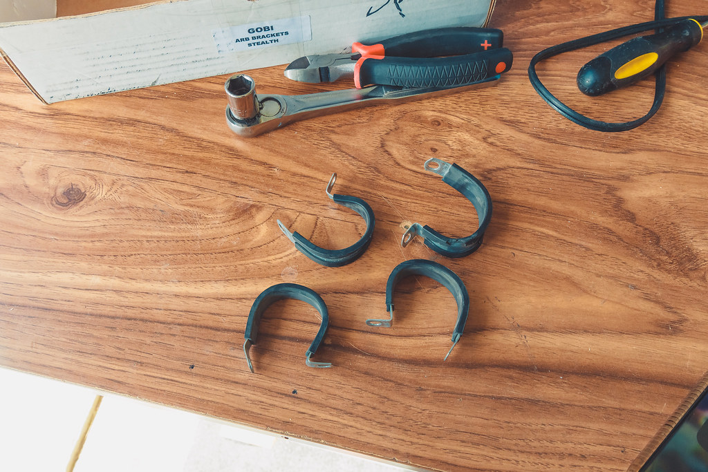

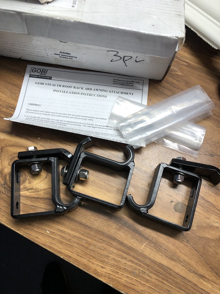

By the time we got back from the store, these were waiting for me! Finally a proper set of awning brackets for my Gobi rack. Luckily came across a used set to save some $$ and avoid the horrible lead times from Gobi. It was two weeks after placing the order that I eventually got a phone call to confirm my order, and who knows how long for them to ship after that. Timing on these couldn't have been better!

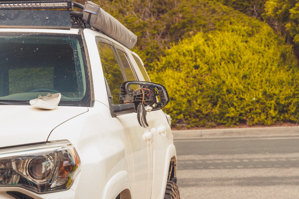

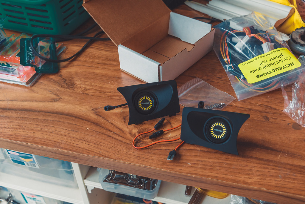

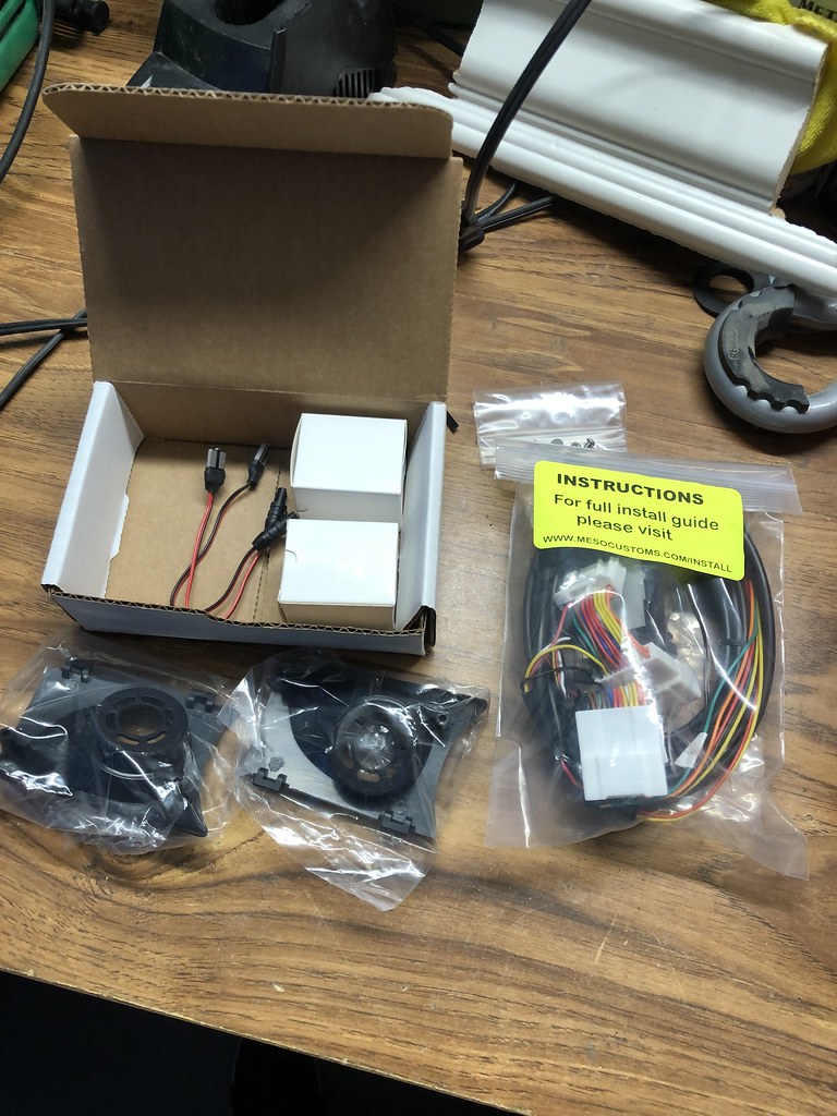

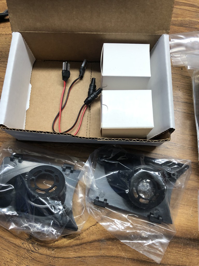

Started by tackling the Meso Customs puddle lights. These things look sweet!

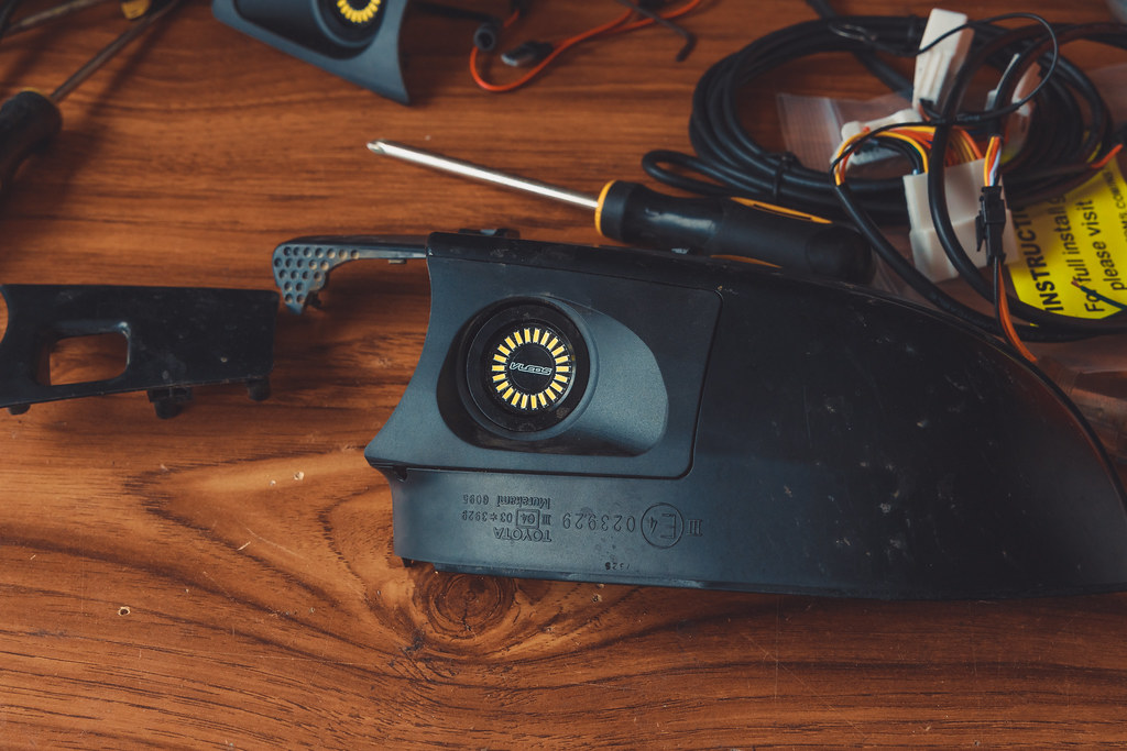

Took a few minutes to get the mirrors apart. Sounds terrible when you are undoing it but easy to do.
Swapped the oem lights out for the Meso lights.

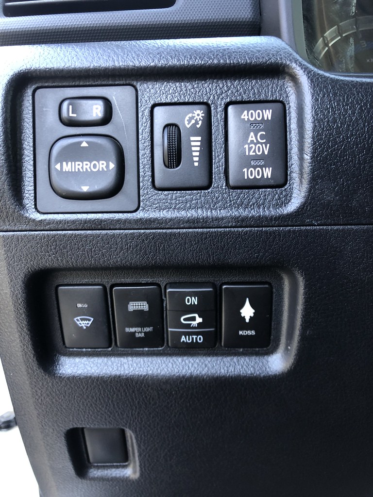

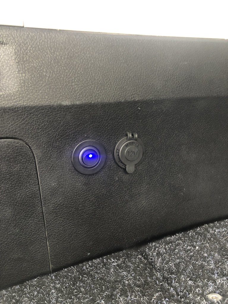

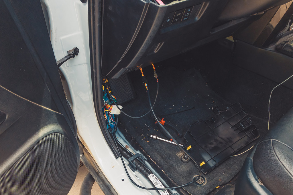

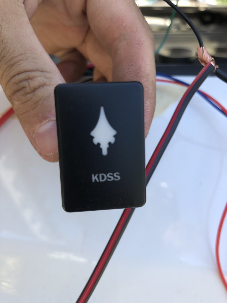

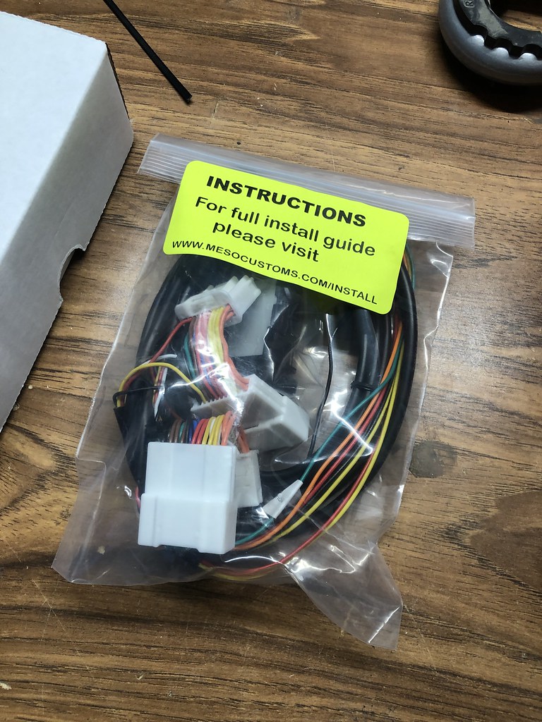

Mirrors took a few minutes, then it was onto the wiring kit with the switch. Easy plug and play, hardest part was just tucking the wire under the carpet.
Button added in. While I was in there I swapped some of the buttons around. Took the old wiring harness buttons in and filled them in with blanks. Moved the inverter button up top because it is hard to tell when its actually on from the lower spot. Bottom row will be for the lights.

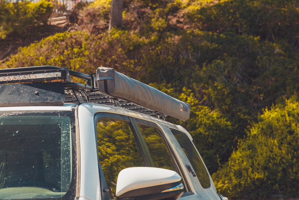

Wrapped it up within 20 minutes or so, and moved onto the awning brackets. These are what I am swapping out them with. While it worked, it was not solid.
Only have a 6.5' awning, which only needs 2, but since I got a set of 3 might as well use them. Will also be nice since we use the awning room with it, can never have too much support!
Solo mounting it was a challenge. Feel like it needs to be adjusted and slid forward but that's for another day when I have a second pair of hands.

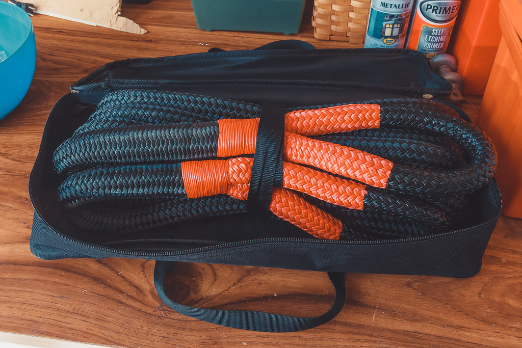

While I was doing that, my kinetic recovery rope got delivered! Now to find where to put it in the car.

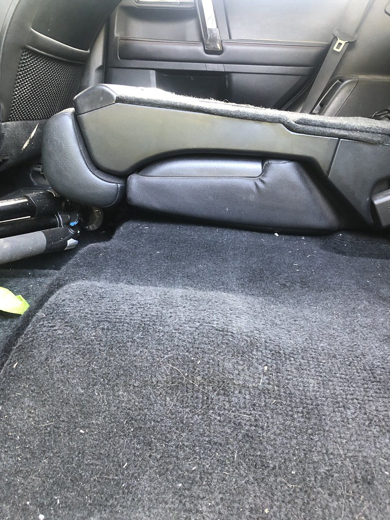

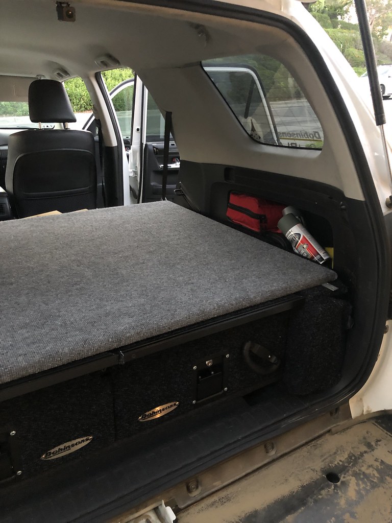

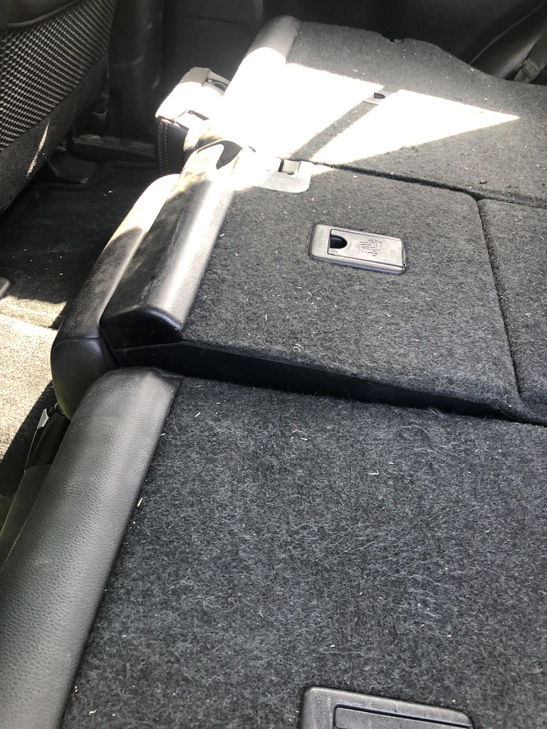

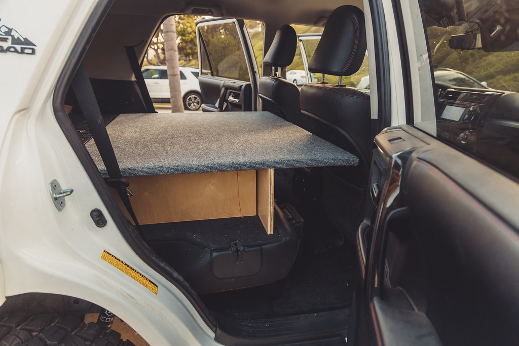

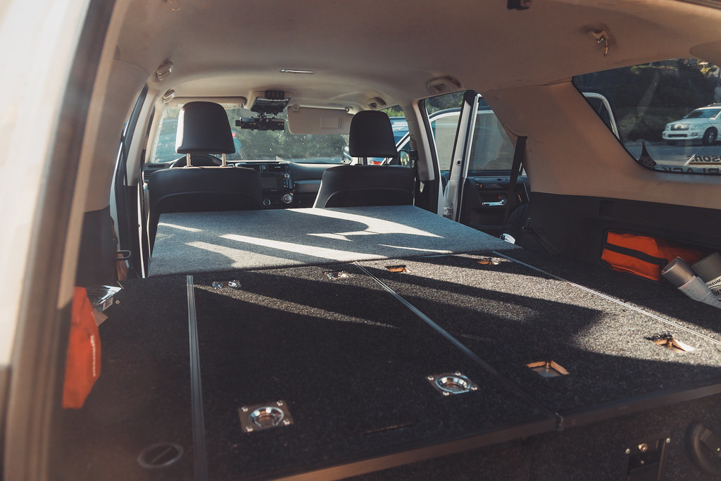

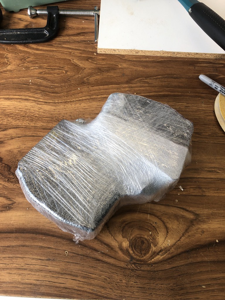

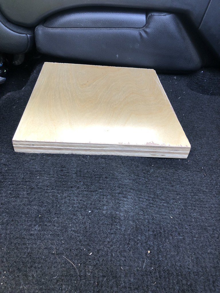

Winding down the sleeping platform build. One issue we noticed while measuring and building is that the drivers side rear seat actually sits lower when there is weight on it. This caused the support to not sit level.
Lifting the seat, there is a raised portion of the carpet closest to the door. There is nothing actually under it which means it compresses when you push on it.
I placed a small piece of leftover wood right next to that hump.
I then stacked a bigger piece that fits perfectly over that hump. After some trial and error, it took 3 total pieces stacked to get it to sit level.
Three pieces screwed together.
Used the leftover carpet from the platform and wrapped it up so the wood would not damage the seats. When not in use it tucks away easily. Should hopefully be able to wrap up the final steps this week by adding the legs. Who knows, I may not even need this in the end.

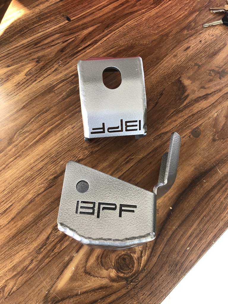

In the afternoon, this showed up!
Decided to quickly spray them with a metallic silver and I am glad I did. Small change, and totally unnecessary but I dig it.
Hopefully will throw them on tomorrow!
Easy install, took about 5 minutes! Hardest part is getting your hand to the tire side of the bracket to thread the nut on if you have big hands. While I was there I cleaned the shock, had some dirt and dust built up on the shaft due to the dust cover slipping up. Ended up putting a ziptie on them to make sure they stay put.

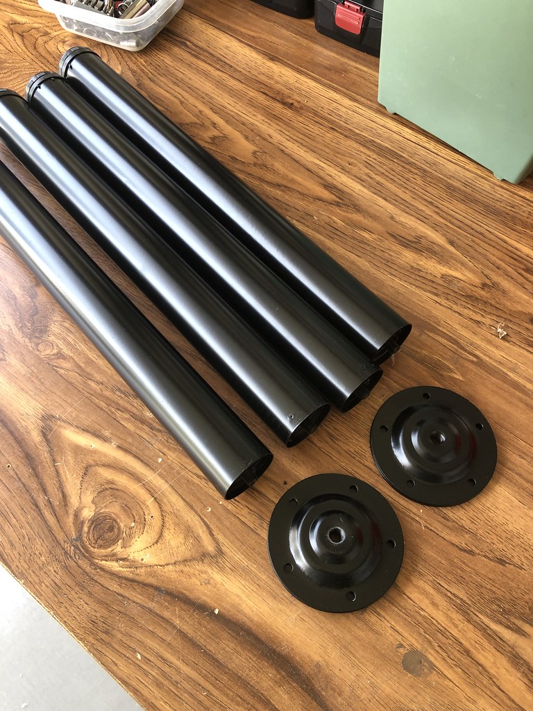

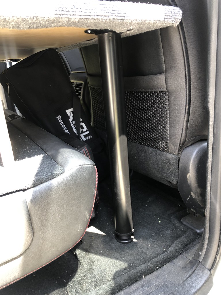

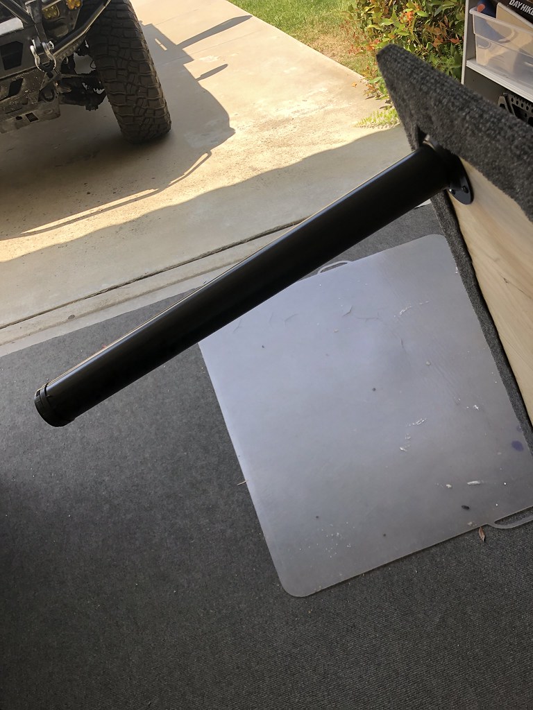

Found these legs on Amazon which should complete my sleeping platform build. With the wood support in the middle, the corners closest to the doors did not have much support. Having the rear swing out, we usually use the side doors to get in and out and this would cause the platform to tip if too much weight was on the corner. After considering a few options, these seemed to be perfect. Didn't take up too much room, and are easily screwed on and off for storage! They also have adjustable bottoms and happened to be the perfect height with room to go up or down.
The mounts screwed into the bottom of the boards.
Legs screwed on outside of the vehicle.
Here is what it looks like inside the car.

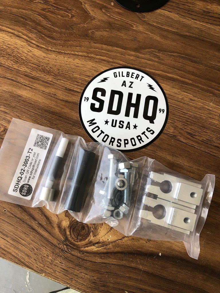

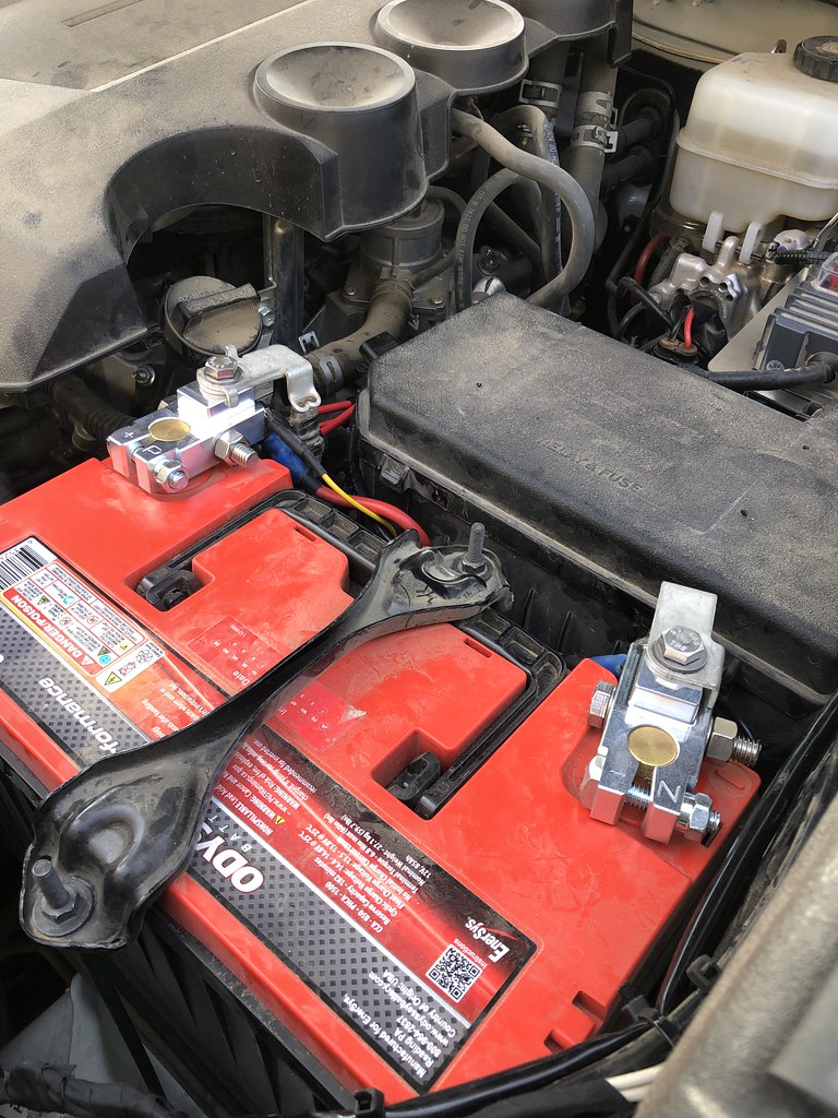

From there I began to swap my old terminals to new SDHQ billet terminals!
Before. Yuck
After. Tucks away most of those ring terminals and easy 5 minute install. Oem cables fit perfectly, no need to do any modifications to the cables.

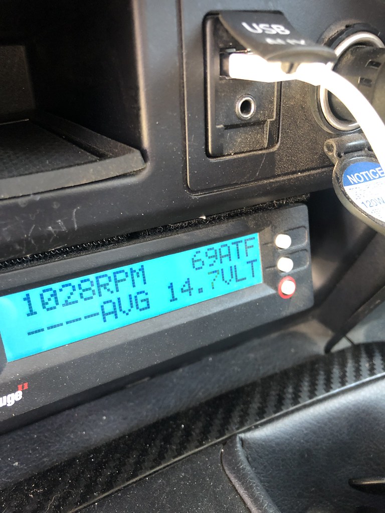

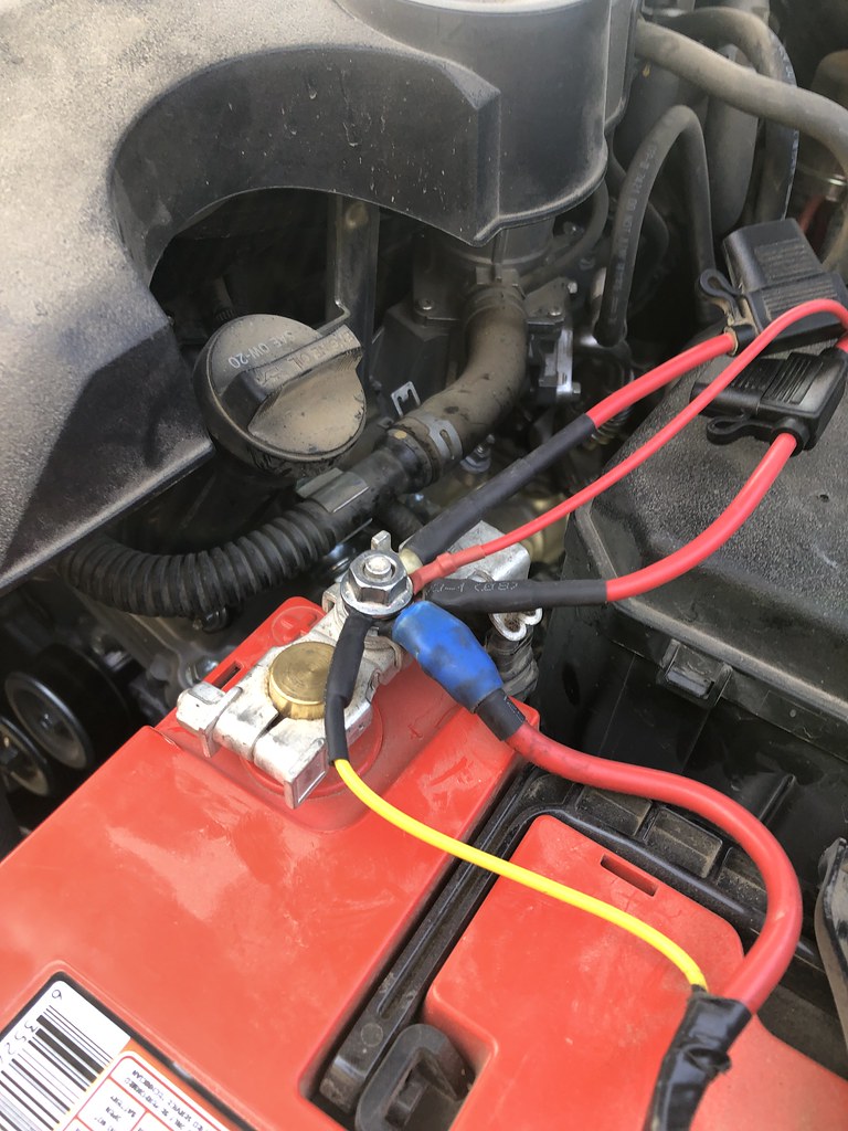

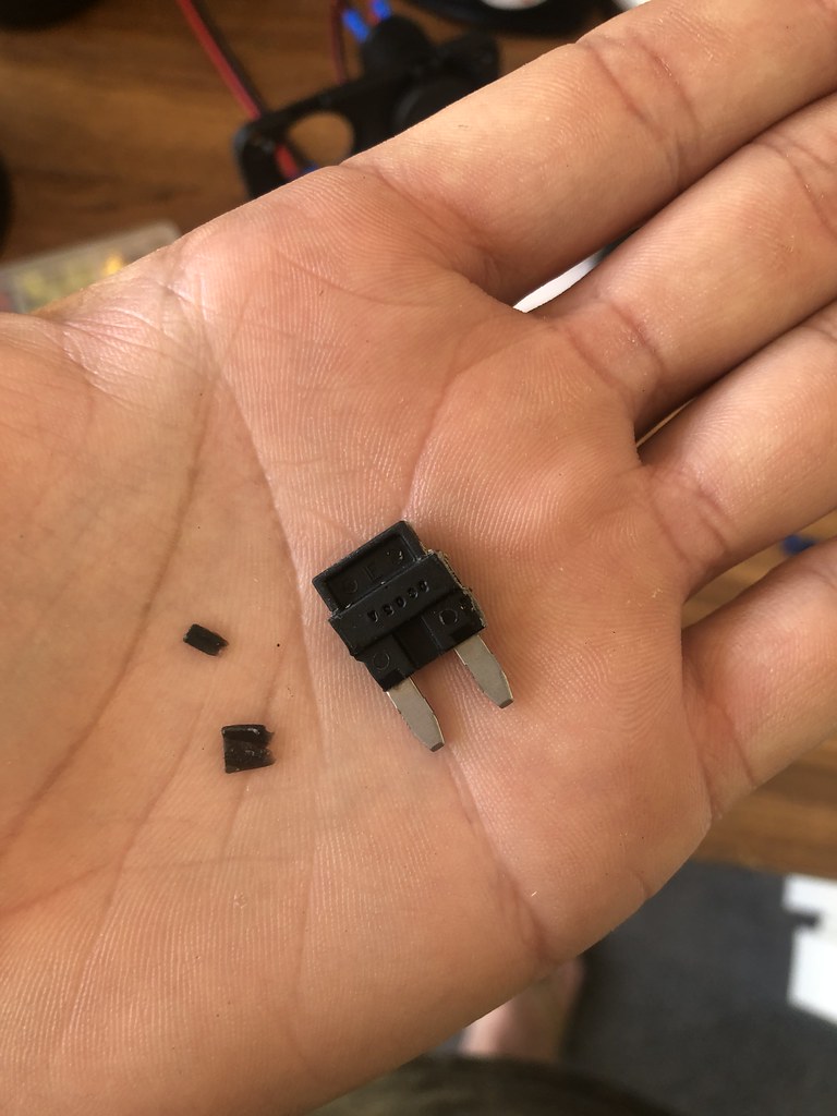

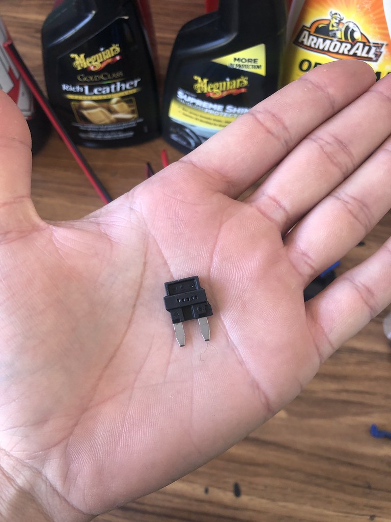

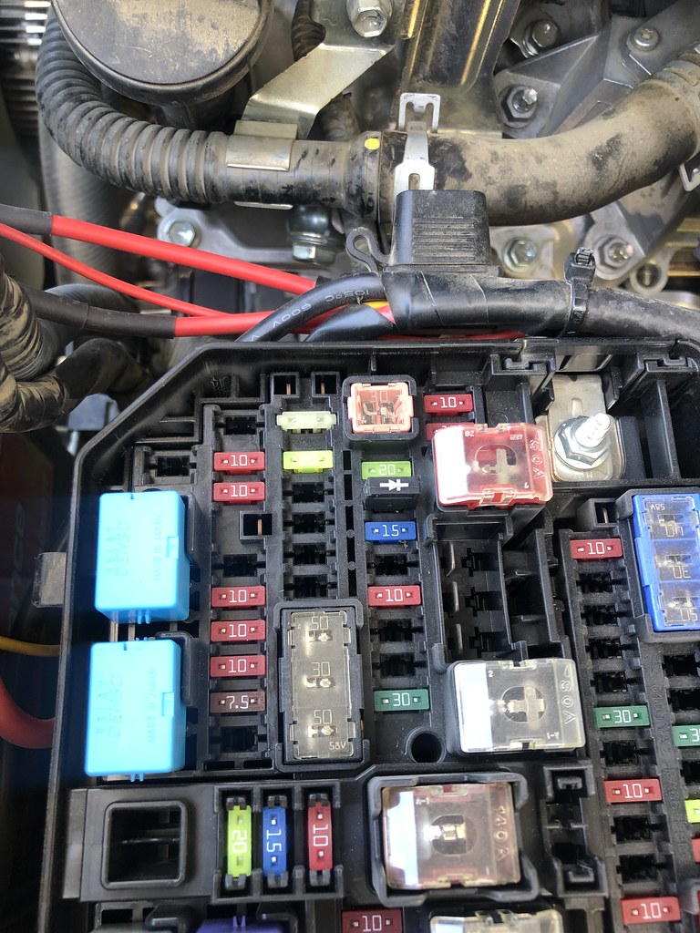

The other day I was researching alternate ways to power our fridge as a backup to our Goal Zero. I came across THIS .
So I picked up the GM fuse.
Began to shave down the sides to fit.
Swapped it out for the other fuse.
Cold start, 0.7V gain from before putting it back into the ideal charging range per the battery.

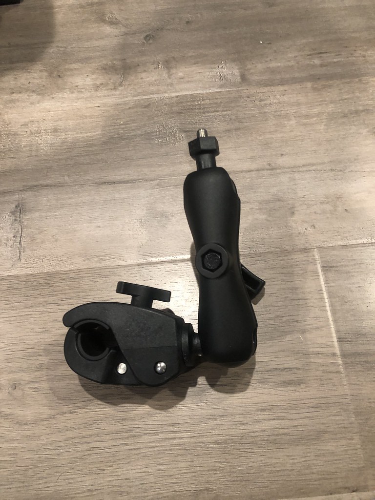

Onto the next project. Got a ram mount for the WeBoost so I can have some overhead clearance and still have a tall antenna.

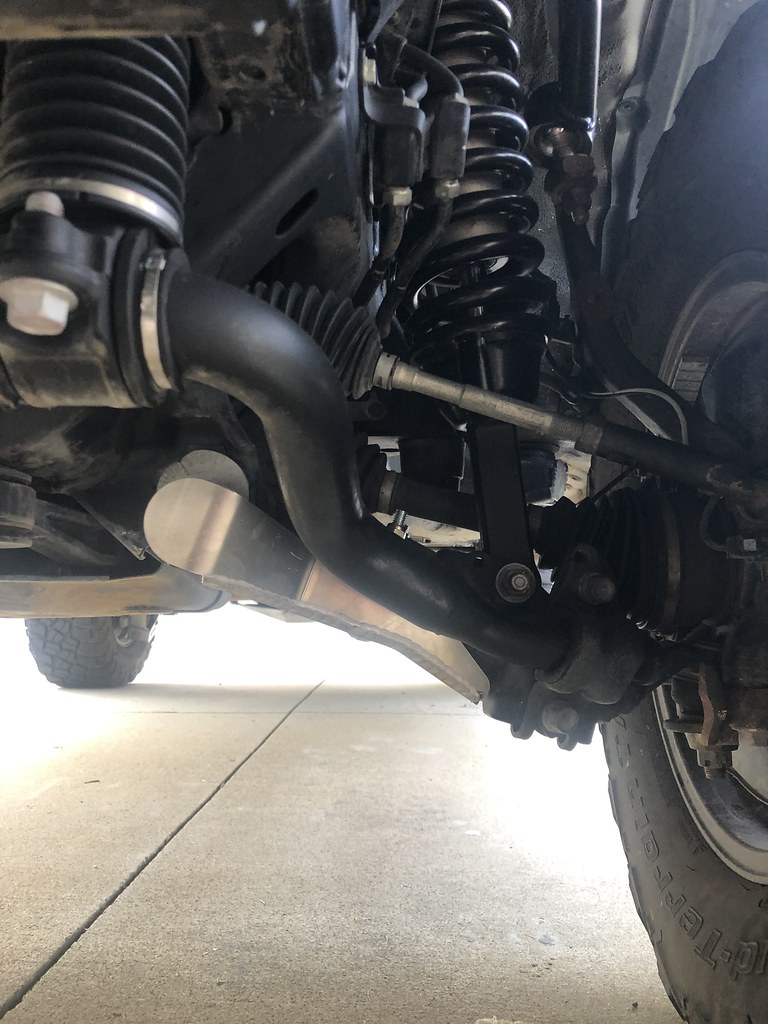

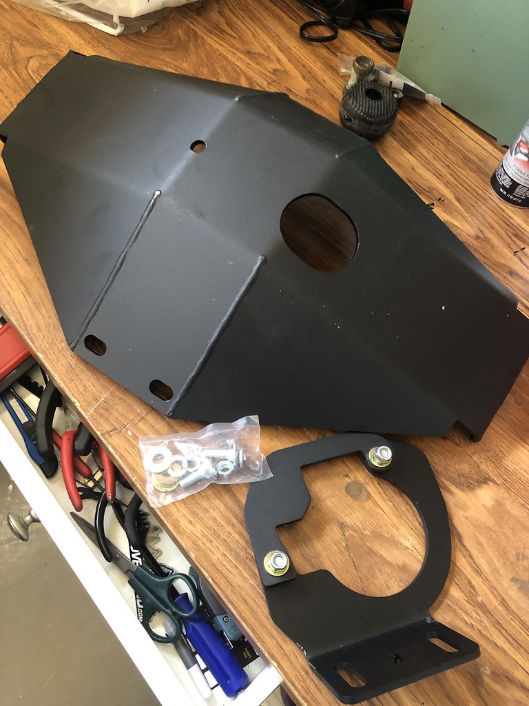

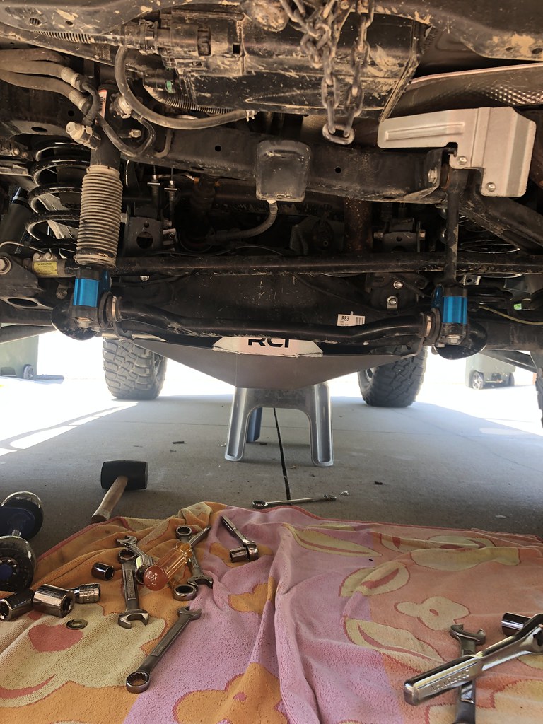

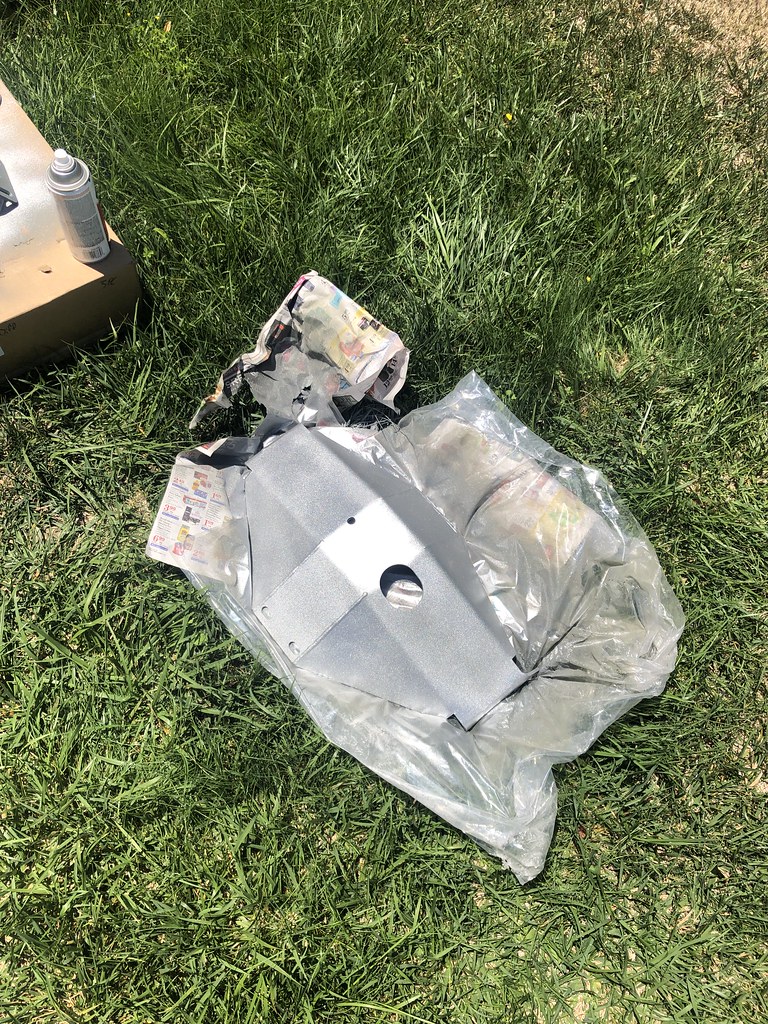

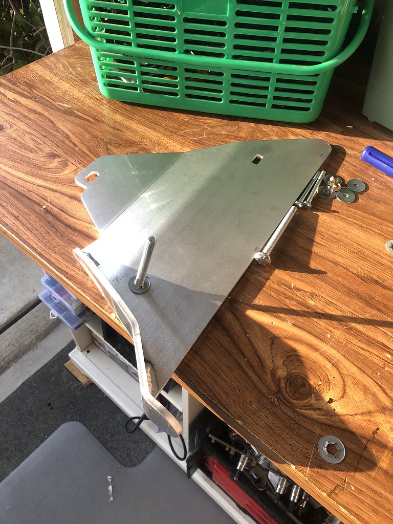

Back in April I placed an order with RCI, and yesterday one of my items arrived, my rear diff skid! I was super excited until I got outside and saw the gaping hole in the box. Was worried it would be damaged/missing and have to wait another two months for a replacement. Thankfully everything was still inside with only some minor blemishes. Not a problem, as long as everything was there. It would get scratched up anyways and I had plans to paint it.

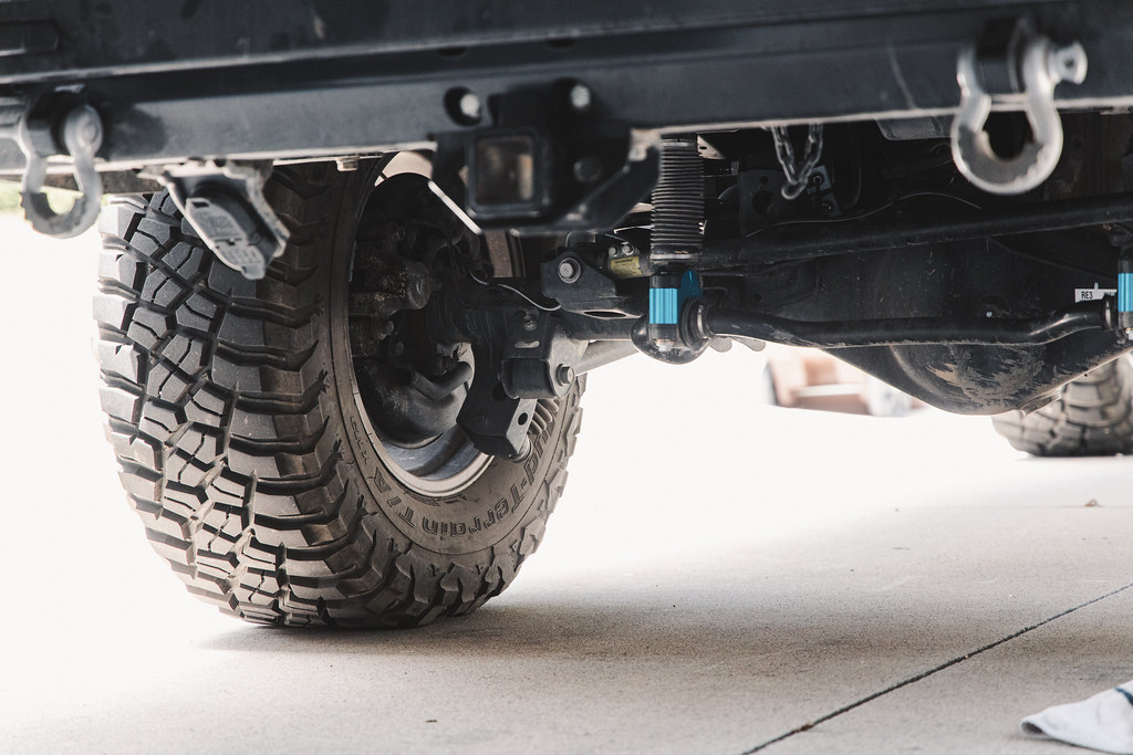

Been digging this metallic silver paint I had from my rear shock skids, and my C4 battery tray, so I figured I would make it at least look a bit nicer until it eventually gets its trail beating. While it pops so much in the sun, under the car it becomes much more subtle.
Doing it solo was a bit tricky, as the rear sway bar mounting brackets were slightly bent and needed a bit of tinkering to get the skid plate to slide in. Eventually got it on, and happy to have a bit more peace of mind/protection.

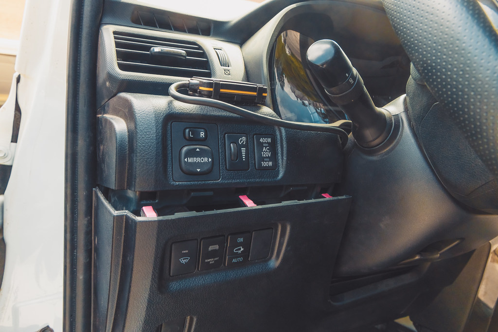

Another small update. Been on the water more than the road lately and have put the car on hold. For the last few weeks I have been anxiously waiting for Blackgate Customs to drop their KDSS control kit. I happened to check last week and saw it was available, and ordered it! Within 2 days it was here and getting installed! The actual install of the wire harness was easy. Two bolts holding the KDSS cover on and it clips right in, a few zipties and run the wire harness to the engine bay. I am not that experienced with electrical so I got a bit stumped on the wiring the harness to the relay and switch. Thankfully Blackgate was extremely helpful and responsive after I reached out for some clarification! To summarize what he explained and to possibly help anyone else in the same situation...
If using the factory switch: The two wires from the harness will be connected to the red and yellow on your relay. The black relay wire will be ground, the white relay wire goes to green on the switch. The blue relay wire will be used unless you wire it in reverse. Using the blue wire as the main/hot will default your KDSS to off. On the factory switch, the blue is for the backlight LED and wired to the headlight as shown on their instructions/website. The black wire needs to be grounded and can be done in sequence or individually. Red for the switch is power.
I opted for the factory style switch.
All done!

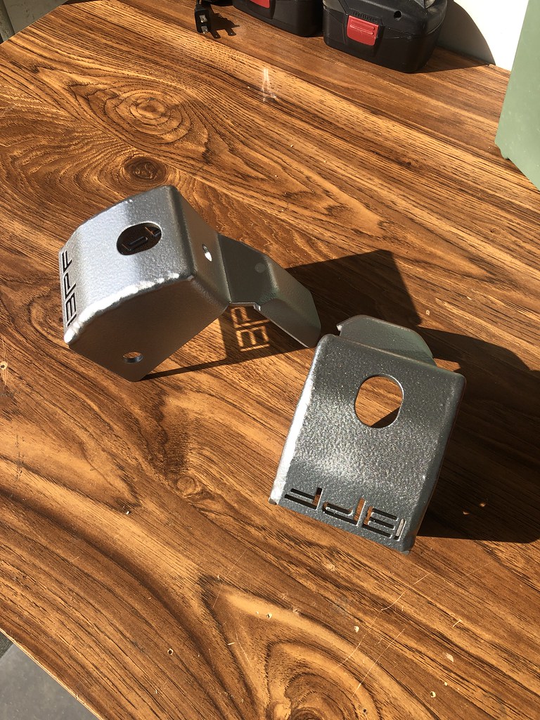

Starting from where we left off. Got my RCI a-arm skids and installed those.

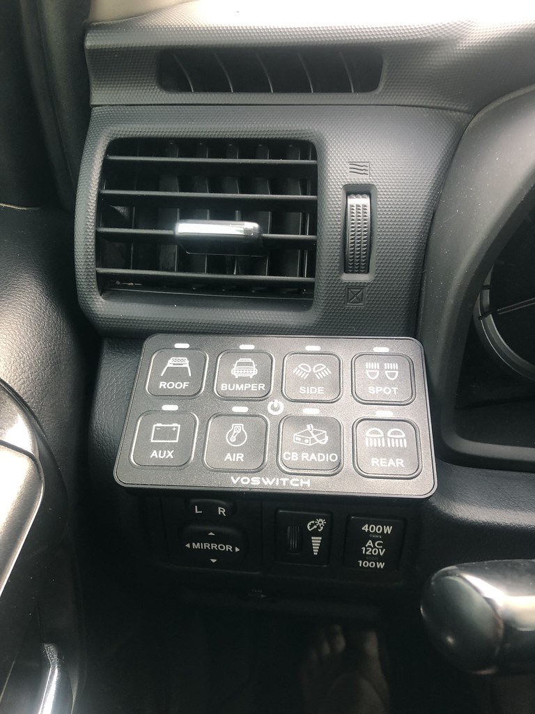

Switched the Trigger 4 plus controller to an 8 gang setup that didn't break the bank. The Voswitch setup got the job done and so far zero complaints! Finally have more than 4 buttons. The panel is quite large, but I don't mind it the more I use it. Yes, I fixed that cb radio button that is no longer off. :p

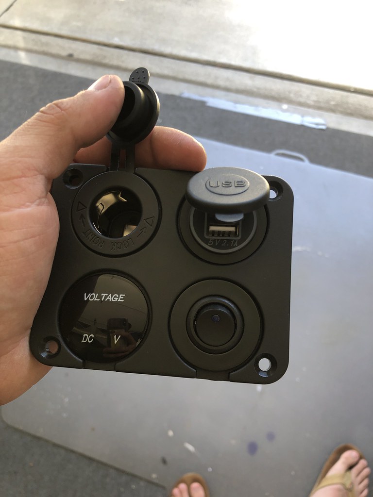

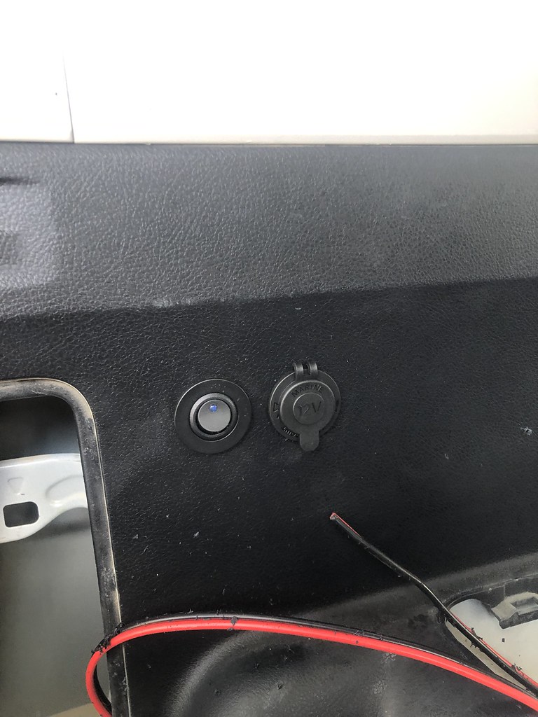

Really been wanting a constant 12V supply for the rear and finally had some time to do it. This will be helpful to plug the fridge into on trips as well as our other devices if we need it!

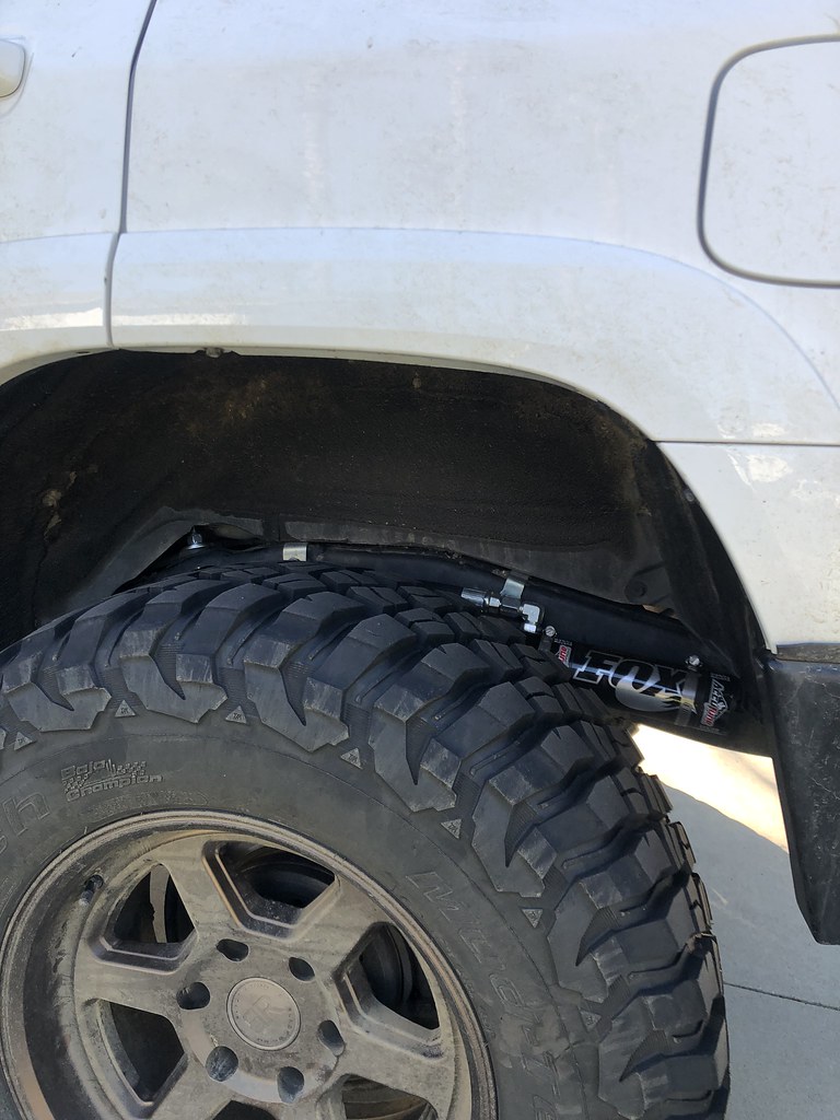

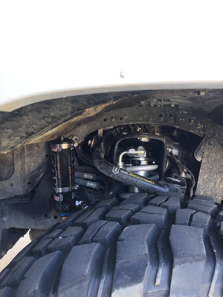

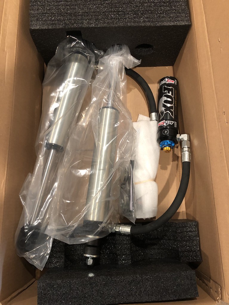

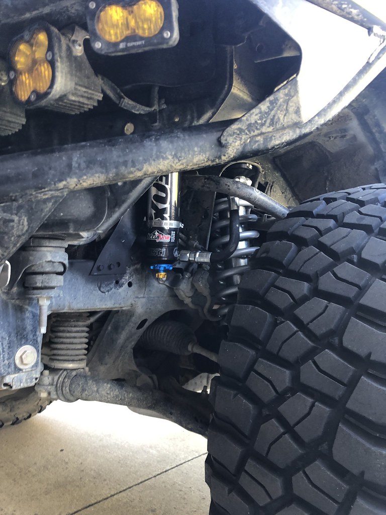

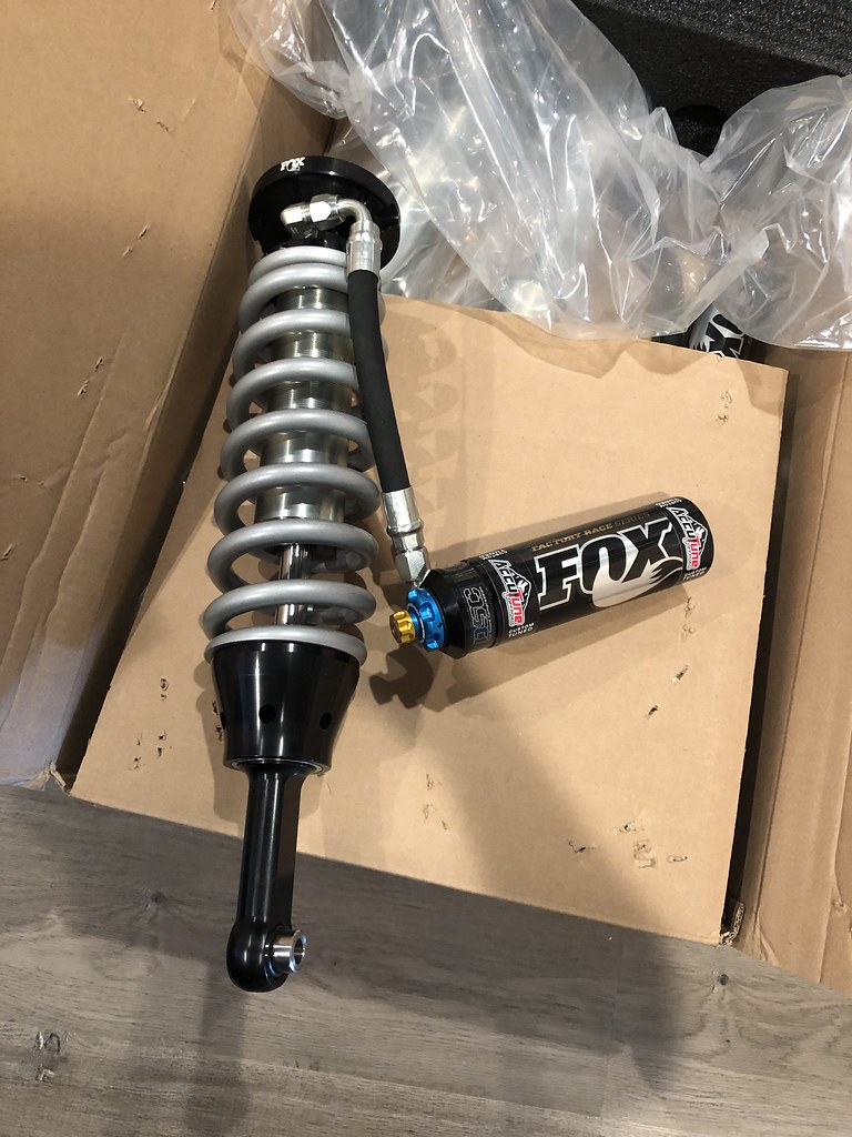

Probably the biggest and most exciting upgrade was the Fox 2.5 remote resi's w/ DSC's! Ordered these back in October and just this week got to put them on! Custom tuned by the helpful people over at Accutune and man do they ride amazing.

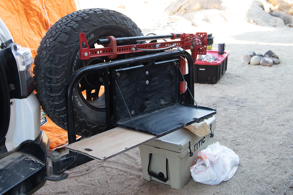

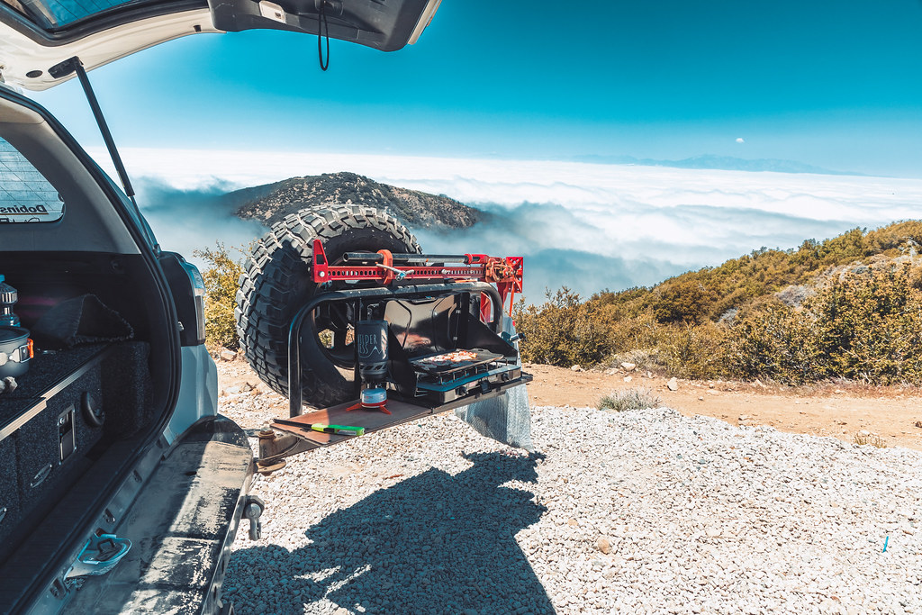

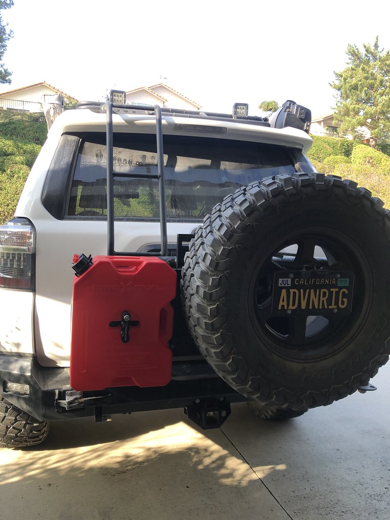

excuse me kind sir.. but how did you install that front runner table to your shrockworks rear bumper?
I've been looking for a way to install a table to the shrockworks rear bumper and i'm super stumped.

I found a picture that may help explain. I basically used a bracket behind the table to reinforce it since its quite flimsy. From there I mounted it using the existing holes in the shrockworks bumper and some oversized washers/plates to keep it in place. They don't make it easy to mount tables and have been changing it every so often.
dood thanks for the pic man...yeah..the only negative for shrockworks is the inability to easily install a table.... otherwise love the bumper.
FYI, awesome build btw...
Thank you! Hopefully that pic helped haha it was just a DIY sort of thing. Personally not a fan of the shrockworks bumper, but maybe they have been improved since I got mine back in 2018. I feel like there are better options out now a days.
