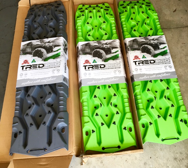

Secured Grey

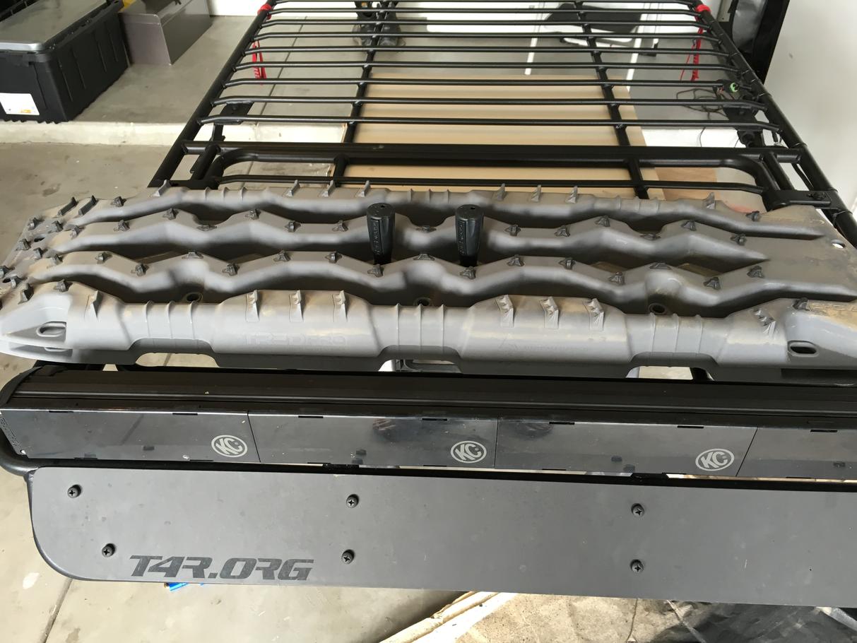

Got Em.
Although, the green makes more functional sense to have and looks better.
Super happy with the grey, it matches my boring life/personality. The 2 green were returned.
I cannot stress how well made these TRED PROs are made. Top notch product and company.

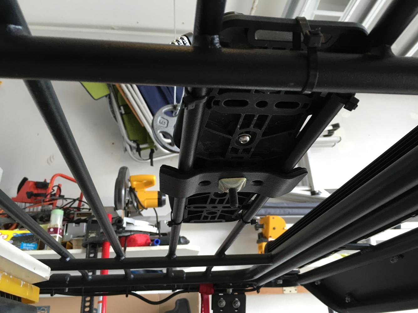

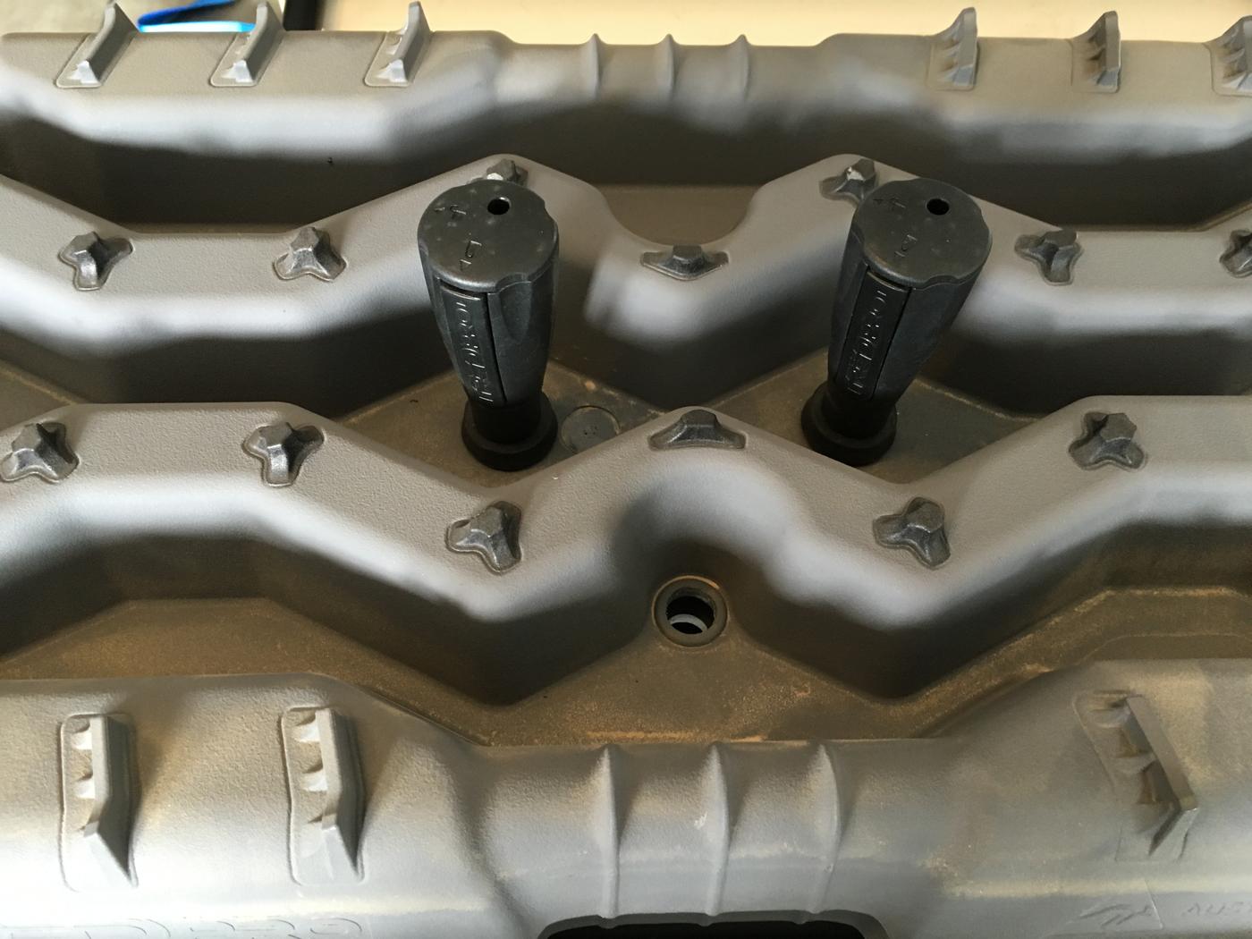

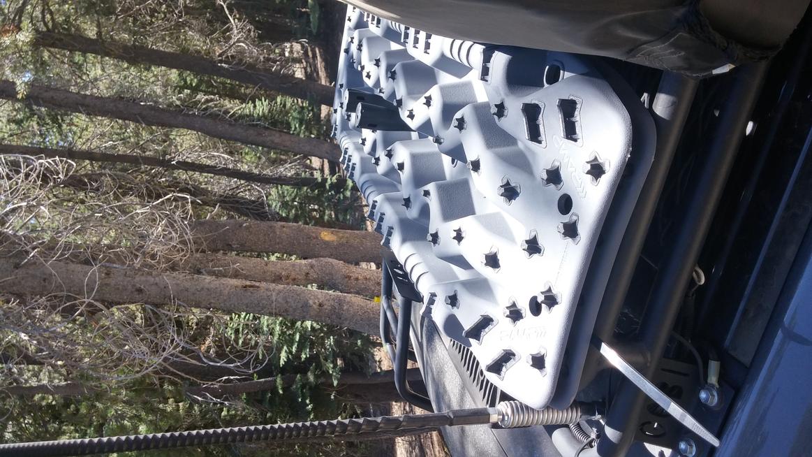

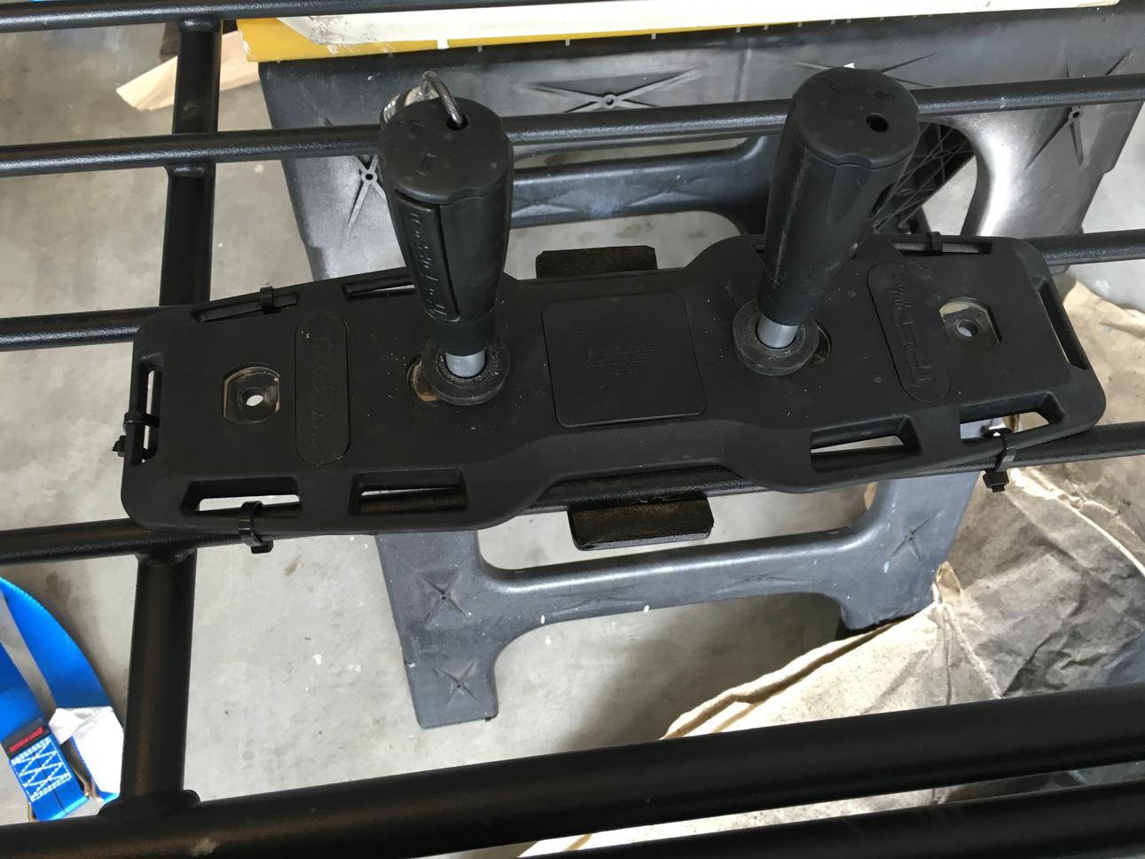

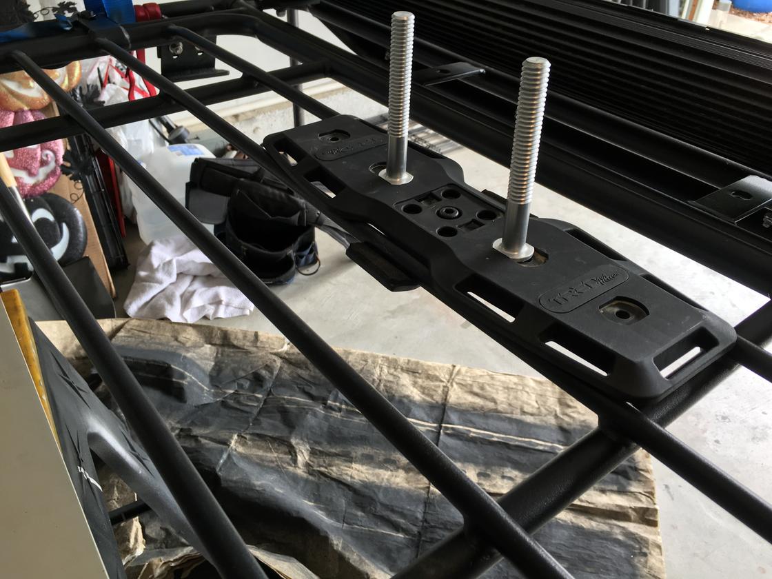

I took my Baja Rack off today to do some touch-up painting where my FourTrek awning mounts scraped the powder coat off the rack. It is certainly much easier to mount accessories with the rack off, so I thought I would post a few pics of the Treds mounted to a Baja Flat Utility Rack.
I bought the Treds mount and I'm pretty happy with it, although the Treds seem a bit wobbly on the rubber washers. I found it to be more stable to put the Treds on first, then the rubber washers, then the quick release clamps. 2 mounts would definitely be better. I used a Baja Rack RTT mounting plate to hold the mount in place and added a few zip ties for good measure. I don't anticipate this thing going anywhere. I have it shifted more towards the passenger side so that I do not butt up against my awning (which I mount on the driver's side).
[MENTION=112589]davester00[/MENTION] here are some pics for you.

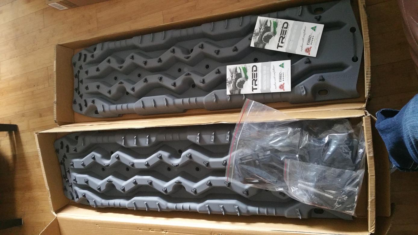

I got two sets of Gray, too, and a mounting bracket. All very well built, though I question the security of the lockable handle things. Given enough force, they are removable even when locked. Enough force that I suspect most people won't bother though, so there's that

They came in grey! Just what I always wanted [emoji317]

How did you mount onto the Gobi in that location, are you just using the longer pins or is something holding the tred mount above the mesh floor of the rack?
I too am curious on how these were mounted. Any update?
The longer side is zip tied to the mesh and short end is zip tied to one of the 2 center bars. I used the standard pins. Sorry no pix at the moment but if you position them with the mounts over that location and lift Tred vertically, you will see where you need to secure the mounts to.
