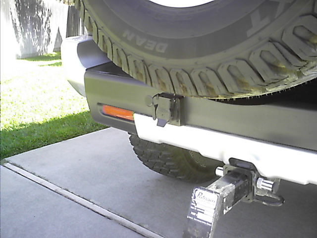

I wish the bumpers had a knockout or something for the plugs, I hate having it mounted under the hitch because it seams like I drag it and bend the bracket every time I get off road.
Maybe I will get daring and hole drill the bumper and try not to peal too much chrome off.

They are cheap and I think I'm going to get one too. The hanging wire bugs me too but I forgot until you REMINDED me.
That is sweet. but I also have the big round one. I found a picture of a FJ with one in the bumper and I really wish to get something like that.
