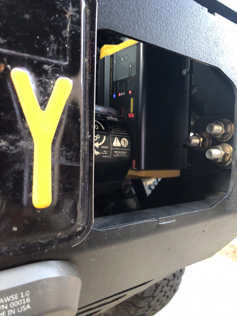

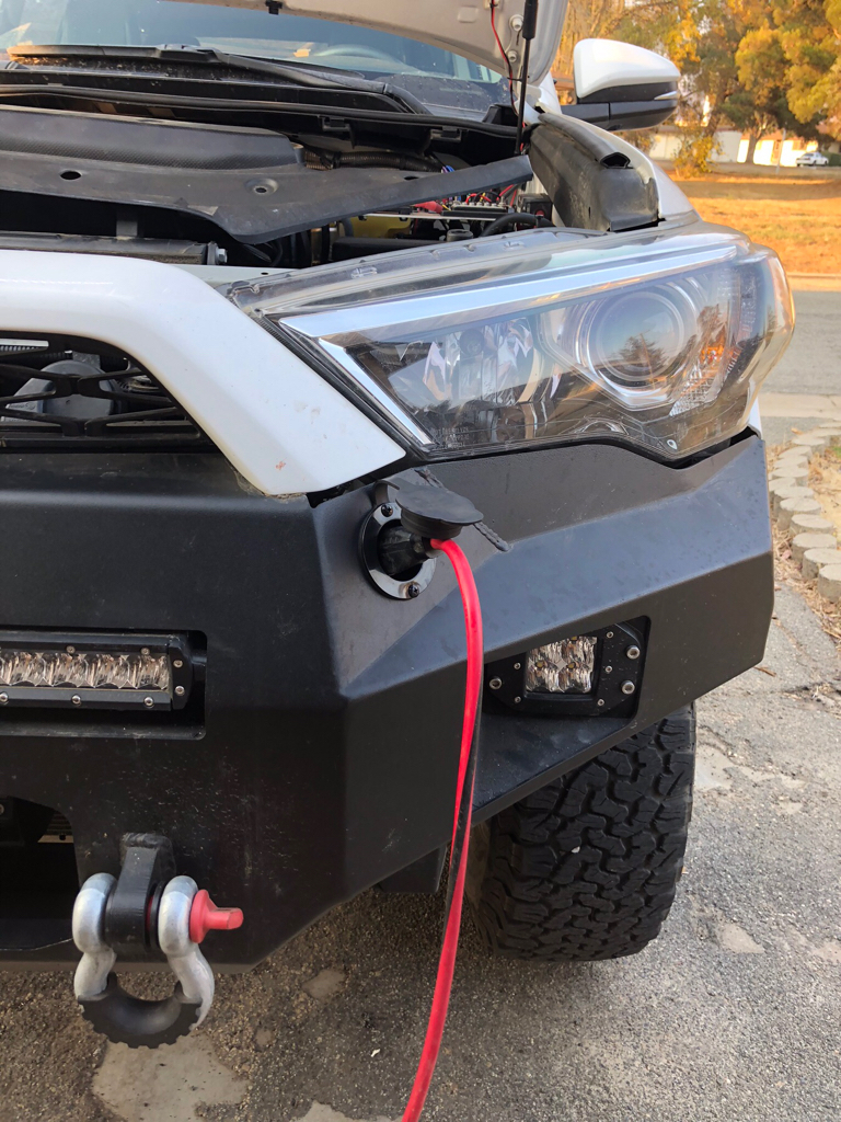

I used this one, mounted behind my front bumper. It works very well and it’s made for dual batteries. It’s designed to charge the start battery first. The battery charger is going to work independently of anything else, so it won’t be an issue.
ProMariner Multi 43008 Battery Charger Prosport 8 Amp https://www.amazon.com/dp/B00F5EBQ36/ref=cm_sw_r_cp_tai_EVyNCbJAA2F07
