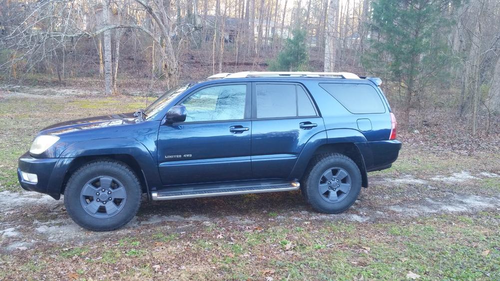

I just painted my 04's wheels Gunmetal Gray with Plastidip. I thought it turned out well also.
