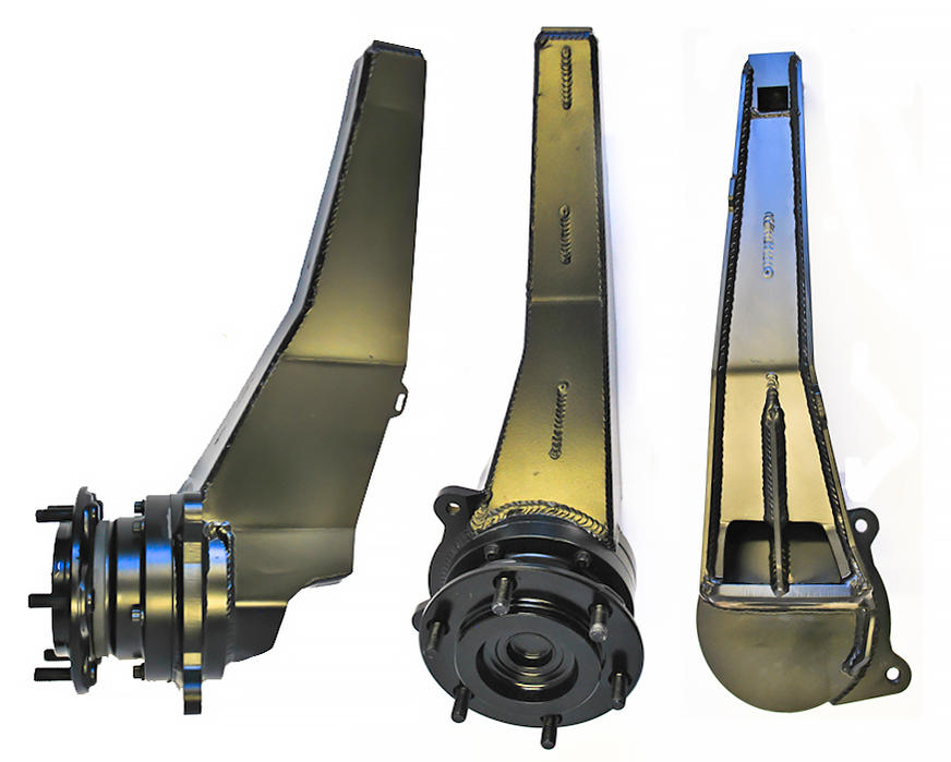

Good to know. Looked at Dirt King - looks similar to Total Chaos and Camburg. Still adds 7" to stock width, which is too much for trails.
4600 rules allow 1" body lift, fiberglass fenders, or trimming of the fenders to within 2" beyond the tire height at full compression.
Agreed completely on the Gusseted Spindles - not many of the kits have these. Is there a separate manufacturer for these?
TC has a spindle gusset kit. That's what I'm running now.

FYI Get the gusset kit that keeps the sway bar. It's more expensive but the swaybarless kit tends to crack the spindle easier. Puts all the stress on one spot.
Makes sense. Honestly wish TC was carrying these like Solo is. They seem much beefier than the gusset kit, but maybe it's just the overall look...

- RCV Ultimate IFS CV Axles
- Front Fabricated/Gusseted Spindles, Steering/Clevis, and Shock Hoop, and other Gusset/Bracing upgrades
