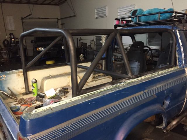

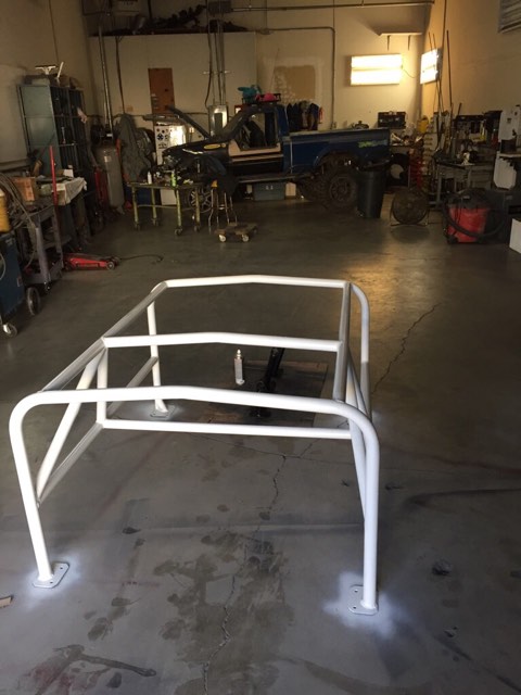

i decided the body kounts for the rear needed some attention.. and i said meh i might as well build a cage for it as well.. ImageUploadedByTapatalk1440684684.797892.jpgImageUploadedByTapatalk1440684692.386075.jpg

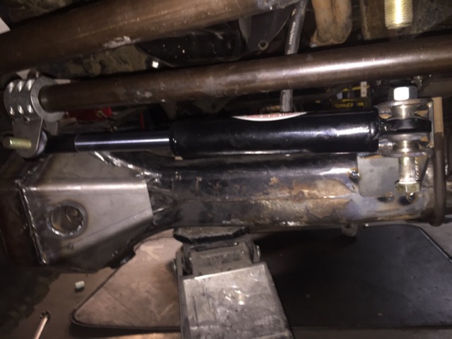

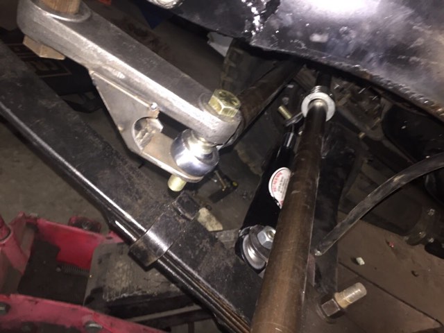

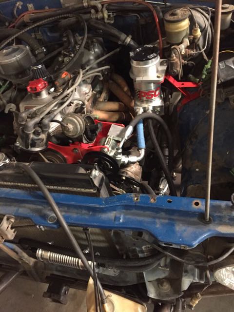

also figured the steering needed some help so im doing hydro assist from PSC..
more work the. i thought it would be but its coming out nice.. im also double sheering all the steering because i will have alot more steering..

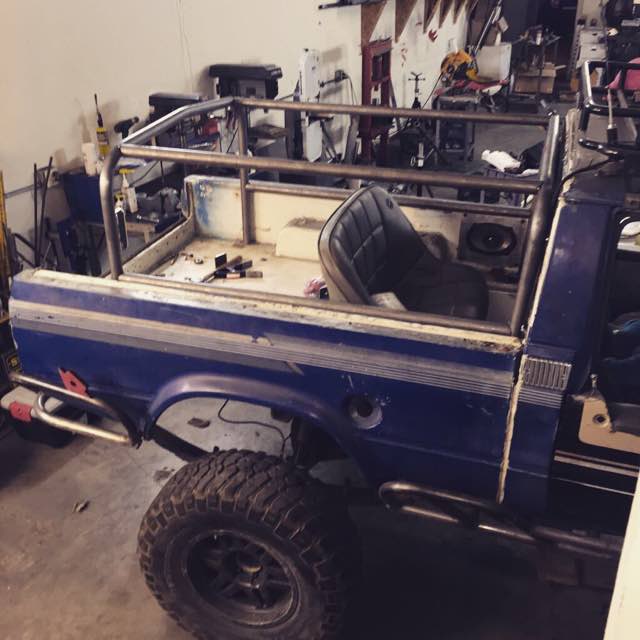

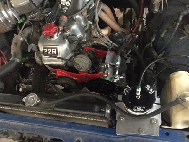

here are a couple pics of what i got done over the weekendImageUploadedByTapatalk1441045351.187707.jpgImageUploadedByTapatalk1441045359.492201.jpg

ill have some more pics.. soon i am finishing up my hydro assit/psc steering setup this week.
