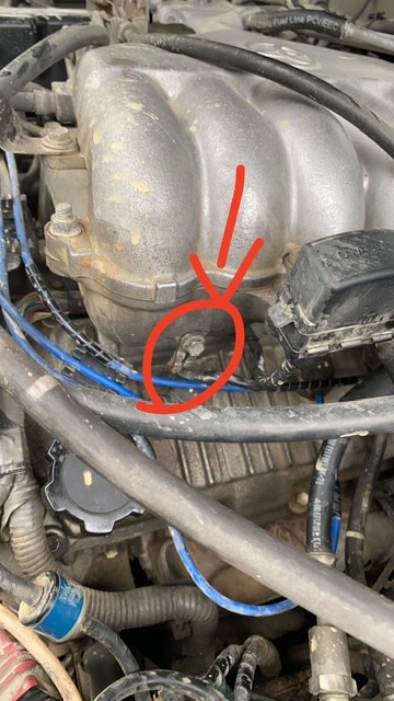

This fixed it. Must not have tightened enough and was loose.
