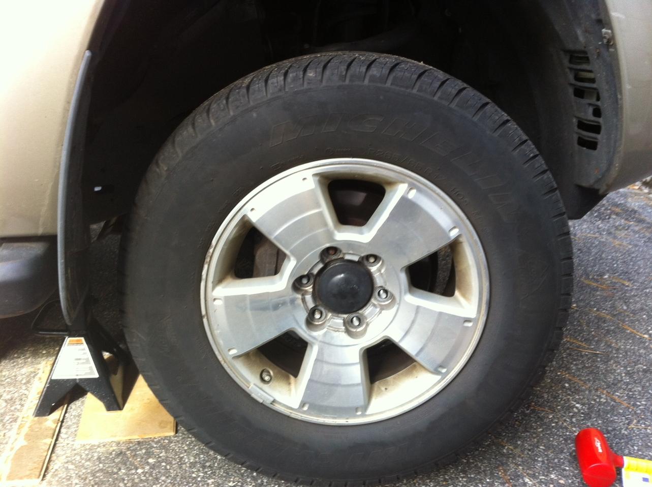

i jacked up the passenger front side, removed all the lug nuts and the center cap (with toyota logo on it). the damn tire is not coming off. i am sure it's off the ground. Am i supposed to beat the crap out of it with a 2x4 or something? i haven't removed 4Runner tires before. I wanted to check and maybe replace the brake pads, but am stuck on the basic first step :( I know it's heavy and I need some weight training, but really? I am not the weakest either.
I don't suppose I need to get the center black round cover off? Is that dust cover or something, not part of the hub is it?
I did try the driver side front, same thing. please advise. thx

Between wheel and hub there is a space for large screwdriver to fit. You can pry that wheel off by going around those notches.
Sometimes they get stuck on there because of dirt, etc. It doesn't look off the ground in the picture but if you are sure it is try hitting it or wiggling it and it should come off no problem.
Also, you do not need to remove the center cap.
Just so I don't regret saying it, if you are planning on doing suspension work and cannot get the wheel off you may need to pay a professional.
I would try lowering the truck with the lugnuts off. The weight of the truck might shear off the binding.
If that doesn't work, put a couple lugnuts loosely on, lower the truck, and very slowly move back and forth, and jack it up again.

kaizer427, good catch, it was off the ground when i attempted to remove tires, i only lowered it down when i took the pic

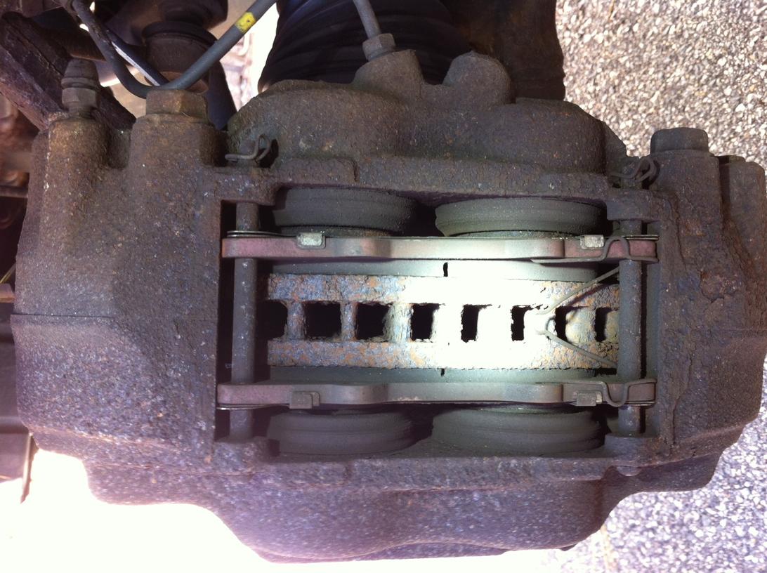

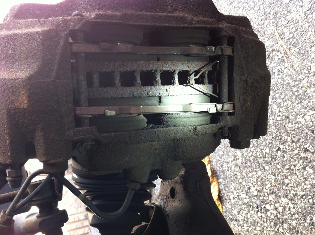

i inspected my brake pads, didn't take them out of calipers. i thought they looked okay, with about 90,000 highway miles on. it's my 2nd toyota set of brake pads. 1st being the one from factory. i couldn't get a good look to know if any of the pistons seized ( a problem many members here reported ). the inside pads seem to wear less than the outside ones. pictures attached.
i feel they can go another year. i am usually light on brakes.
when i put the lug nuts back on, i used the tire iron supplied by Toyota. it's not that long. maybe a foot. i didn't want to mess up with a torque wrench ( got one but little experience in using it and it's really big) so i just threaded all the lug nuts back in tight till with some of my weight on the supplied tire iron. i heard squeaks last turn or so on each, i hope that's normal and i am not over-tightening them.

Between torn/leaking CV boots and seized brake calipers, my wheels don't stand a chance of getting froze on. I bet I have the wheels off at least once every 3 months for something.
Just noticed your picture. If I didn't know better I would say the top pic looks like the classic frozen caliper. Could just be the angle of the shot though.
