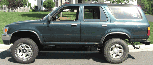

I replaced the springs with MOOG as recommended by an online store. I wish they had just a little more lift. Here's an after picture.
