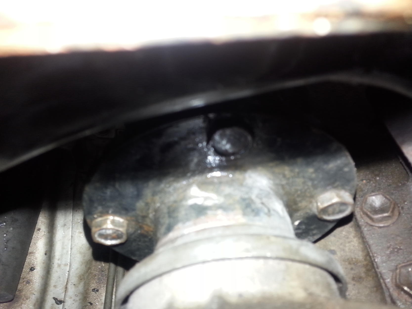

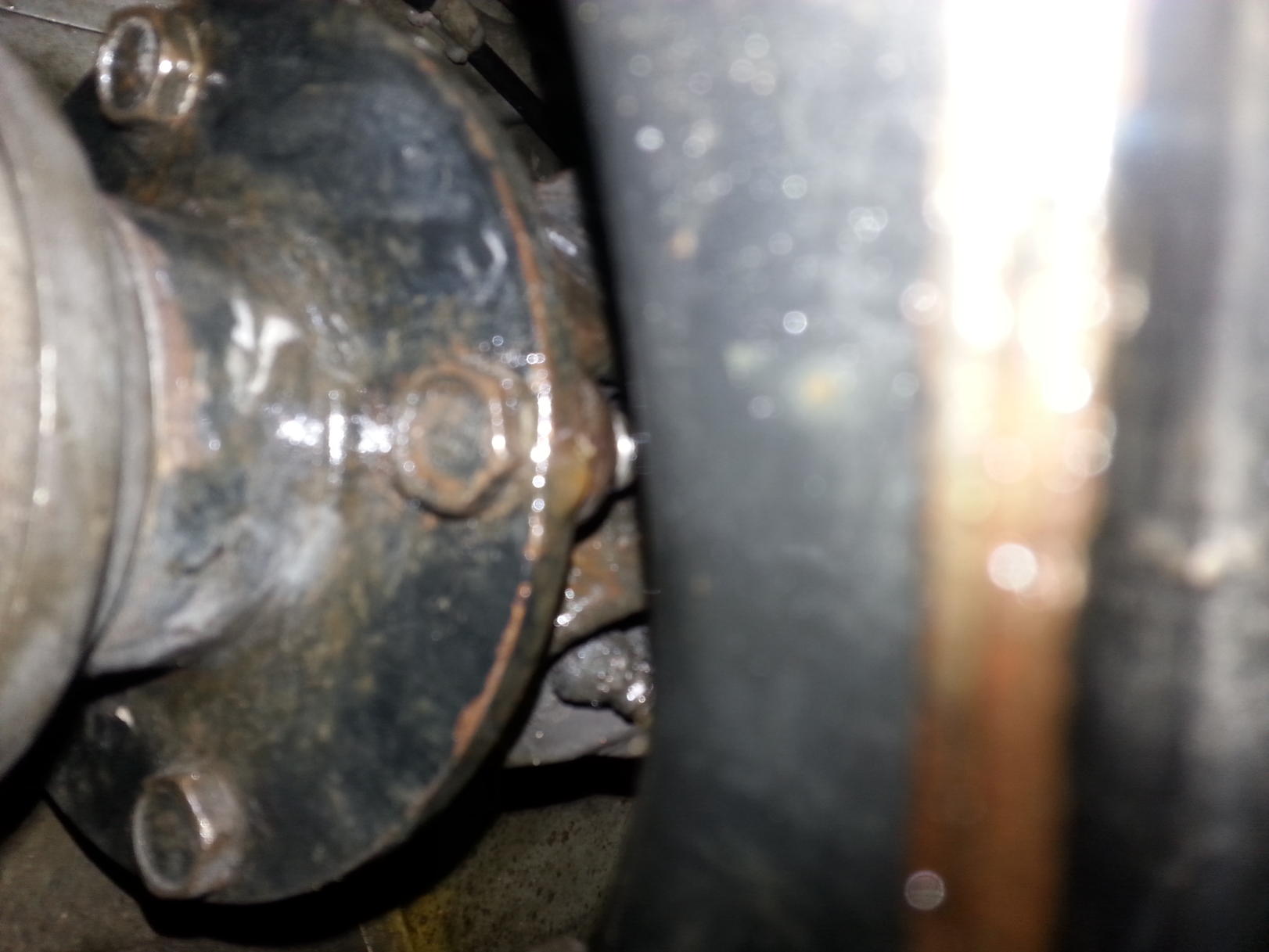

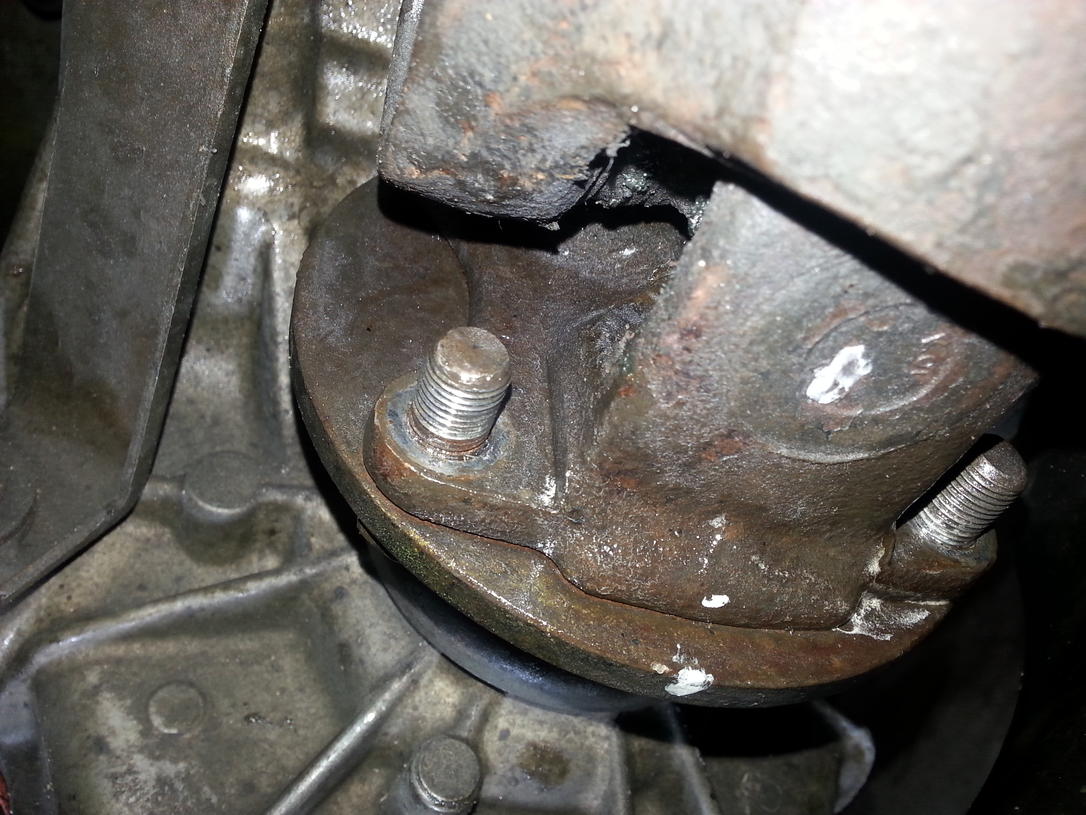

There are bolt heads in the back, but they are small. So, they might be studs or might just be there so you can hold the bolt in place while you tighten the nut.
Pics :) (edit, holy batman sorry for the large pics lol)

It's just bolts. Use a brass hammer and knock them loose or put the nut part of the way back on and knock them out. I have had the drive shaft feel like its still bolted up when its not. Sometimes it just takes a very hard hit to get them free.
Yup, those are bolts. They're just frozen in place from years and years of exposure to wet and salt and such. Get to smackin'.
