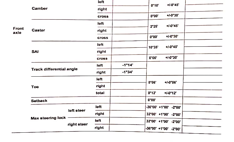

finally was able to dig this up.
Hz5rbTB
Does anyone know if the alignment computers save the vehicle info for
awhile and he could still go ask for a print out?
OP, the alignment shop should have given you a printout of the before
measurements and the after adjustment measurements. I'm thinking it may save them for a bit.
