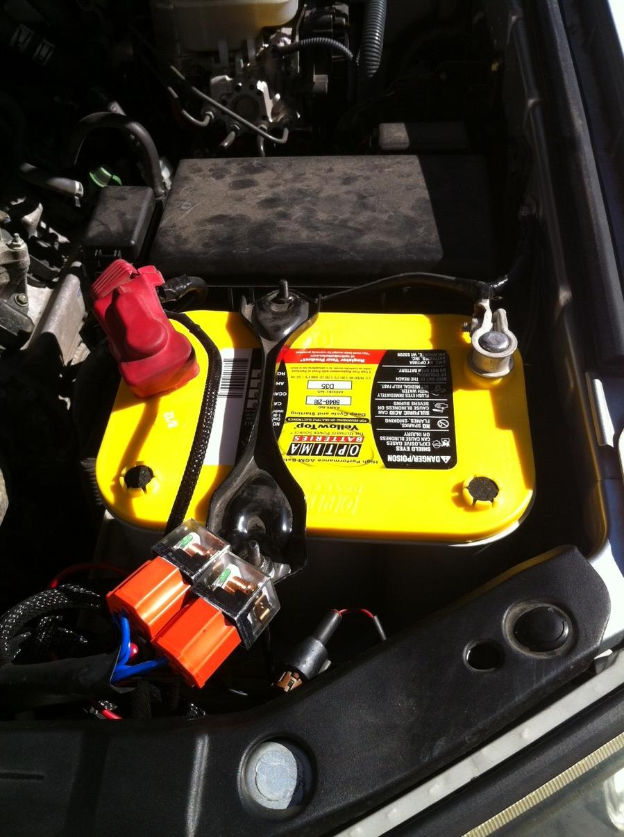

I just had to replace my OEM Panasonic battery (can't believe it lasted 112k miles) and went with an Optima Yellow Top. Found it on Amazon for $75 cheaper than the local parts store. Fitment is perfect although you do have to use the little plastic spacer that comes with it (snaps on the bottom of the battery). I would highly recommend it.
Optima Batteries 8040-218 D35 YellowTop Dual Purpose Battery : Amazon.com : Automotive

But the terminals would be on the still be in the wrong place? Red (+) would be close to the fender. The leads would need to cross, that is not recomended.

guys, I just installed an Optima Yellow Top and just turned it around to match the terminals. I don't understand what everyone is talking about "crossing wires" and what not. Look at the picture I posted. The "Optima" lettering is upside down, therefore putting the + and - terminals in the correct position.

Krup, your battery is correct. They are saying some will have the + terminal closest to the fender. If you were to flip that around that would put the terminals closer to the headlight and the factory cable wouldn't reach that far.
