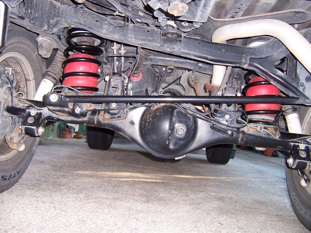

Don't have the x or the FJ coils but did add the OME coils to the back and kept the RT spacer on top. Like 6-7 inches over stock in the back. Love it. Kept the air bag but need to add a new bump stop - had to cut them down when I added them with the stock springs. Just want to use the air bags as a bump stop.

Cool set up Colemanfu.
My main question is whether the 1" longer springs will damage the XREAS. It appears as though it may be OK.
The air bags you installed were from a relatively affordable kit, correct? They look like theyre holding up OK- any regrets? Id like to keep the rear level when towing, so if your kit works well I may go that route.
