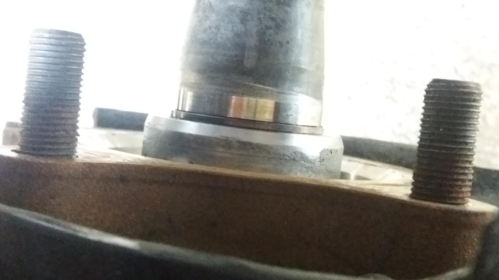

Well, it's 70 and sunny in Cincinnati today, so getting it done. First layer in the groove. I'll sand it smooth after it cures, just leaving the epoxy in the groove. Hopefully that's all I'll need.

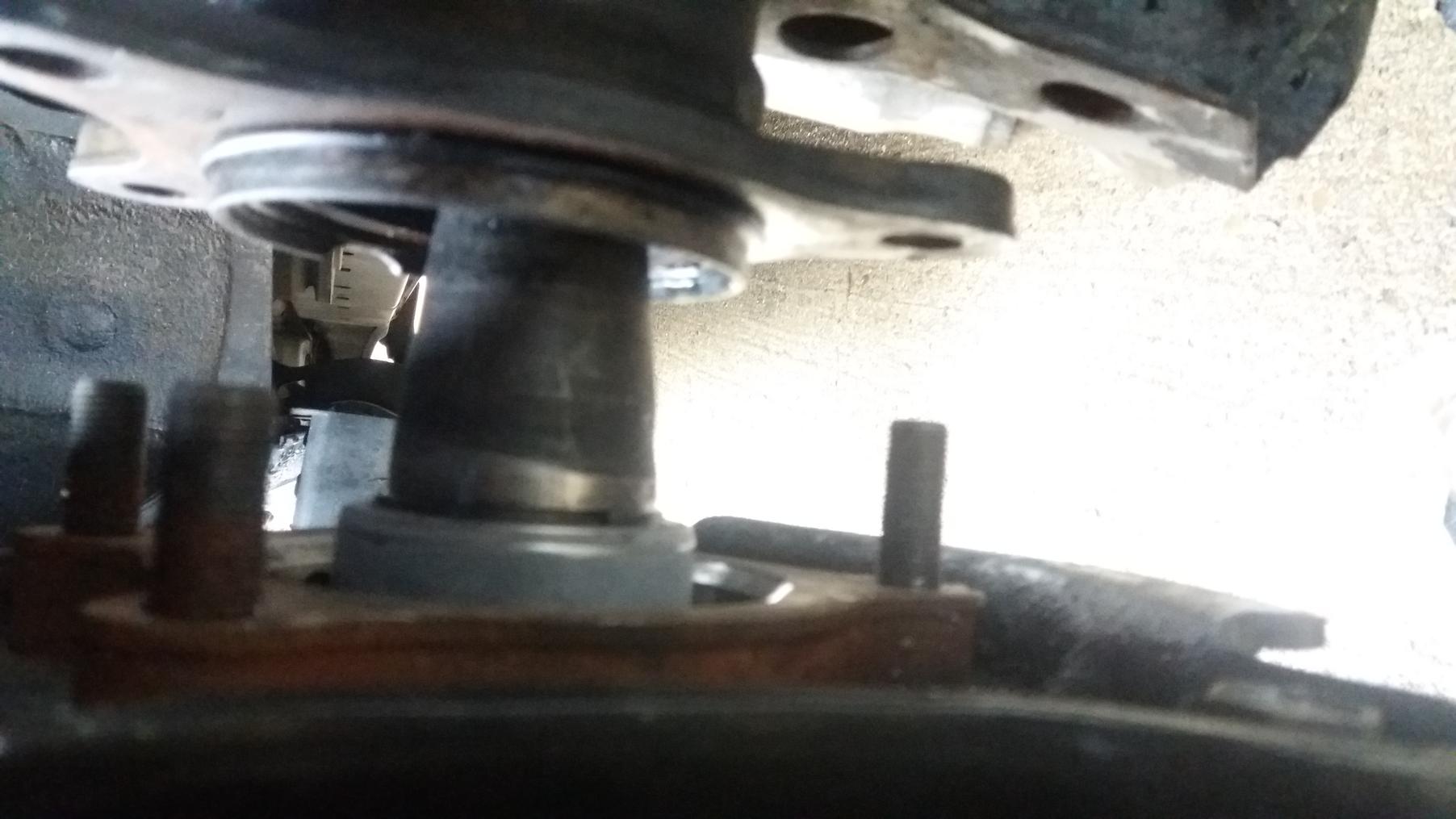

Going to put a skim coat and give some meat for the epoxy to hold onto. With just the tiny groove, it just doesn't seem like it'll hold.

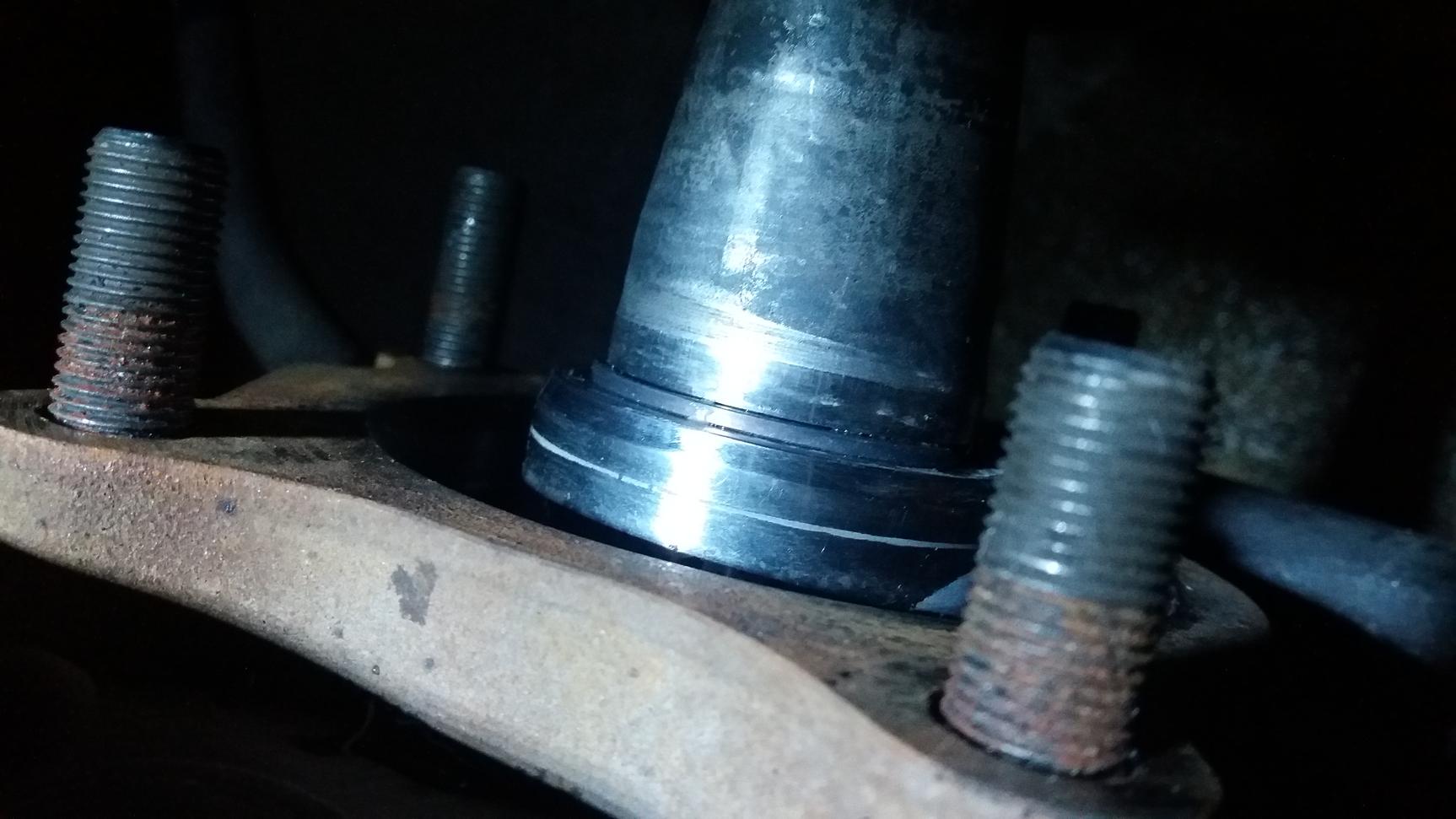

The skim coat all smoothed out is working so far. I'm not super-confident on it lasting 6 months, but is fine to tide me over for now.
