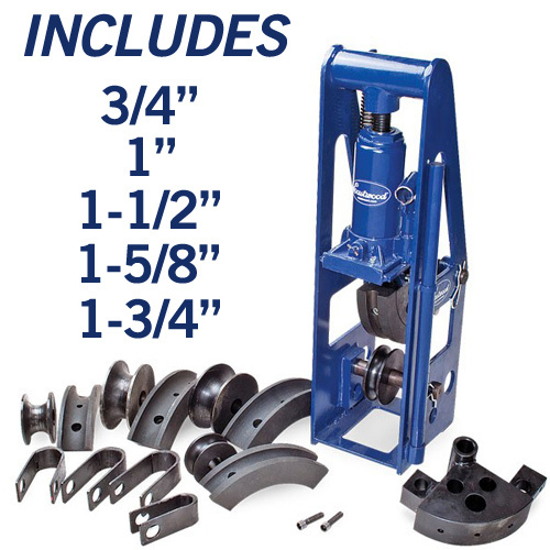

I'm wanting to start a few projects I have in mind but need something that will bend 1.75" tube. What should I look for on a $300 budget? I'm thinking something like this.

im looking for a used jd2 my self, does the bender you show in the pic come with all the dies? and whats the thickest wall you can bend with it?
That one I posted sucks!! I thought it was decent until I read all the things it CAN'T do.
