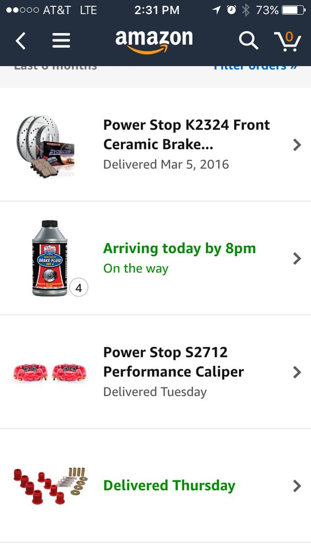

Got mine on Amazon without a core charge, actually bought all of it (remaned calipers, rotors and pads) from amazon for around 300.
Way cheaper than anywhere else I have seen.
Can you post a copy of your cart? Looking at doing this on my '01
In going to try to get it all on next weekend, I am doing the lca bushings at the same time. I'll post it in my build thread, so keep your eyes peeled.
