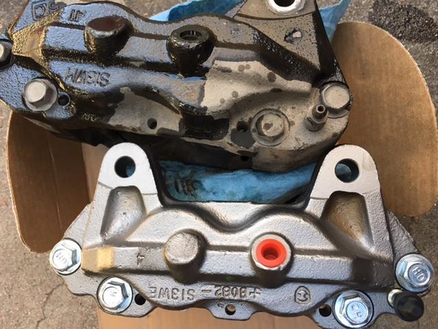

I finally got around to installing my 199mm TBU today, except I'm stuck...
1.) The brake pads I got are apparently for the 231mm calipers and not these ones because they won't fit. Akebono ACT976 ProACT Ultra-Premium Ceramic Brake Pad Set are what I bought per a few recommendations in threads, but they don't fit in the calipers, so I'm guessing I got that wrong.
My old pads are actually looking plenty thick still though so I'm wondering if I can just reuse those? They fit into the caliper too, so do I just sand down the brake faces a bit and I should be good to go?
2.) The caliper looks to be the same damn size as the one I just pulled off. The numbers are different though so maybe they're just wider to accommodate the thicker rotor? I can't tell though, but I want to double check before throwing them on there.
Patiently waiting for help while my brake line is capped off. =)

Looks to me you just replaced a stock 4runner caliper with another stock caliper. The Tundra 231 and 199's are distinctively different than stock. They are much longer. This is why your dust shield needs to be trimmed.

Looks can be deceiving. The 13we caliper definitely has a wider slot for the rotor compared to the one I just pulled off.

EDIT: Yes looks can be deceiving. From the pic they looked exactly the same to me. I was expecting to see the piston wider apart in the caliper.

So, the pads appear to be the same. I put it all back together with the old pads, and while the bleed seemed to take more cycles than I remember, it all works again.
