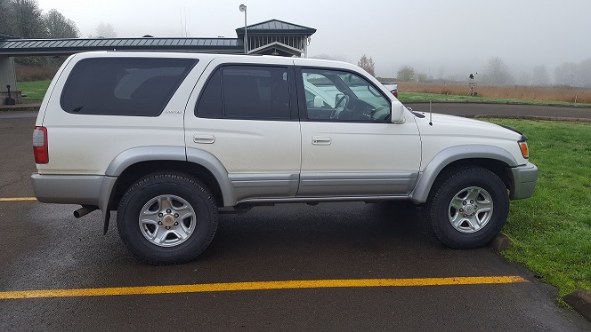

I think what you might have missed in the discussion of the Limited wheels not being compatible with 231s is that it's the 3-split-spoke Limited wheels. Those aren't the same wheels as yours. Glad it worked for you!
Certainly did...sorry to get your hopes up
