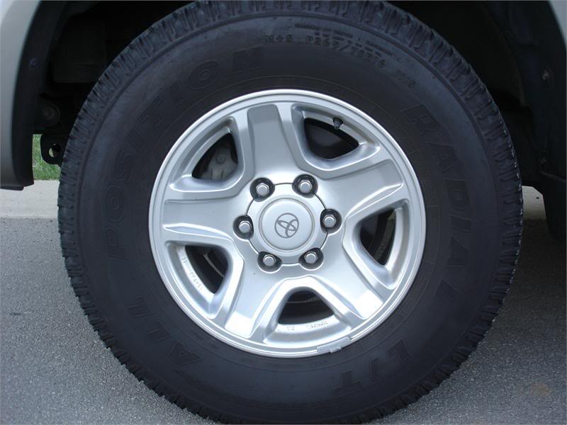

I have the '01 5-spoke wheels, will they clear the 231mm's?

Personally, I would look for a set of nice 16" 99-02 wheels. Usually see some pretty decent deals on craigslist (and a lot of them have a good amount of tread left). Or you could go for the Tundra/Sequoia 17" wheels, which look pretty bad a$$ IMO. I suppose your 'runner is more of a kiddy-hauler than anything, though, so you're probably not interested in that sort of thing.
