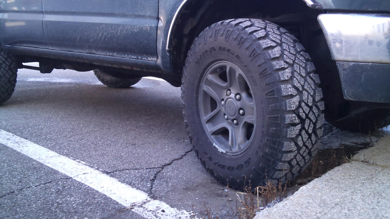

Has anyone done the combination with the stock limited 5 spoke rims and had to grind them for the 231's?? (pic included of my wheels)
Is there really any difference (other than the increased heatsink ability ) from the 199 to 231's? (There is something to be said about being able to use the 6 spokes that came with the truck as spares.)

PS so far i like these new tires and rims .. but no real snow to test them in yet. I decided to go with the Goodyears after all my reasearch pointed to the bfg's being the best tire because.... they just looked better..lol...and had sipes.
The 5-spokes should clear the 231's and the 199's, no grinding needed.
