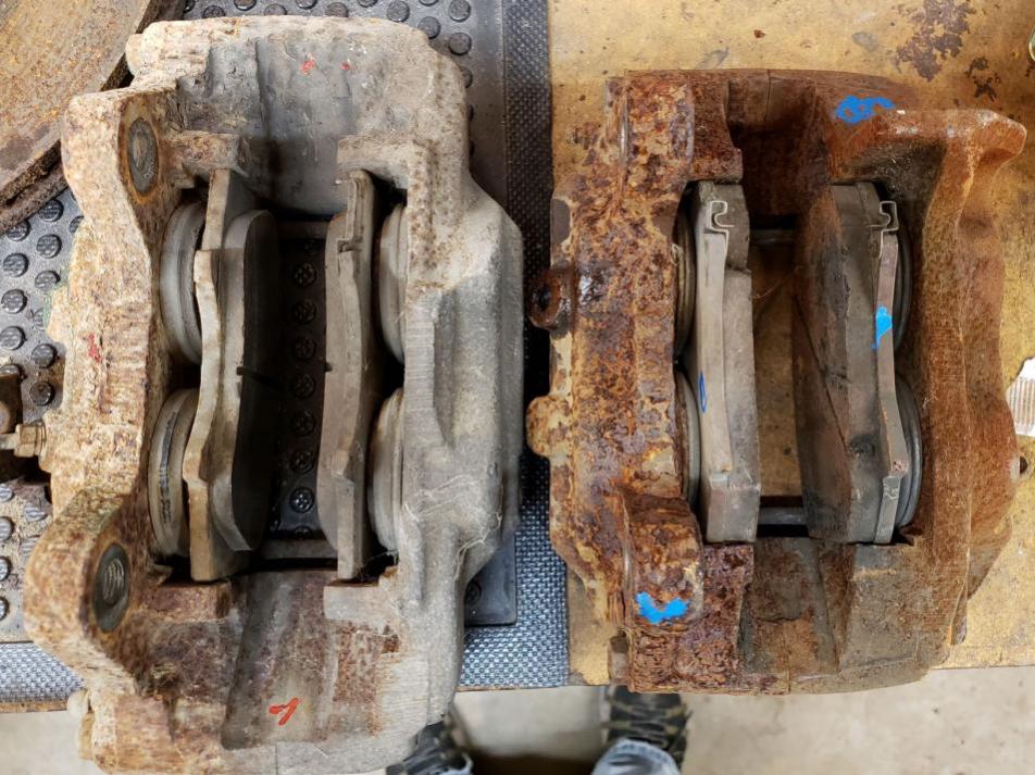

This explains it quite well for me. This photo solves it for my confusion. The extra space is for heat dissipation the 231 mm moved the pistons to the edge of the pad edge. This would help with the heat along with slightly higher clamp force as the piston force is right on the edge of both pad edges. On the 199mm caliper the pistons are closer together. Thus the piston clamp is centralized on the smaller 199mm one.
Thanks to all those who helped clear this up for me.
