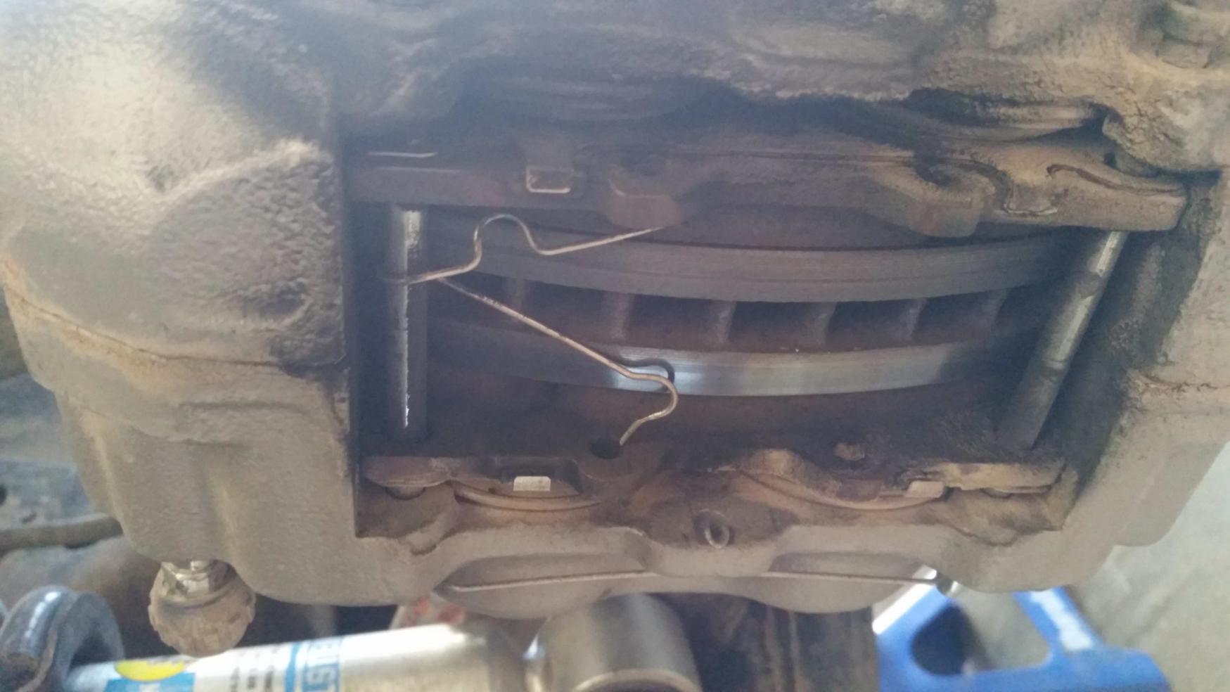

Morning!
I did the tundra brake upgrade using the 199mm/13WE pads/rotors. just noticed that the clip on my driver side didn't look right. pulled the other tire and it looked the same. not sure what the "spring" is called or the part number. can anyone help?
if you look at this video at about 1:15 the guy is removing what I'm referring to. https://www.youtube.com/watch?v=0qS1EaoQQhY&feature=youtu.be
here's a picture of what it looked like when I found mine:

Morning!
Check out the video at 11.59 mark. the guy puts the spring in correctly.
https://www.youtube.com/watch?v=sYNTePbJilo&feature=youtu.be
thanks. the video i posted showed it as well. just need to know what the part number is.
looks like 47748A or some more modernized variant of it. i'm still using
Code:
http://japan-parts.eu/toyota/us/1999/4runner/vzn185l-gkmgka/3_671460_007_/powertrain-chassis/4705_front-disc-brake-caliper-dust-cover
for lookups, but they show the old-style PN. go through the filter to specify your model-year and frame code, or use your VIN. not for this part, but i've often found that if you plug in the old-style PN into amazon, you'll get results that show the full two-part PN that toyota switched to.
another edit: 47748-35010 found on
Code:
https://parts.toyota.com/p/Toyota_1999_4Runner-SR-5-34L-MT/Disc-Brake-Anti-Rattle-Clip-Front/63130831/4774835010.html
