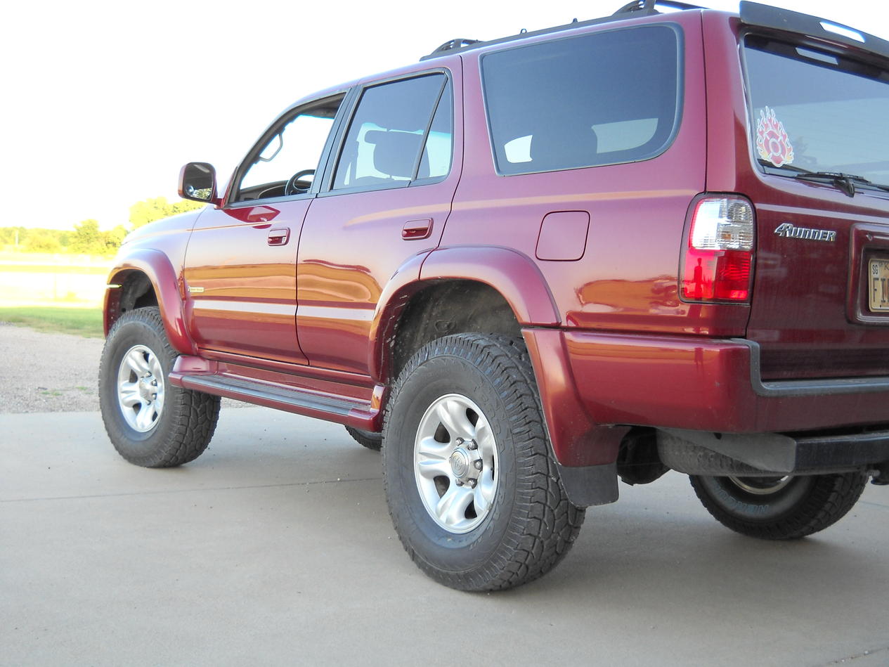

13WL fits under the 16" stock wheels but only just barely. No rubbing or anything though. The wheels look like this (not my truck but example of wheel design).
That is the perfect balance of height + maintaining stock.
