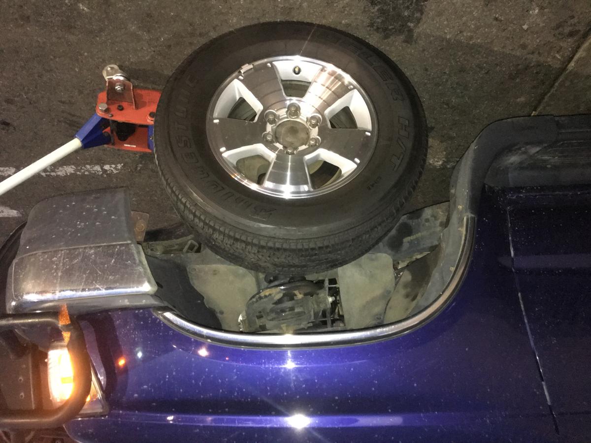

I know the comment of any 17 inch rim will work was posted I just want to make double sure before I lay down the cash on the parts.
Anyone have experience with these newer Tacoma rims and if they work.
That's on my 4R now.
Thanks in advance.
It will work but from previous experience the 4Runner operates better when you flip it around. #howubdrivinondaceiling

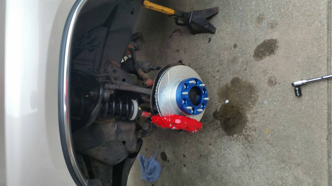

I run the 231mm wl calipers from amazon. Its was 275 for the whole shebang. Use pb blaster on brake line fittings, a flare wrench for brske lines, vicegrip the rubber brake hose, be prepared with a cutoff wheel for the dust shields. I ordered spacers 1.25 inch but may grind my stock rims later.
Sent from my SM-G900P using Tapatalk
