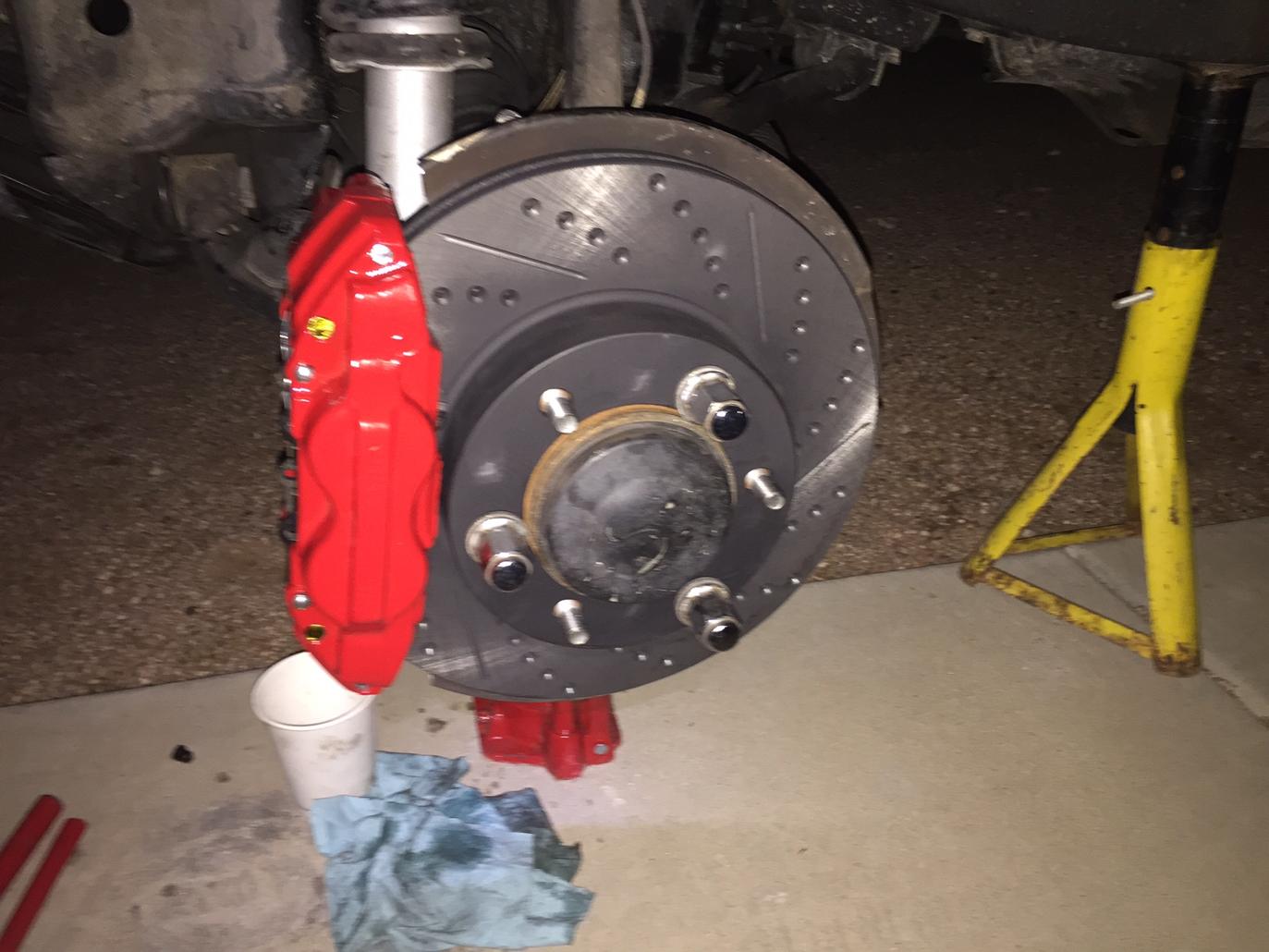

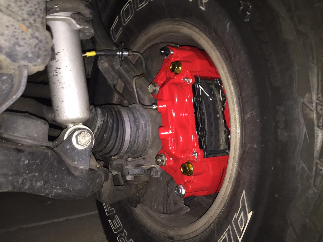

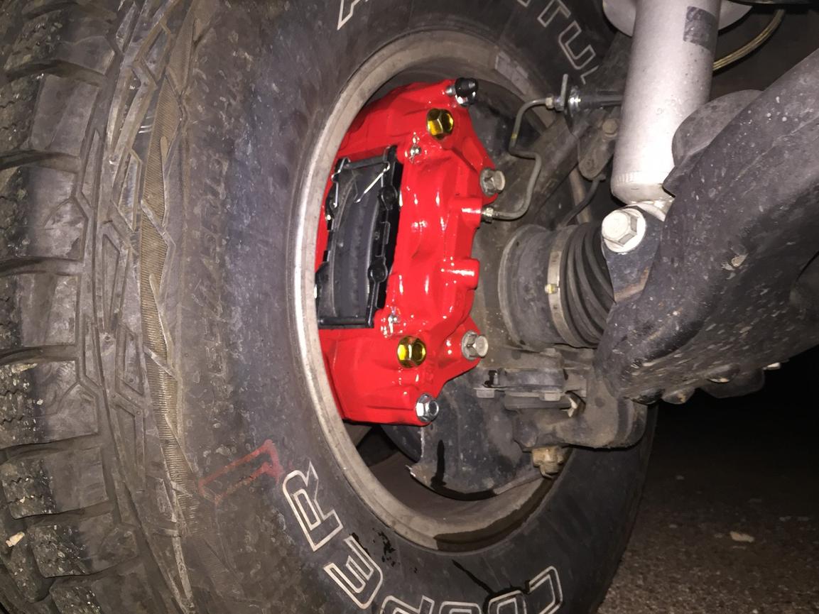

My red Tundra caliper and disc and pad upgrades. You might be able to see the dust shield modifications. A well worthy upgrade. Fun to do as well.
