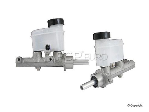

I did see where someone used a MC/BB from a T100 that helped. If you go that route, take some pics and post them.
Thanks in part to fellow member Singtoe, he showed that the Sequoia/Tundra uses a different braking lever than that found on the 4runner. Can one be swapped out for the other? That I do not know but don't think so.
Sounds like the break booster or master may be bad, no?

i have done all the right things when you do a brake job but i think it is the master or booster now gotta figure out which one!!
I agree with you. I've seen several other people mention it in the last year too. I think people are always hesitant to be critical of upgrades they do. The upgrade is STILL great and I've done it on my last 3 4runners, it is always the first thing I do. But even properly bled I've seen the same issue on multiple vehicles. These calipers require more volume of fluid from everything I've read and that can give an odd pedal feel at times. In my opinion the biggest reason for the braking upgrade is to get the thicker rotors that handle the heat better, it definitely stops better too, the tradeoff is an odd pedal feeling.
I think it can be resolved, I've looked at doing an OEM rear disc swap and once I do that (if I do) I'll definitely be upgrading the master cylinder/booster. I may take it on anyway but I don't want to do it twice. A sequoia, tundra, fj80 part should do it but I've not looked at it closely enough to know which is the most direct installation.
