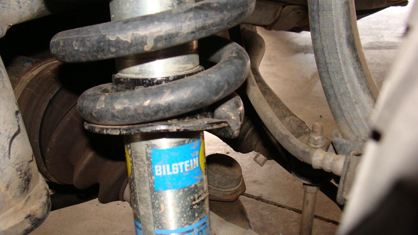

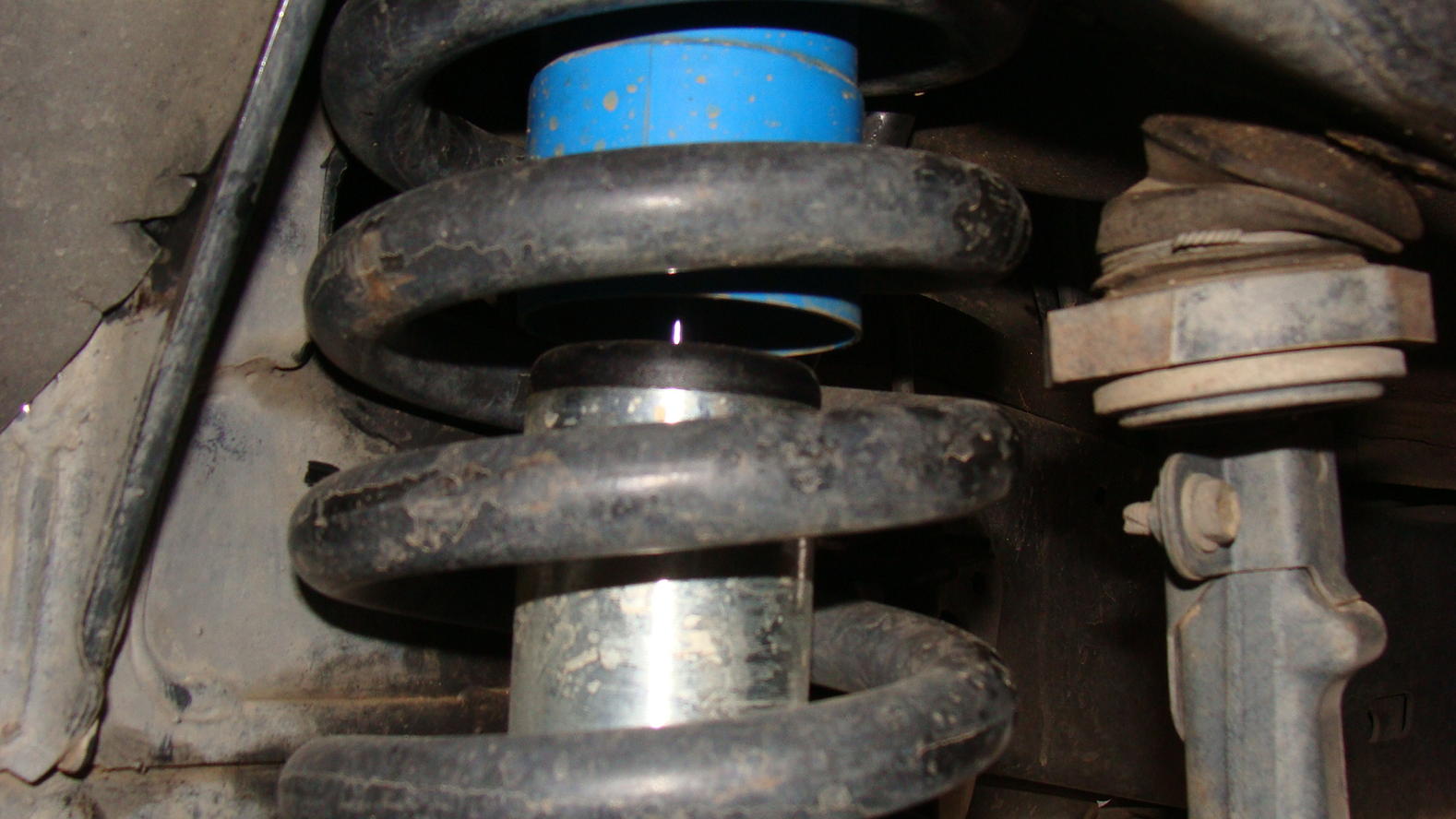

Ya what he said, I just went throught this with the same set up. You want to have the spring seat on the bottom pointing straight outboard(facing you if looking at from side of truck). This will put the gap of the coils in a spot where the top of the spindle/ball joint will clear. I did it exactly how he described. Ill post a pic in a bit if needed.
pics...
This is what it should end up as. I just removed assm, rotated 1/3 turn(next hole), fortunate for me this put the spring seat perfectly pointing outboard where it needed to be. At this point the eye for the shock bolt was way off so I just put a long screwdriver into the hole and turned to line up. Did not have to disassemble.
